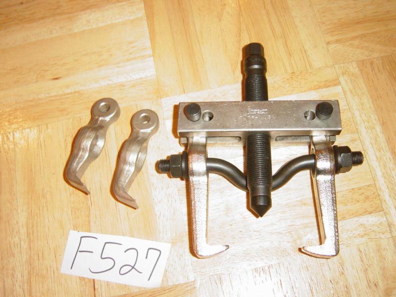

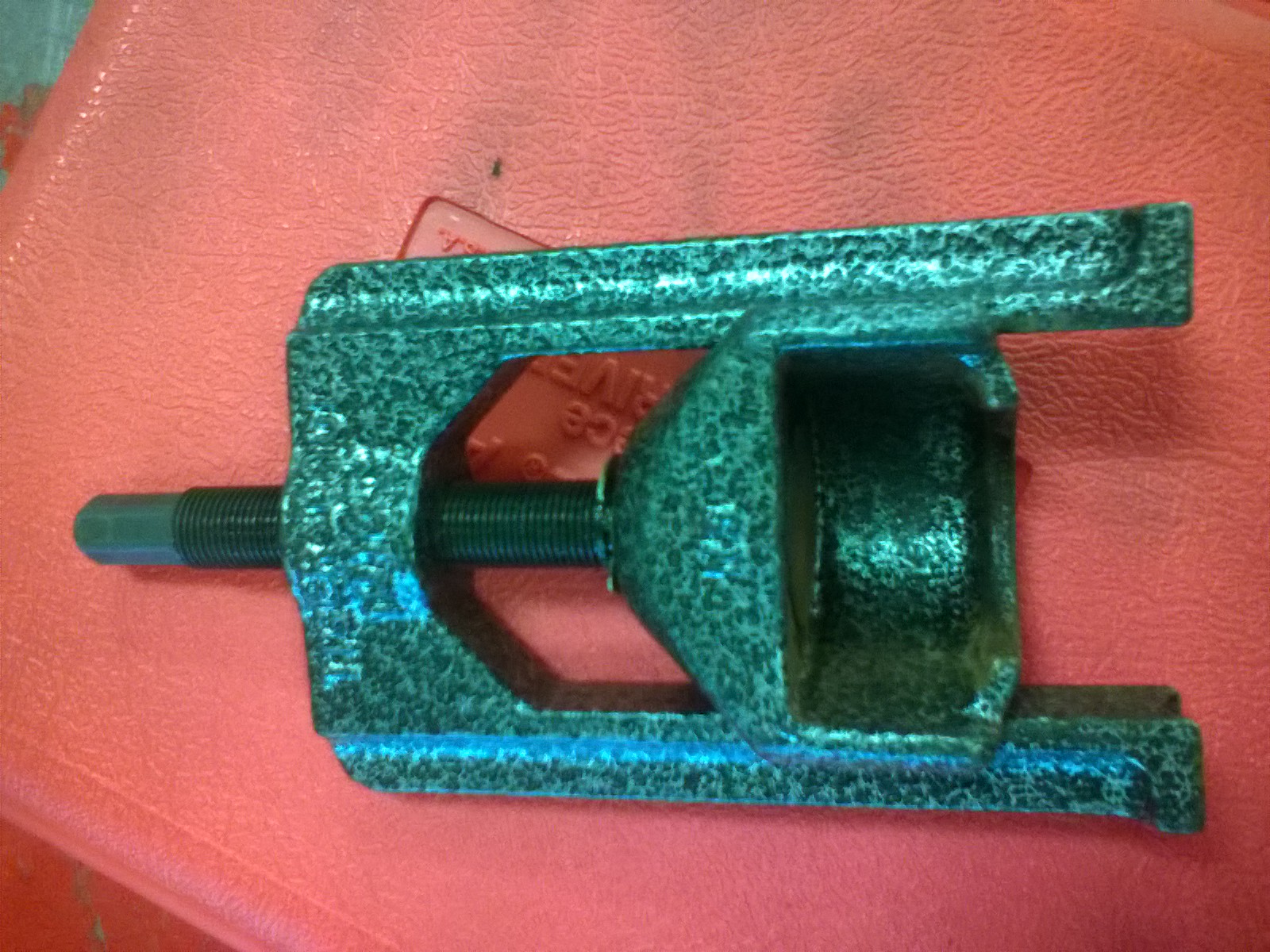

  • I used a puller on the first bearing and race ( unfortunately I didn't take pictures) But, the puller I used looked like this (Picture 1). Be careful as it can scratch the hub. It took a few attempts, repositioning the jaws on the bearing as the cage was being destroyed. Hitting the top of the puller with a hammer to relieve tension and then re-tightening.

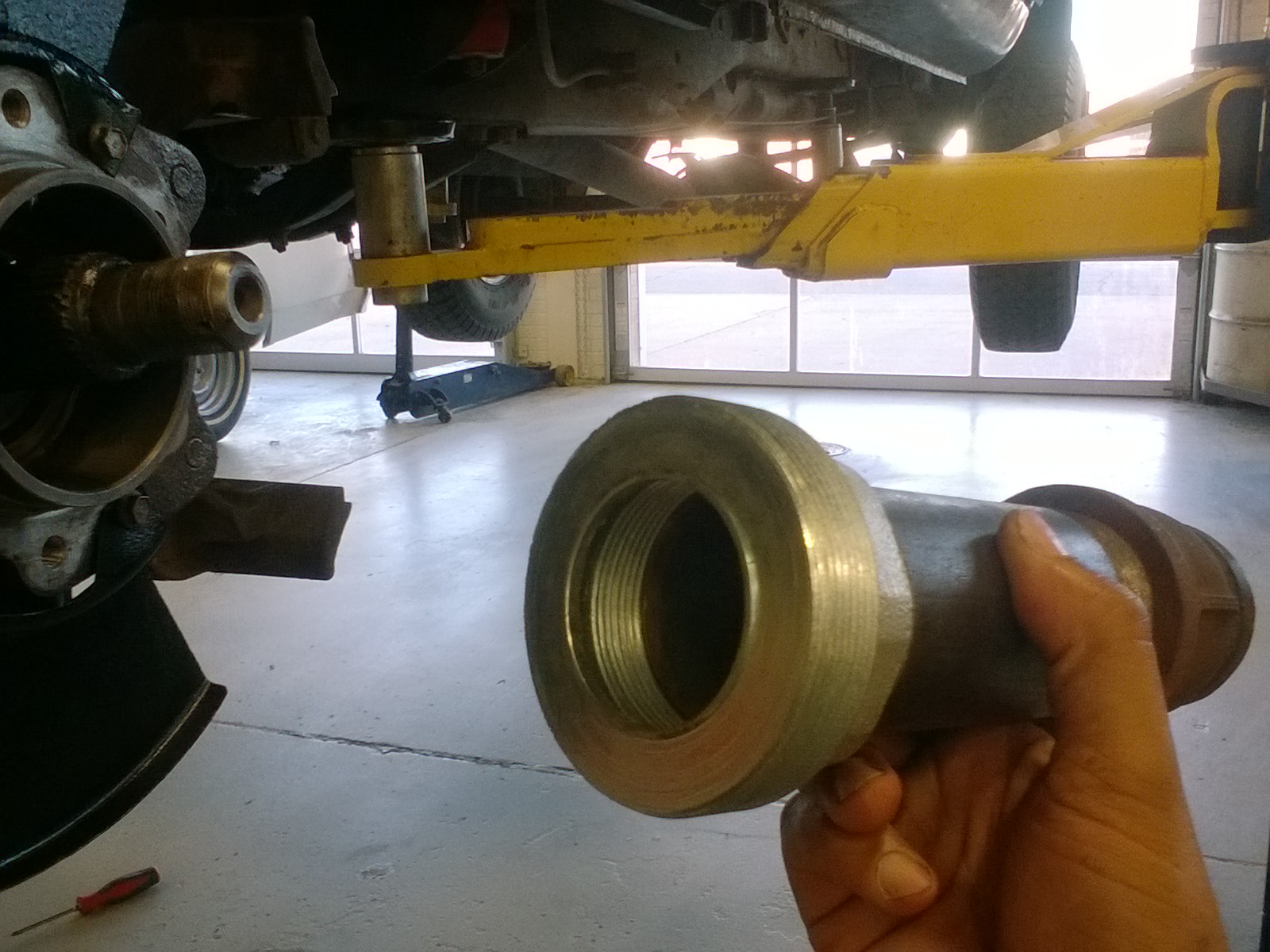

  • (Picture 2) To free the hubs from the rotors I pressed out the studs (8 in my case). I then raised the rotor so the hub could hang. At this point I recommend you remove the grease zerk from the retainer caps to prevent them from being damaged (I bent one of mine, luckily I was able to fix it).
  • I made sure the remaining bearing on the hub was aligned with the seal in the retainer cap. And then pressed on the end of the hub with a socket, pushing the bearing through the cap pulling the seal out with it.

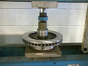

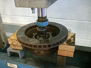

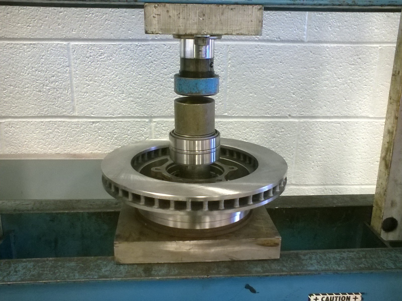

  • (Picture 3) Alright so, I place the new rotor on to the hub, but I don't installed the studs yet. I installed a new seal in the retainer cap, reinstalled the cap grease zerk and place it onto the hub. I took my new bearing set and using a pipe coupler fitting I press them onto the hub. This step is what made the whole job easier this time around. Because then you just the slide the assemble back into the knuckle and tighten the cap bolts.
Not going to lie I loved watching that press effortlessly install those bearings. Hydraulics are awesome.
  • Once the bearings are fully bottomed on the hub turn them by hand to make sure they spin. If they're stiff turning them should free them up as they should self-center.

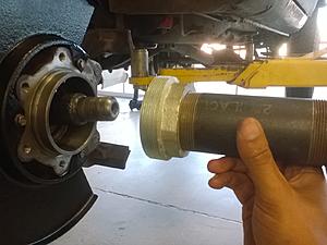

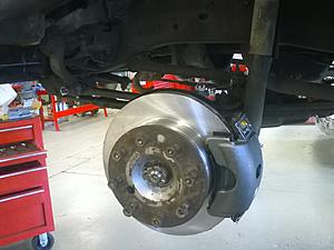

Alright the inner wheel seal
I used pipe fittings I had laying around to try to mimic the special driver shown in the video above. The only problem is that it didn't drive the seals back far enough.
When I started tightening the retainer cap bolts during reassembly the hub would bind and not spin freely, so I hit it with a hammer and it loosened up, I repeated this until I had to the bolts torqued to spec.
I didn't realized it at the time but I was pushing the inner seal back to where it needed to be.
So, if I had to do it again I would have used a punch and hammer to work the seal back further.

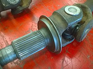

This what my first time doing ujoints and I was told these kind would be a pain.
I had a friend show me how which they had me use this awesome tool. edit: It's called a tiger tool.
I still had to use a brass drift and hammer, so I couldn't imagine what it would have been like without it.
As you can see in the picture the caps of the new u-joints protruded out. This presented a problem when I tried to slide the axles back into their tubes as the caps wouldn't clear the steering knuckle bores. I ended up having to grind the caps down. I'm not sure if this was avoidable or just the nature of old vehicles and after market parts...
Anyway, I've noticed no ill effects.

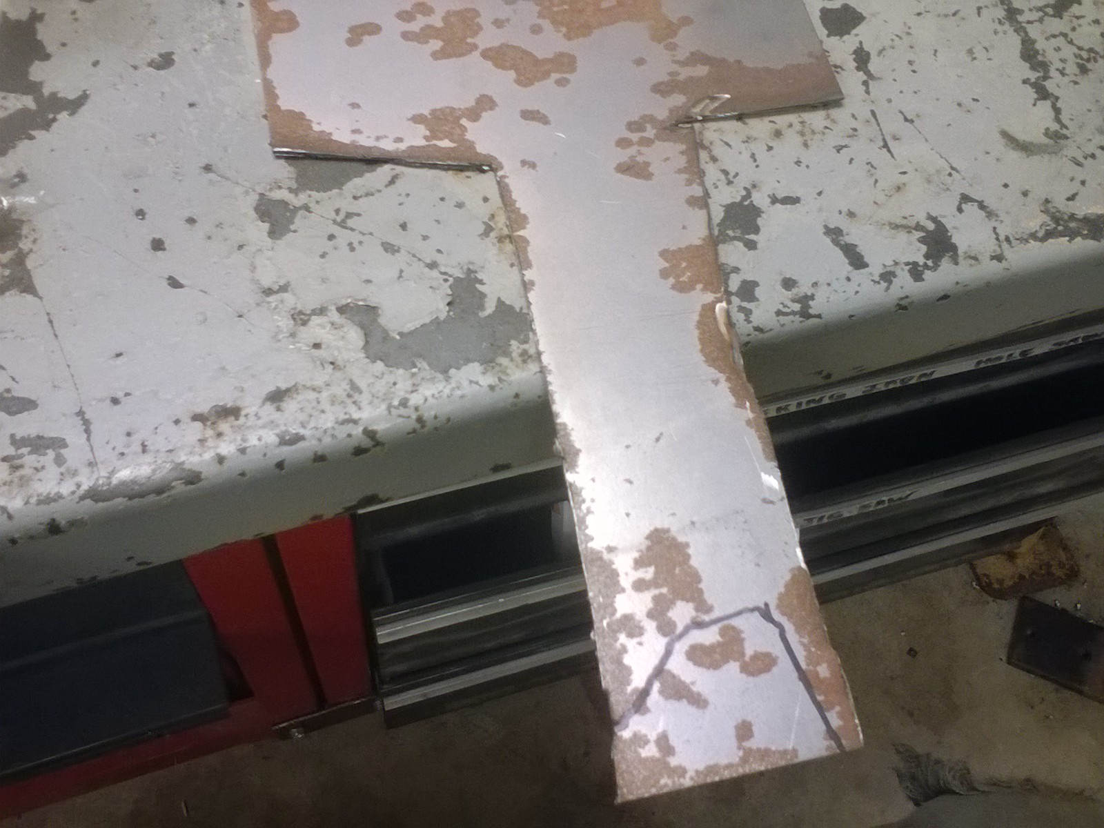

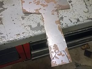

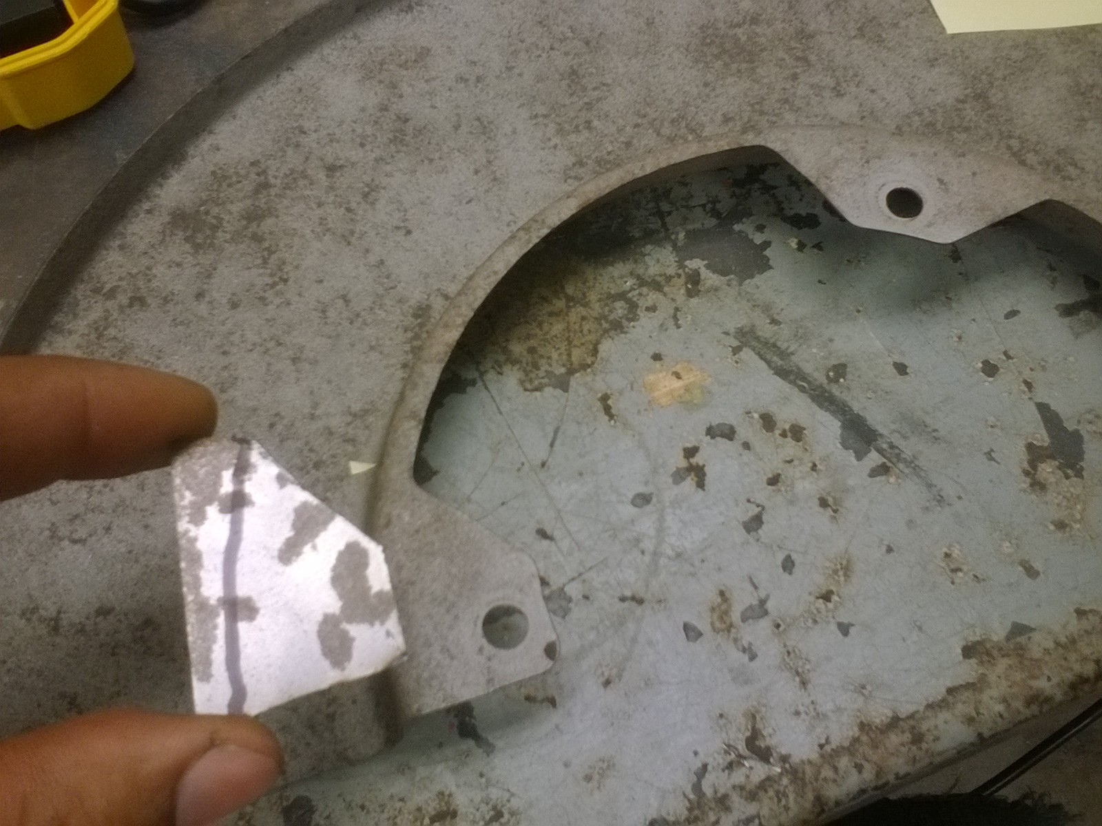

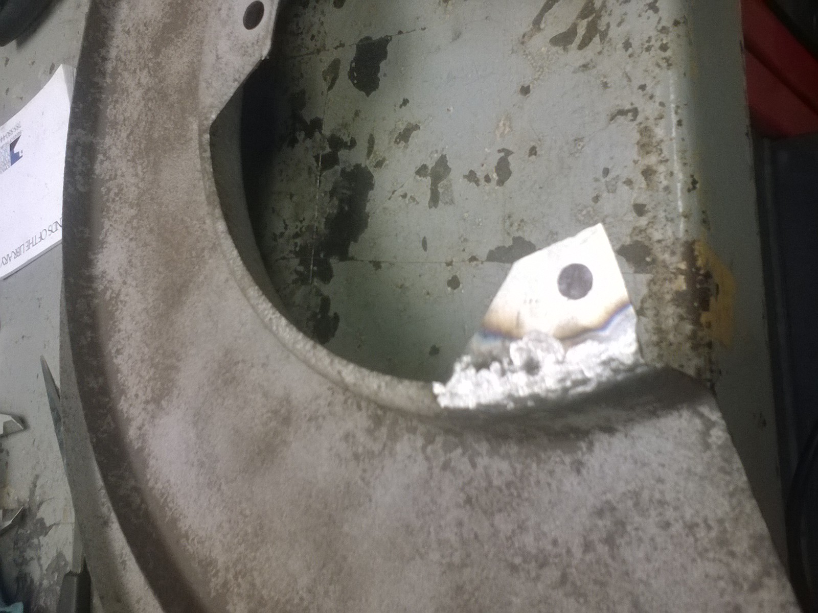

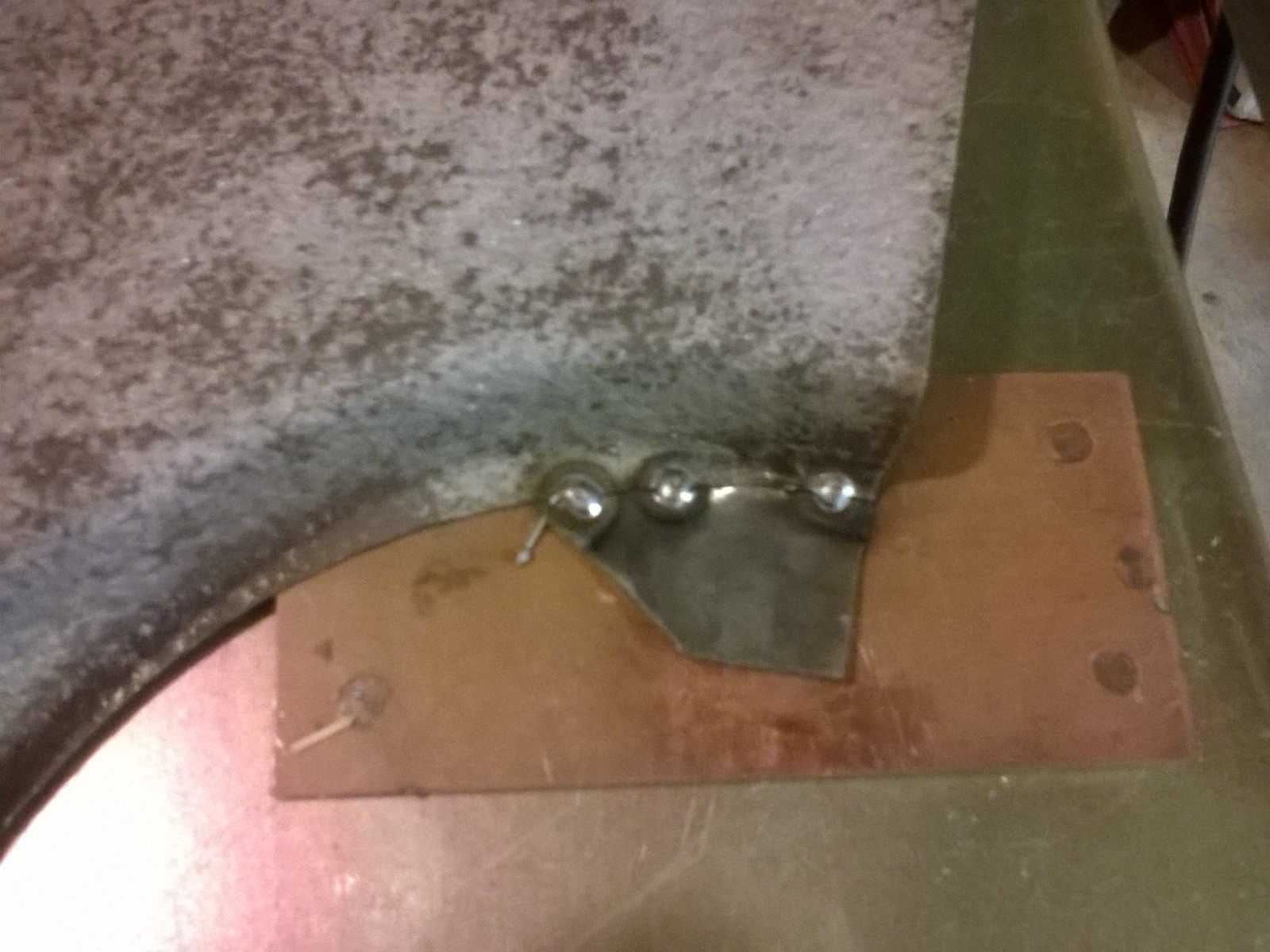

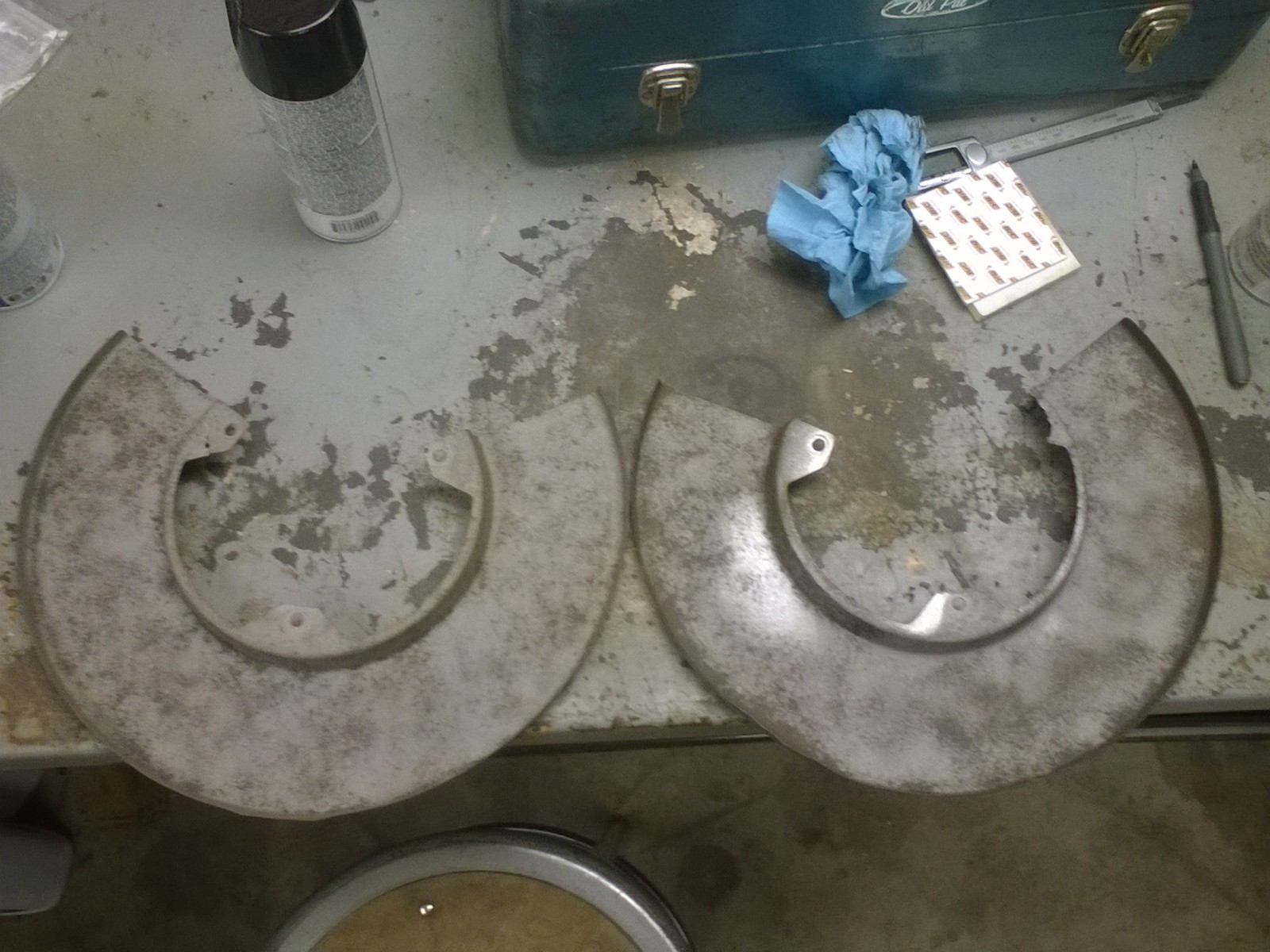

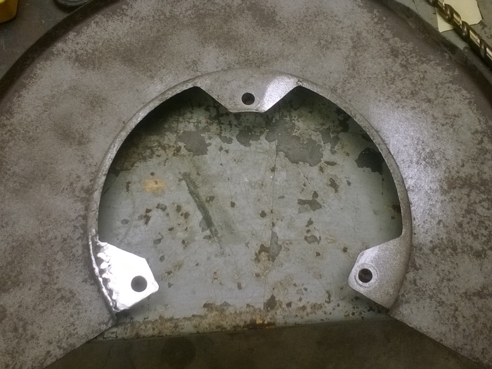

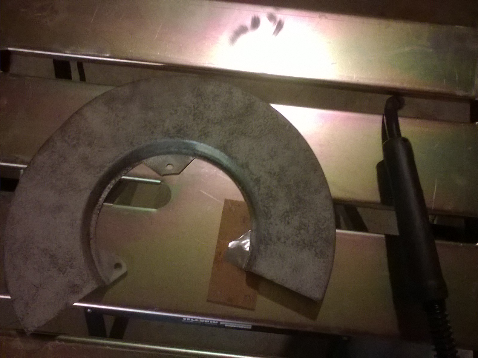

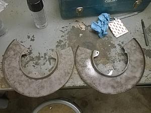

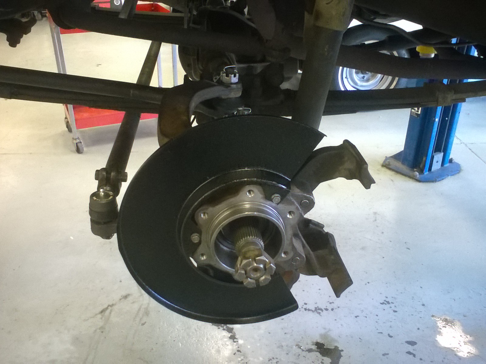

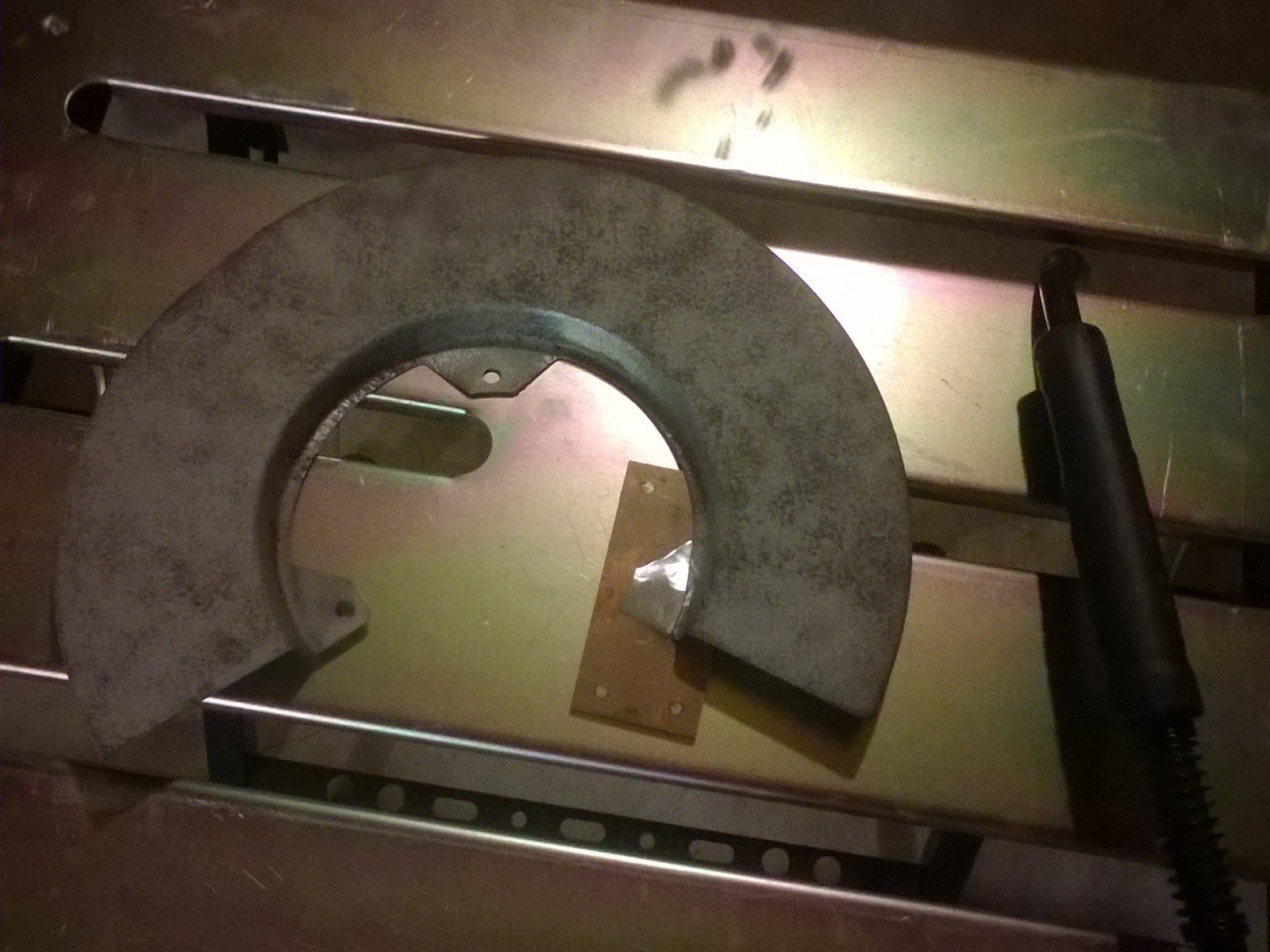

Alright, during all this I decided to do some sheet metal repair on my brake shields as they where rusty and the lower tab had rusted through on both sides of the truck.
I sandblasted them, cut out a "patch", welded and rattle paint.
Attached Thumbnails Dana 44 front hub assembly, round two-wp_20170718_19_43_45_pro.jpg   Dana 44 front hub assembly, round two-wp_20170718_19_57_02_pro.jpg   Dana 44 front hub assembly, round two-wp_20170718_20_08_08_pro.jpg   Dana 44 front hub assembly, round two-wp_20170718_20_24_55_pro.jpg   Dana 44 front hub assembly, round two-wp_20170718_20_25_02_pro.jpg
