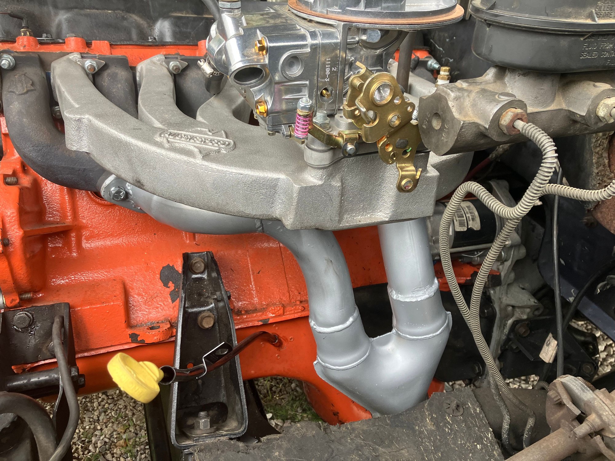

Just installed a new /6 with an Aussiespeed long runner intake and new Holley 2300 2bbl carb in my '87 D100. Sadly, the throttle linkage for the new carb is touching the end of the stock master cylinder. Has anyone out there replaced the stock master cylinder and booster assembly with a smaller, more compact aftermarket unit (such as the one from TuffStuff) ? If so, does it work, and were there any problems with the swap that I need to know ? I only need about an inch of clearance for the setup to work. Any other suggestions?

Thanks for the welcome, and comment. I couldn't agree more. I feel like there must be an easier way to deal with the problem, rather than experimentally replace the master cylinder with an unknown component. Any constructive thoughts will be appreciated. See attached pic.
Perhaps grinding that bottom piece of the throttle linkage back a bit would help?

Many thanks to all of you that have tried to help. I came up with the solution, should anyone have this similar problem. It wasn't a do-it-yourself kind of fix, and it wasn't the cheapest way either, but, it worked beautifully, and the problem is solved. Wilwood makes a compact master cylinder, p/n 260-14960-BK or P, depending on whether or not you prefer black anodized finish or polished aluminum finish, that was a perfect fit, and easy to install. It gave me almost 2" of throttle clearance, as the unit is only about 7" long. Of course, you could avoid the problem completely buying using the short runner Aussiespeed intake, or stick with the stock piece...boring, yet cheap!
Now to come up with a solution for the throttle cable bracket, and I'm back on the road. Thinking of fabricating a sort of elongated "z" type bracket that will bolt to the left rear bolt of the carb. We'll see. I'm always open for suggestions.
