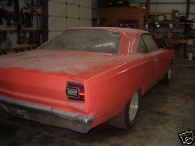

Some pics that the guy I bought it from took
pics

i wouldnt turn that down looks good

when was the car repainted orange?

that aint orange, thats Peach Sherbert! GROSS. The whole car will be stripped and be painted Hemi or Vitamin C orange, whicever is the richer middle darkness one. The reason its peach is it was sitting in a shop for 20 years in black primer, and the guy decided to spray it with some crappy paint he had left to seal it up.

haha
terrible

Terrible car or colour?

Well, it looks like a good car. Start from the front and work your way to the back going over every little thing there is. If you see a problem, write it down and keep going. Let us know what you find and we can help you from there.

terrible that someone would do that to the car
