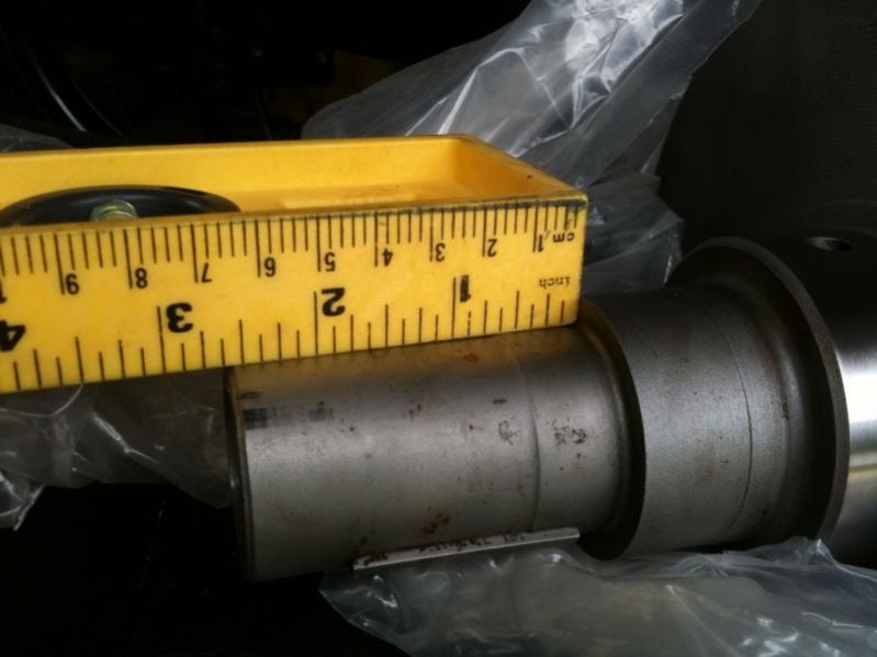

Cast or Forged?
Here are a couple pics of the crak. Is it cast or forged?
440 rebuild advice for a novice-440-crank-2-3-27-10.jpg[/ATTACH]

I'm not sure on your crank, I know someone can run the numbers and tell, I always went by the balancer.
