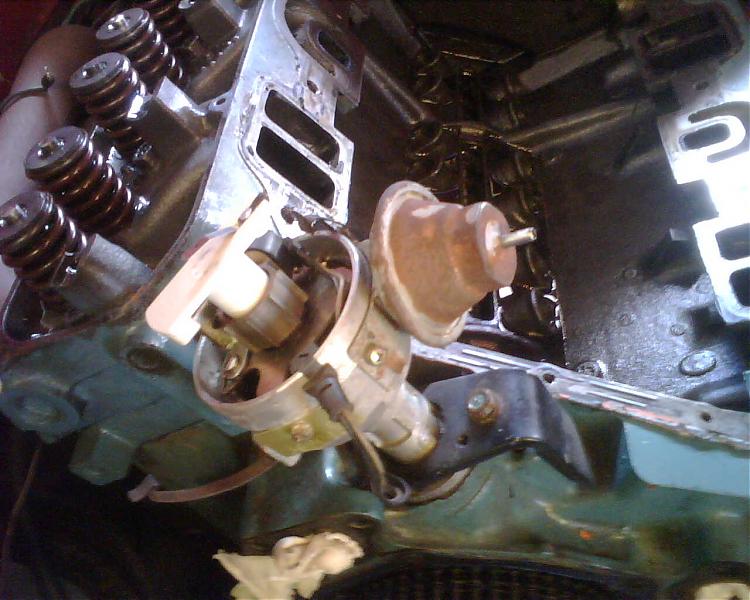

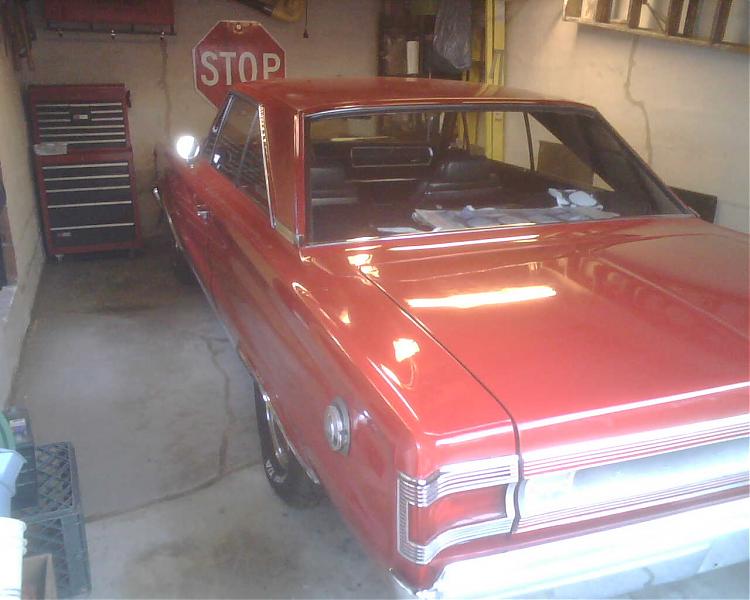

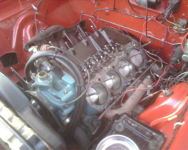

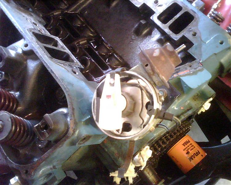

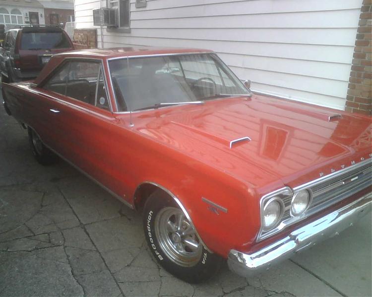

Here are a few pics from when we got it and during the rebuild that me and my Dad did on the motor
