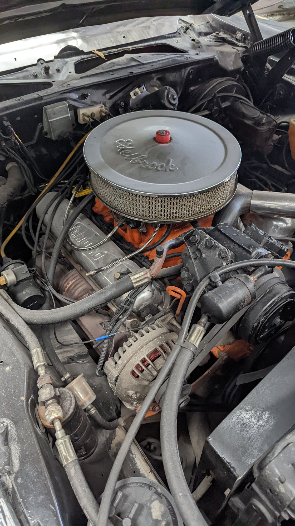

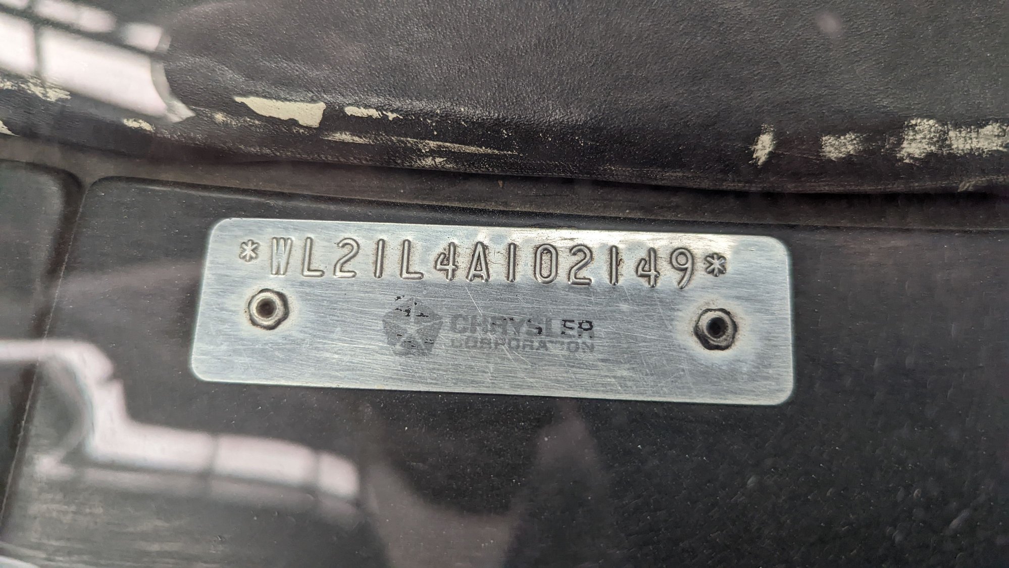

Previous owner seems to have added some stuff on the back to lift it, maybe extra leaf spring. He says the engine is a 318, but i tried decoding the VIN and seems to have originally come with a 360. Can you ID the engine? I won't be able to take another look till next week, had to travel out of town.

I think I would be looking for the VIN on different parts of the car, I don’t like the way the VIN tag has been buffed off. You should be able to find it on the core support and on the inside of the Lt quarter panel drip rail in the trunk. The hood and bumpers are off an earlier car I’m thinking 71 so who knows what it is…
The small block should have its displacement cast into the side of the block in fairly large number’s.
the car looks like someone’s mop job to me…

Yeah I can absolutely tell the old owner did a hack job, but I'm happy with the current state... I think a restomod will be better than an actual clean stock rebuild.

My point was make sure it is what it’s supposed to be even compare the VIN tag against the title before you pay the man. Trust nothing…
