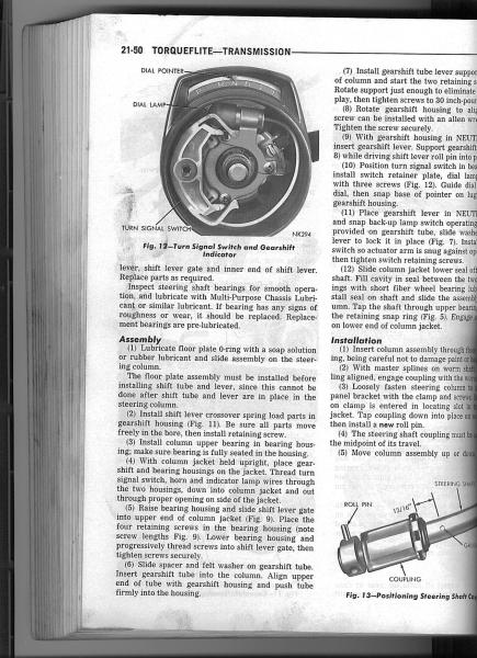

Hi Guys, Have a 68 Satellite, column shift that does not light up on the gear indicator . Just bought the car. Should this light up. If so how do I change the bulb. Thanks Ken

Good Morning
I hope this helps you . You have to remove the steering wheel . It takes a 1445 bulb . If you need more info let me know. If you can't make out the picture I can try and email it to you direct. I am just not real good with the computer stuff. 1966-1974 Mopar's I can do almost with my eyes closed. Or I use to . LOL

Thanks I will give it a shot.
