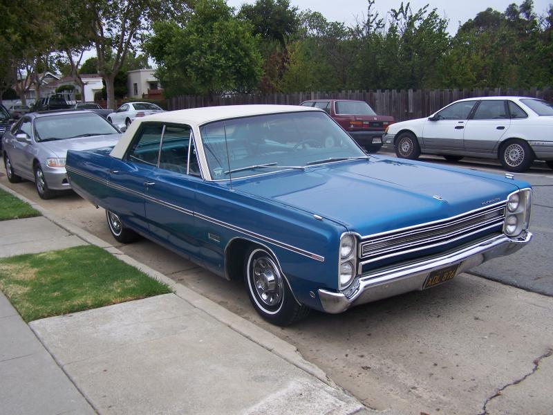

My '68 Fury
Attached Thumbnails '68 Fury Tire Size?-68-fury-front-pass.jpg   '68 Fury Tire Size?-68-fury-int-dash.jpg
Old Aug 17, 2010 | 02:18 PM
OMG! That is a BYOOOOOOOTIFUL ride! Sniff. It reminds me of the day I got mine, way back in '94. I really like the four doors on yours--very usable! I got so tired of getting my lazy butt out and lifting the seat so friends could get in.
I really like that ride! It's in wonderful shape! Thanks for posting it!
