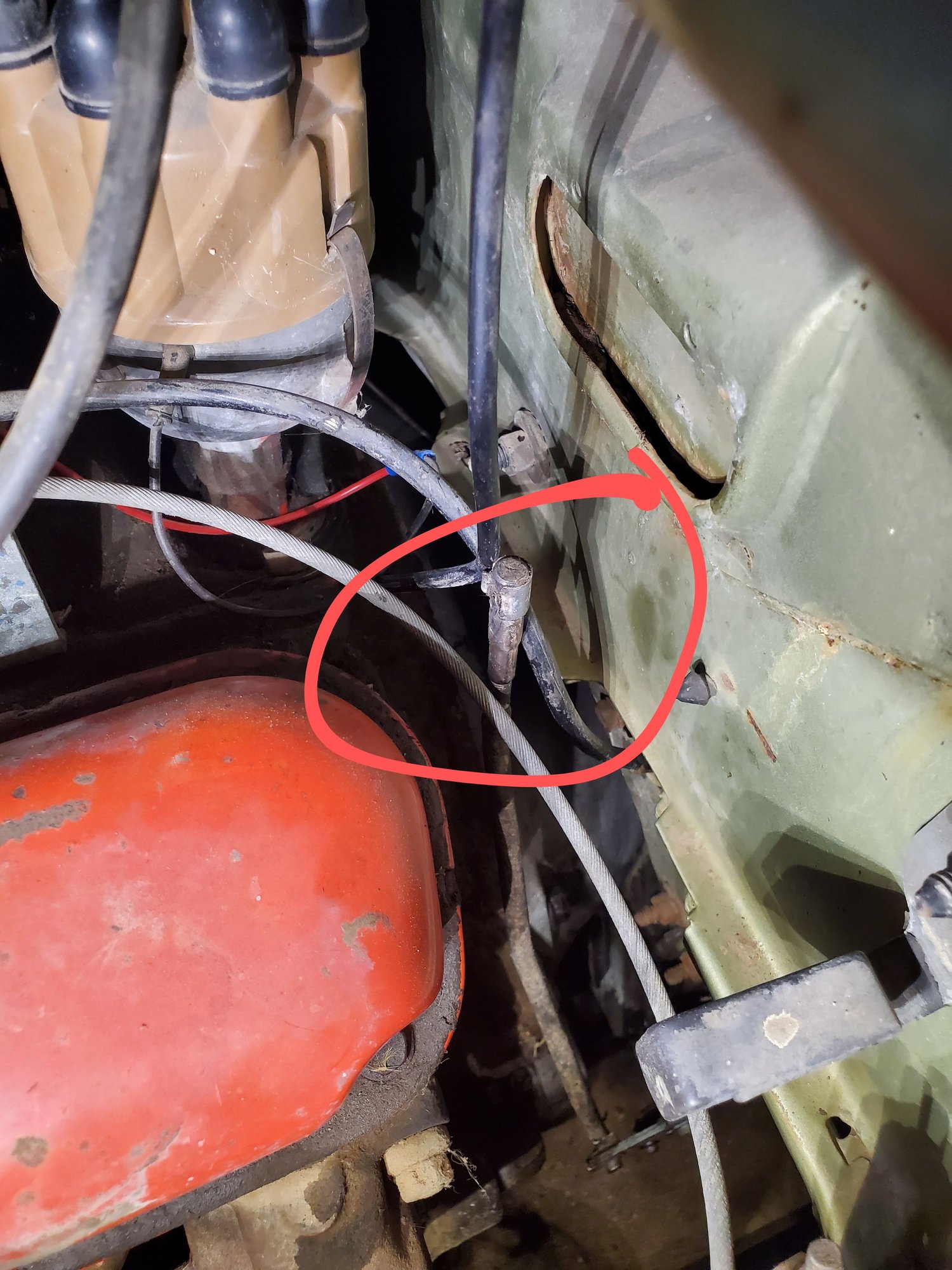

From what I see the one from the column is still connected. The one I've marked in red hasn't been connected since I bought the car not sure what it is.
Old Jun 10, 2023 | 04:57 PM
That is the thottle pressure valve.... If it is not connected it will burn the trans up.... It set pressures inside the transmission.... Not good

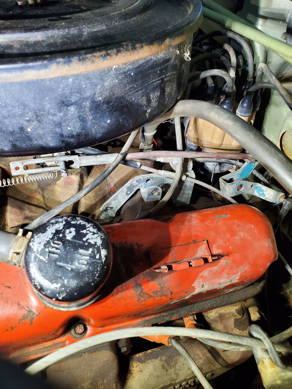

Believe I've found what your talking about but looks like I have two diffrent set ups here.
Old Jun 10, 2023 | 05:38 PM
You are correct.... Yikes....
Info about 6 min, into the video...

From the photo, Looks like it has a 2 barrel carb on it... The linkage looks correct, Its just missing the 1 pivot bracket... As far as i know, you can still get that bracket..
The one that is connected to the throttle looks like the later pivot style and uses a different rod and pivot..
Something else I wanted to ask. It looks like i have the 383/440 throttle rod with the 318 bracket assembly on the motor should I stick with the 383/440 or get the 318 throttle rod. I noticed in this blueprint there is a adjustable swivel on the bottom of the 318 linkage. Where I do not on the throttle rod i have.

The photo was just an example..... You just need the pivot bracket for the set up that you have.....
AS for the rod adjustment, That is up at the carb. in you photo, the black cable is covering the adjustment. It is threaded at the end of that rod.....
