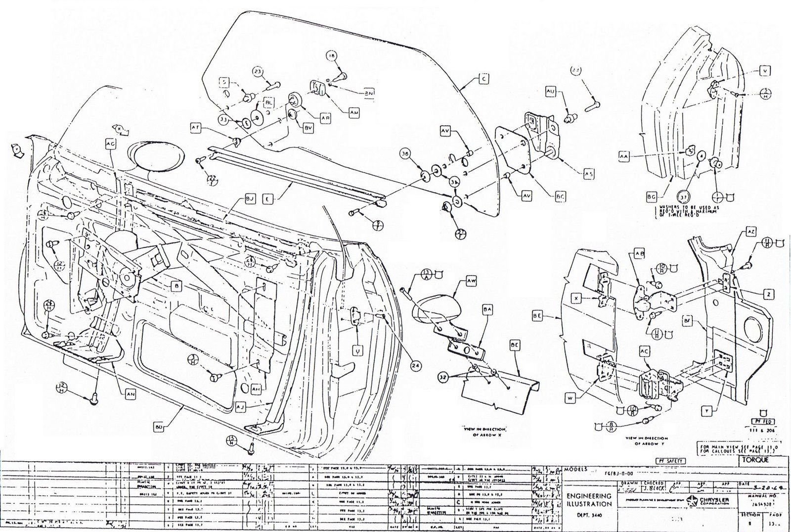

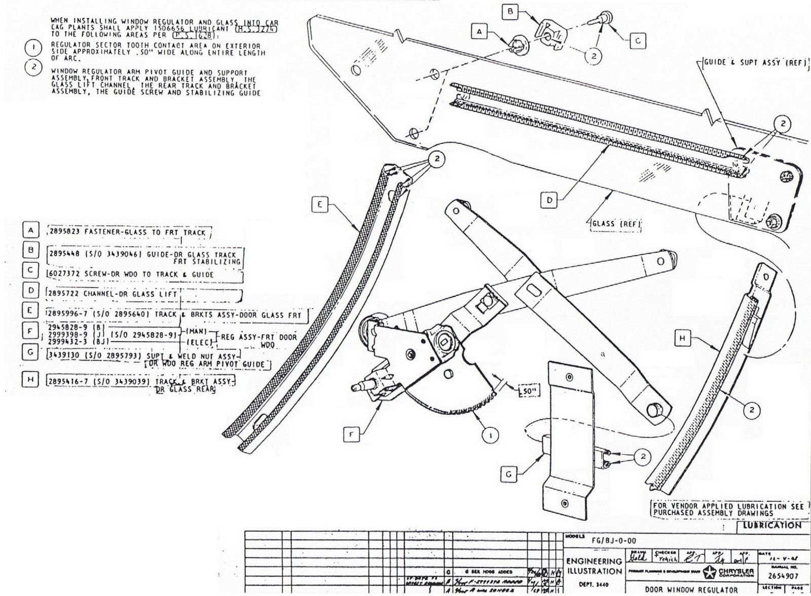

I'm also having trouble with my 71 Cuda side window. Took the door panel off, and found a couple of plastic rollers and other odd bits in the bottom of the door. I ordered a new roller set, but do not have a diagram showing where all the pieces go. Anyone out there have such a diagram or instructions? Thanks!

Old Oct 16, 2022 | 06:04 PM
I haven't been inside a Cuda door for over thirty years but I believe they go on the ends of the lift arms inside the long flat guide that goes on the glass.
