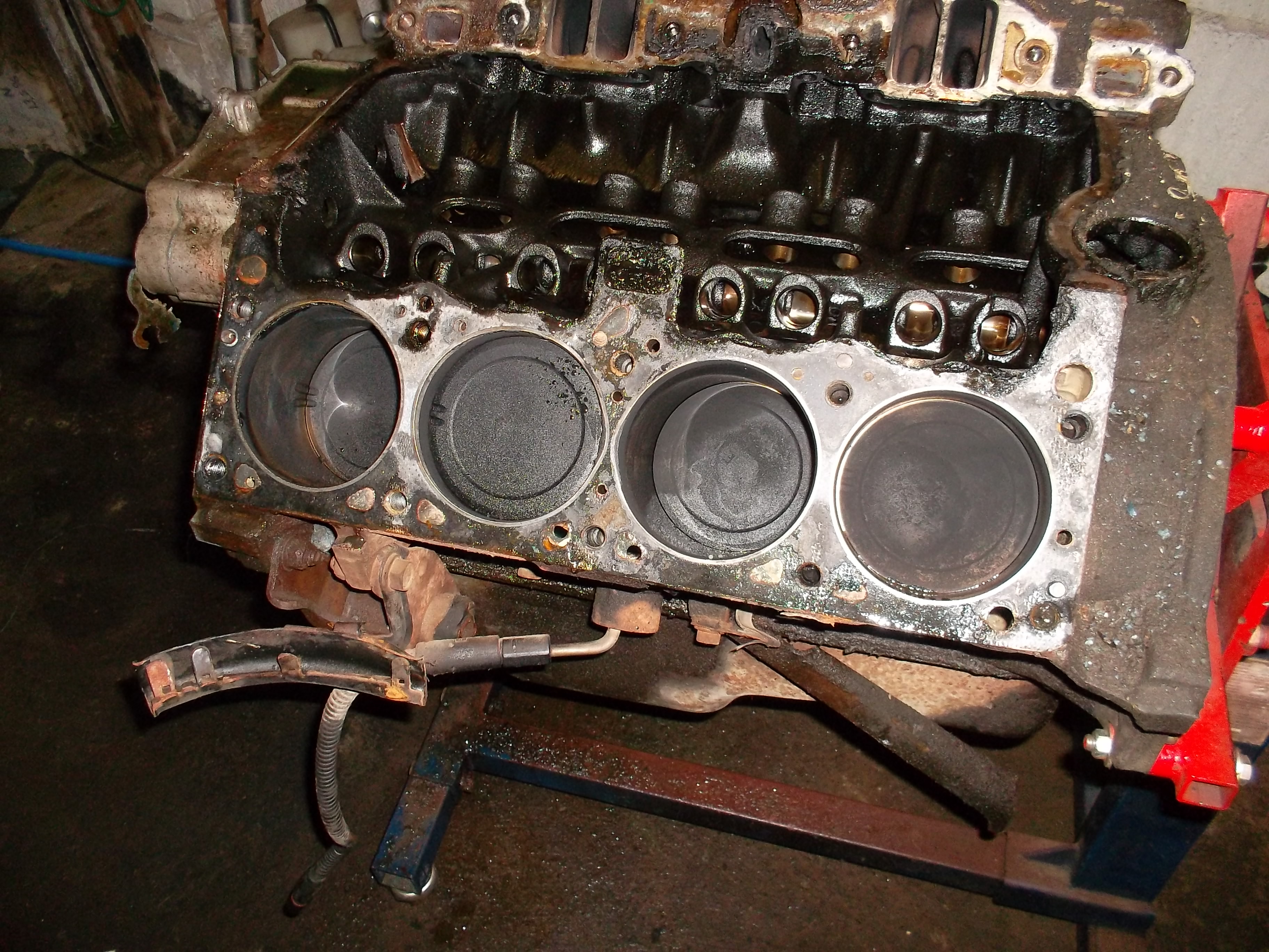

Soft valvesprings was the problem
Mark your parts, if you are going to reuse them!
Sharp edges on the block and heads were smoothed out, makes it more pleasent to work arround the engine! hehehe
