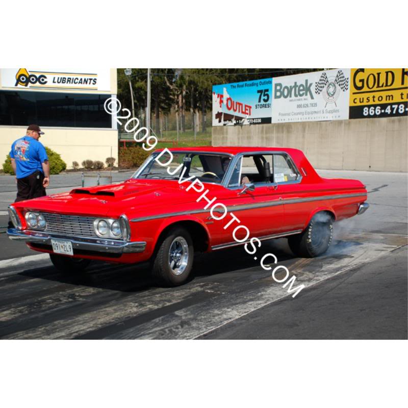

Mine is a 493 stroker in my 63 Sport Fury. I used a 440source kit as it is a .030 over 440 block and the 4.15 crank. It has dished pistons to get me 10.6 comp and good quench with the Indy EZ heads I am using. They are just opened up to max wedge ports. Cam is a custom grind by Dwayne Porter which is 264 & 270 @ .050 and .630 lift with my 1.6 Hughes rockers. 110 LSA and I have it in at 106. Indy dual plane intake and 850 DP carb. TTI 2" headers and complete 3" X-pipe exh. The car weighs just over 3700 with me in it and I use a Dynamic 9.5 converter with 4.30's and a 30 x 9 tire. It runs fine on 92 pump and it is a street car I drive everywhere including the 90 mile round trip to the track. Only have 2 passes on this eng as it was to lean when I went and breaking up at the top of each gear and I need to jet up some. Best et like that was 11.04 @ 121 thru the complete exh system just the way I drive it but I know it has easy 10's when I jet some more. Ron
I just ran 10.76 @ 124.46 last weekend ! Ron
