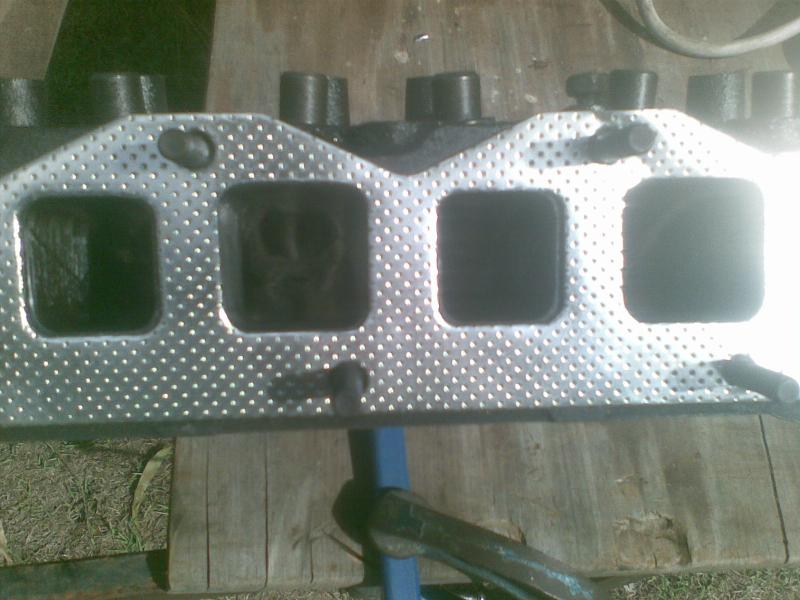

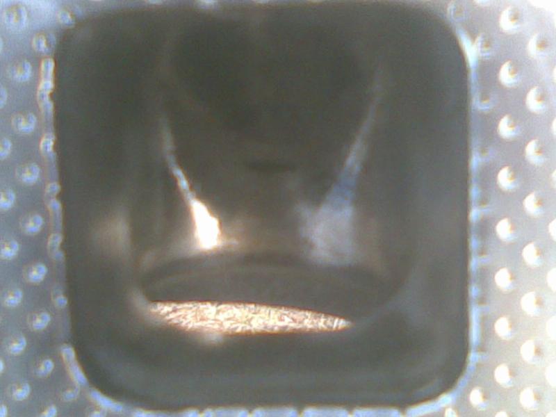

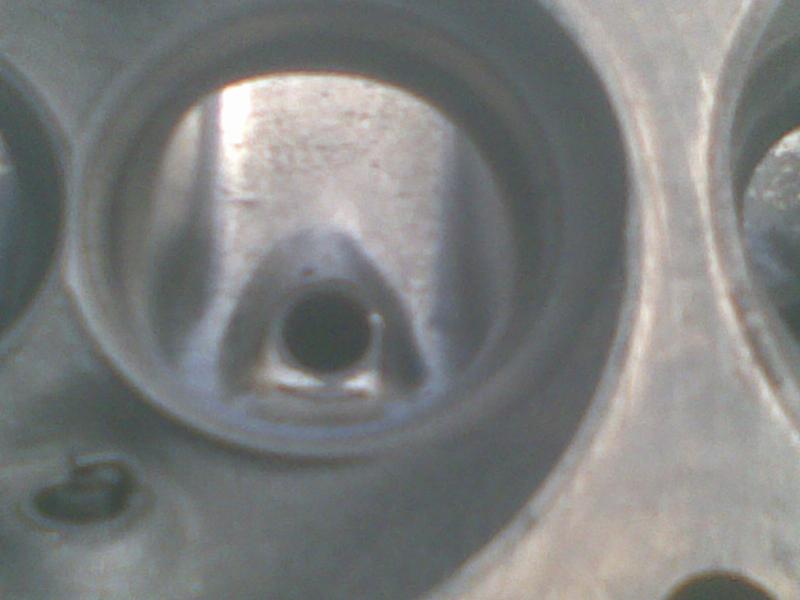

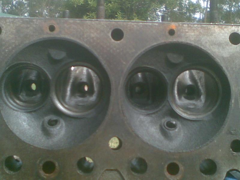

i guess the main + for the hemi six port is it a straight shot at the valve with no push rod pinch & the air don't have to change shape as much ether . also being a newer design the castings where much better . very little flash , just gasket match then run all over the port hog out the valve guides , then blend the bowls easy head to port .
Attached Thumbnails Bought speedway car last night-265-porting-photos-006.jpg   Bought speedway car last night-265-porting-photos-005.jpg   Bought speedway car last night-265-porting-photos-002.jpg   Bought speedway car last night-265-porting-photos-007.jpg

the exhausts haven't been done yet they will also be getting k-lines banged in & also I'll angle grind the tops of the valve guides down so no spring retainer issues , we'll have to shorten the umbrella stem seals also ( with sizzors or some thing cheap & nasty )
Attached Thumbnails Bought speedway car last night-265-porting-photos-004.jpg   Bought speedway car last night-265-porting-photos-012.jpg   Bought speedway car last night-265-porting-photos-001.jpg
