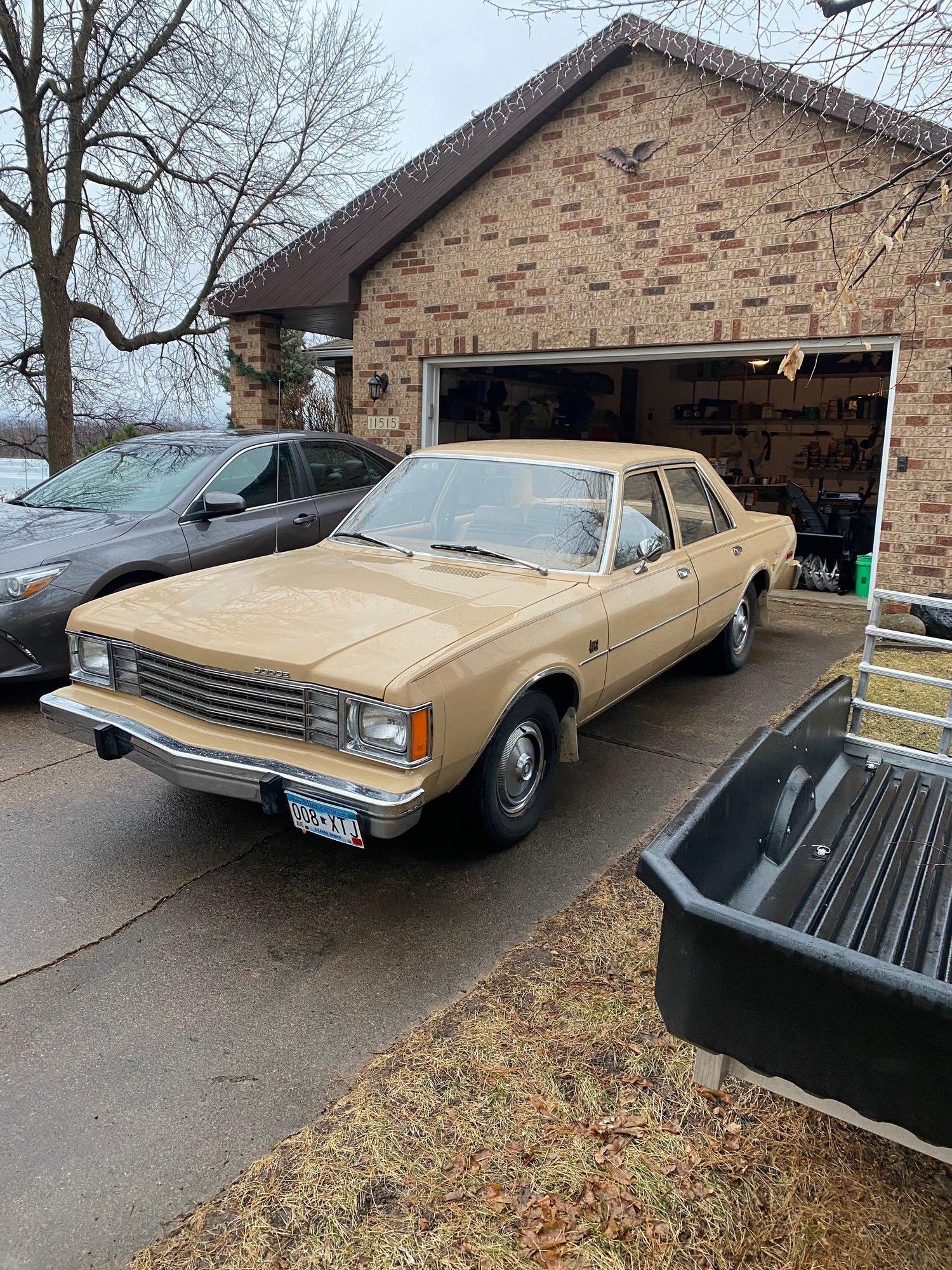

Hello,
I recently bought a 1980 Dodge Aspen Base Model Tan Sedan, it has a 225 slant six motor, about 64,000 miles and is solid, more or less.
This was the same year, color, and model as the first car I owned when I was fifteen. I am 41 now. I painted the one I had when I was fifteen flat black, then I proceeded to destroy it. Then I destroyed car after car until I was about 20 years old. Then I learned how to keep beat up old Toyotas running because I did not have a choice. Now I make more money, I drive newer Toyotas, it is what it is. They break down less often.
I came across this new Aspen for $2500 and I couldn't pass it up. I love driving it, nostalgia is crazy, and its more fun to drive than newer cars. I've learned how to fix tings now. I think I'm going to fix this old car up, like I should have done to my first one.
I got the Dutra 225 rebuild book and have been watching Uncle Tony videos on youtube. I'd like to pull the engine this winter, rebuild (shooting for 120-150 hp and decent gas mileage), and put it back in.
I wanted to say hello, I look forward to reading through this forum. I'll attach a pic of the car. And pics as I go along.

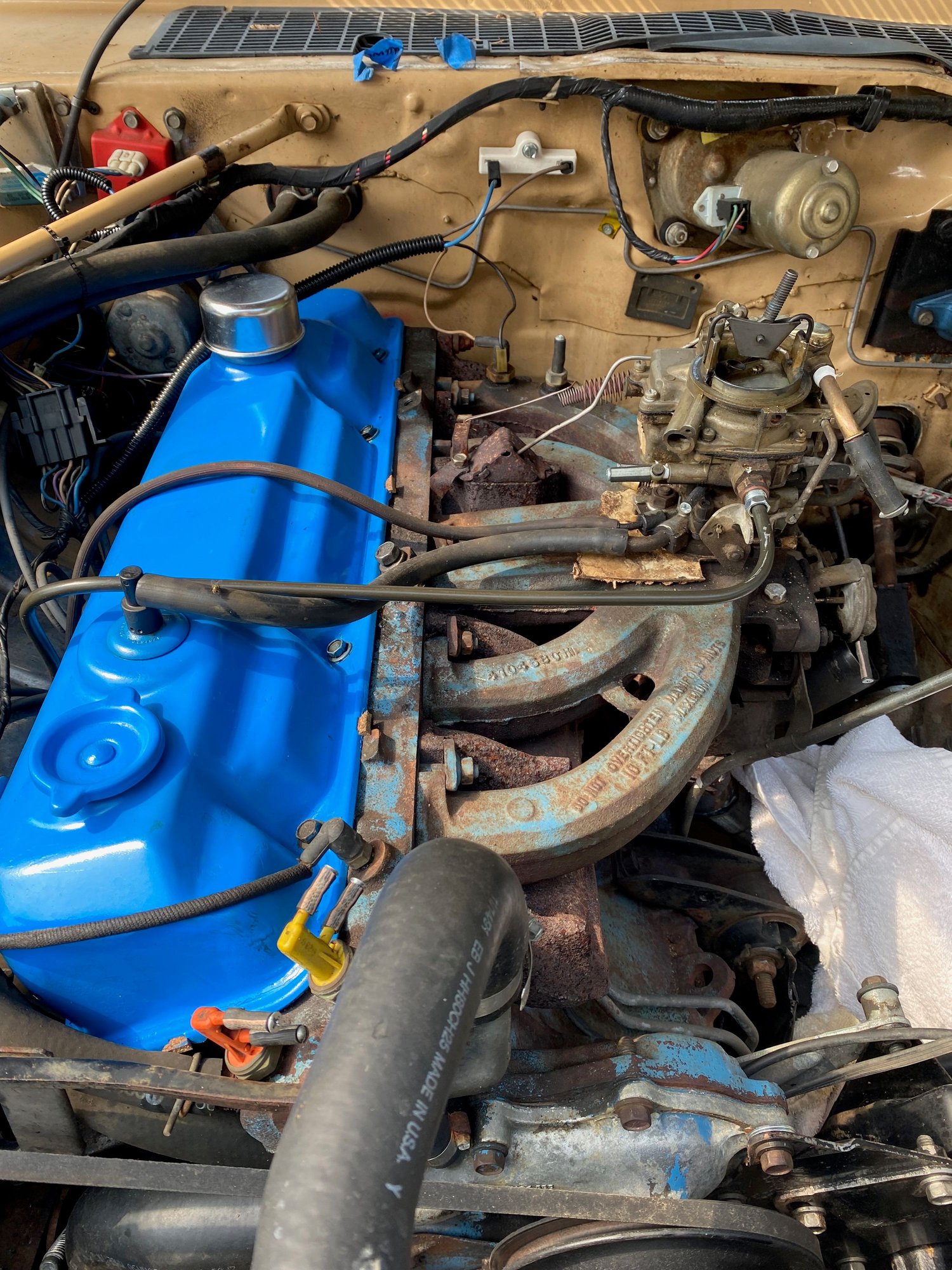

Looks pretty spiffy! The car feels quicker, and sounds better too. Gasket, paint, degreaser, cut off wheels; $30 upgrade.
We are going to keep this car. I'm going to keep the slant six too. My son and I took a bunch of vacuum lines off of the carb, got ri of the charcoal can, painted the valve cover (replaced gasket), and cut up the stock air cleaner and painted that too. The car feels a little quicker and sounds better and might run better too.
I got lots of plans, but we'll just do a little bit at a time. There are more pics in our album. Future ideas (as of today) hyper pack, two barrel, headers to single pipe, sure trac rear, new leaf springs, rebuilt front end with original K member, torsion bars, sway bars, all painted up nice and new bushings. etc etc
As soon as I can get a new exhaust on it that air/smog pump is gone, its ugly and I don't like it there. I almost too it today and just cut the exhaust under the manifold, but I don't want it to be too loud for cruising my wife around in to get ice cream, so I'll have to wait a little longer before I can say goodbye.

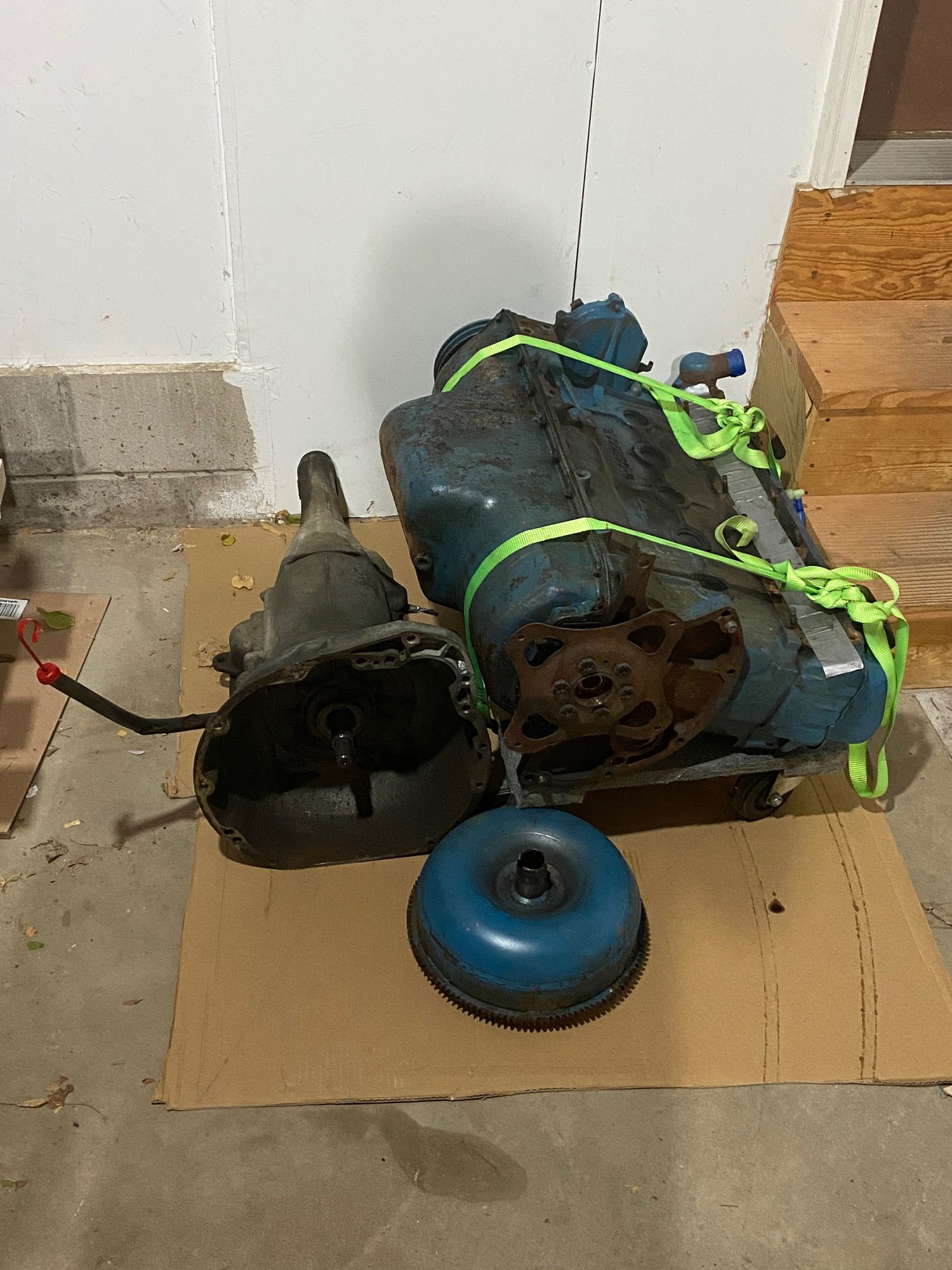

Here's a new acquisition for the car. I got this 72 slant and the 904 transmission next to it for $50, pulled running, full of oil. This way we can try to build this one while we're driving the car, then do a quick swap. The paint on it looks nicer than the paint on the one I'm driving right now. I like the price tag of these slant sixes. They'll be good to practice on.
Here's the second motor, 72? 225 and a 904 transmission for total of $50, pulled running, full of oil.

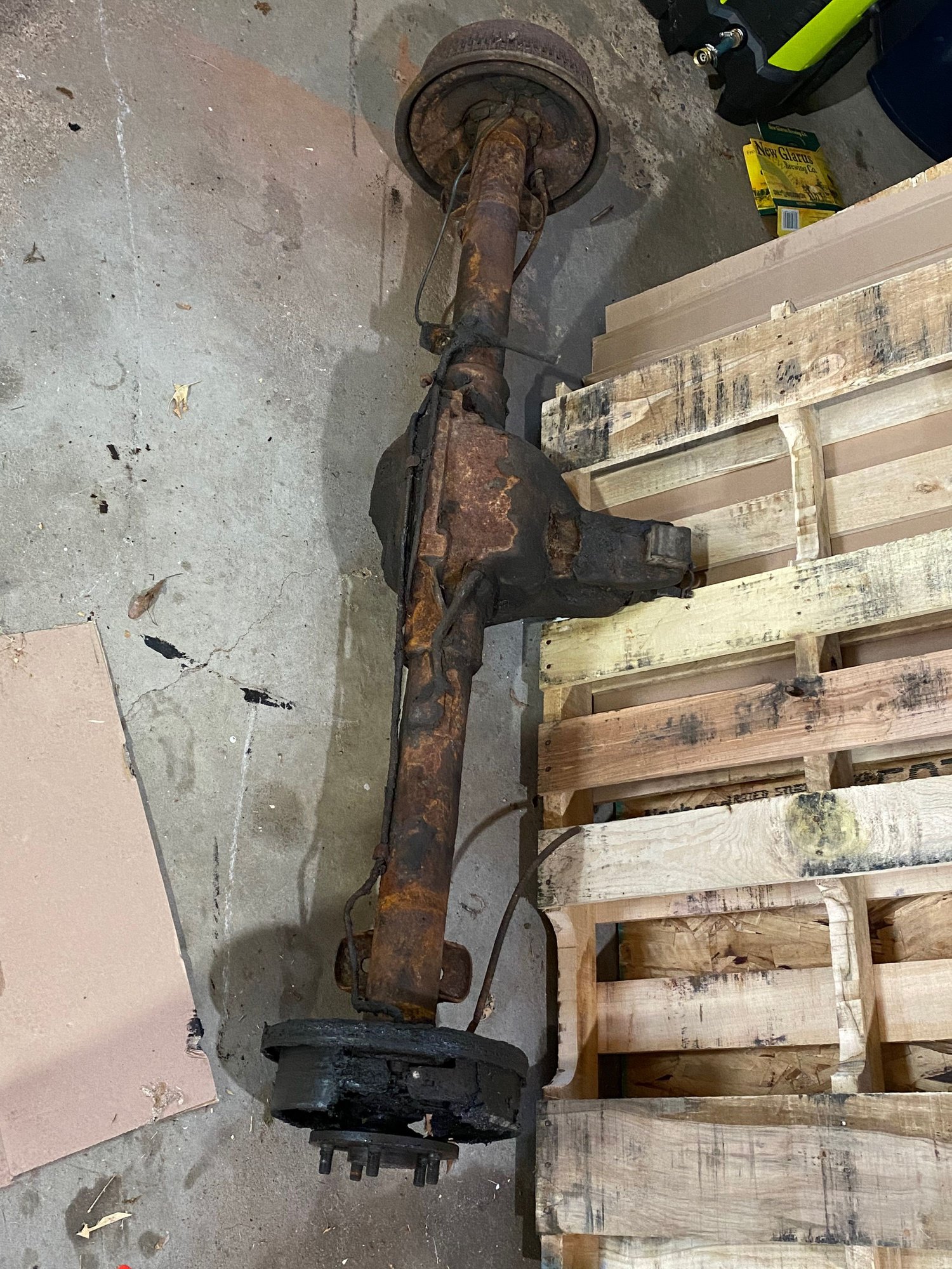

Talking I bought a rusty piece of metal
Here's the new axle ($75), in all its glory. I'm hoping it cleans up ok, I think it will. I'm gonna try to strip the rust with electrolysis in my garage.
The second pick is a pair of 1998 Cherokee rear brake calipers and backing plates ($60, maybe I overpaid, but they were there). They are also going to get rebuilt/painted. They bolt right onto the axle to replace the drums.
Other costs for this axle will be the 27 spline 8.25 sure trac from Dr Diff approximately $350, and a set of new 3.55 gears, approximately $100, and some bearings, paint, seals, bolts, and fluids approximately $100.
I should be looking at a new, direct bolt in, disc brake converted, 8.25 positraction axle, for about $700.

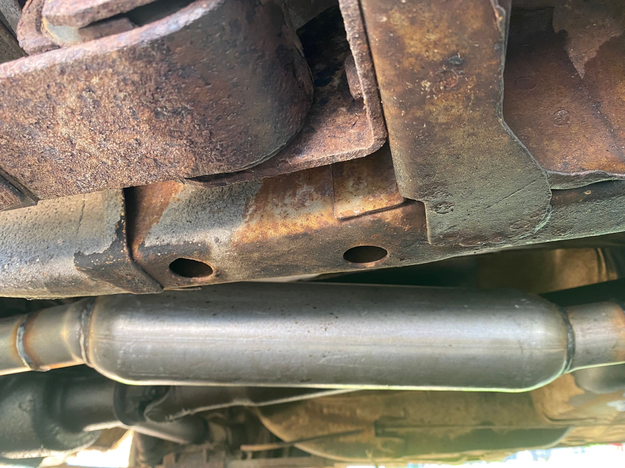

Took off the air pump and deleted the catalytic converter
Pic 2 of 3 New Exhaust, just a pipe with a glass pack, $239 at the local muffler shop
Pic 3 of 3 New Exhaust, just a pipe with a glass pack, $239 at the local muffler shop. I think I'll bring it back and have him extend so its almost touching the bumper.
I'm sorry I don't know how to make these pictures smaller.
Well; I still have the car. Just got it back from the local muffler guy who kept it over the weekend. He deleted the catalytic converter for me and welded up this straight pipe with a glass pack right off the little stub hanging off the manifold.
He also blocked off the air inlet at the back of the cylinder head where the air pump would pump air into the head.
As you can see in the first pic, I finally have the air pump and that huge bracket off the engine too.
The engine bay is starting to clean up.
I can see most of the engine now.
I have to say, the less restrictive exhaust, actually sounds very mean. Its not deep like a dual exhaust V8, but it does have a pretty cool and distinct sound. Through the single pipe, with a minimal muffler, this engine sounds better than I thought it would.

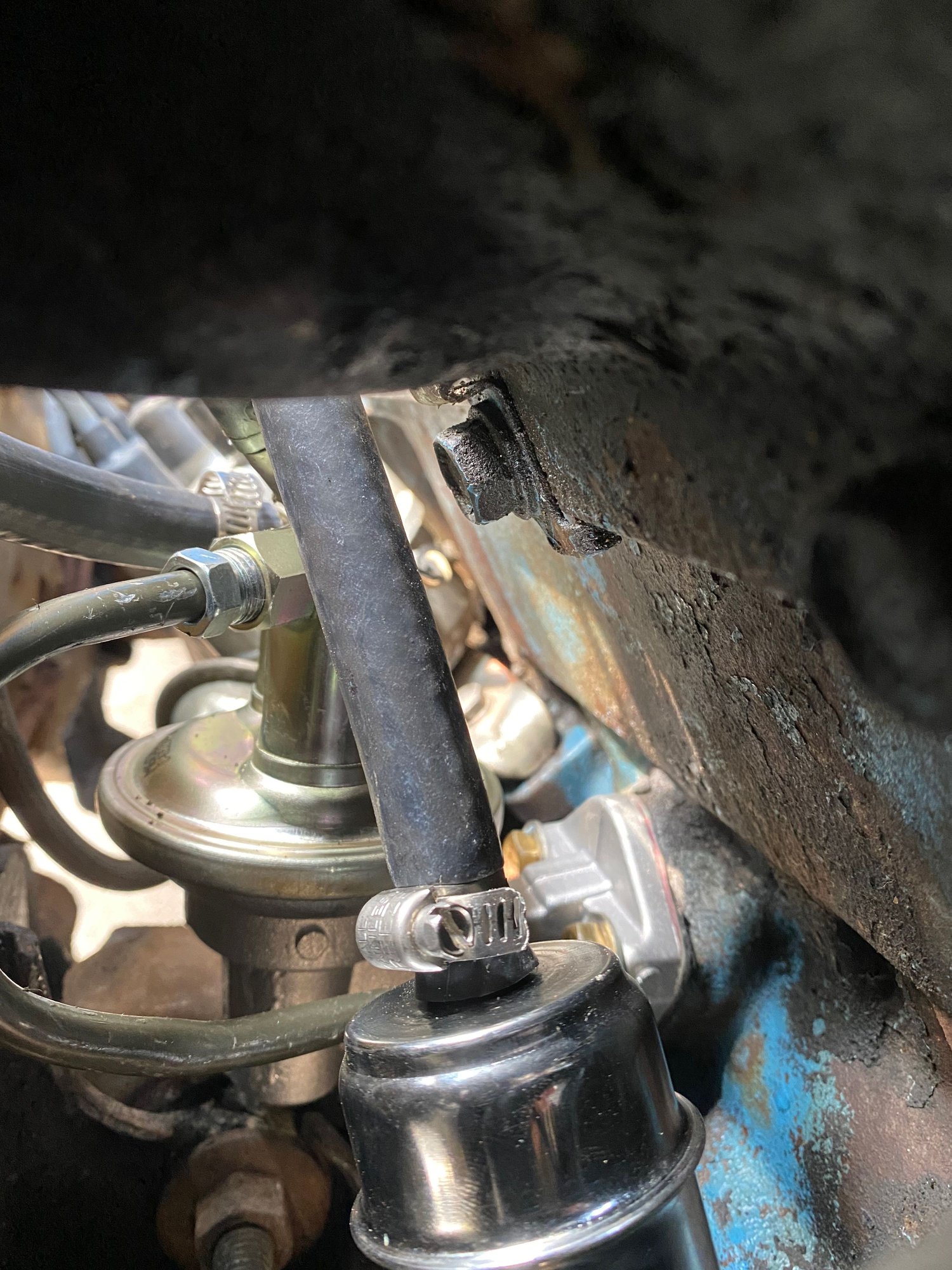

Regarding the air pump/charcoal can delete previously posted:
Of course you want to keep the vacuum line on the timing advance, but there is one other line that runs from the fuel system to the charcoal can, I had plugged this line up and just left it plugged by where the can used to be. This line vents excess pressure in the fuel system into the charcoal can, I think.
Anyways my fuel system was pressurizing, like a lot. I took the little screw plug I had in the end of this hose off, and now my fuel system does not seem to be over pressurizing.
