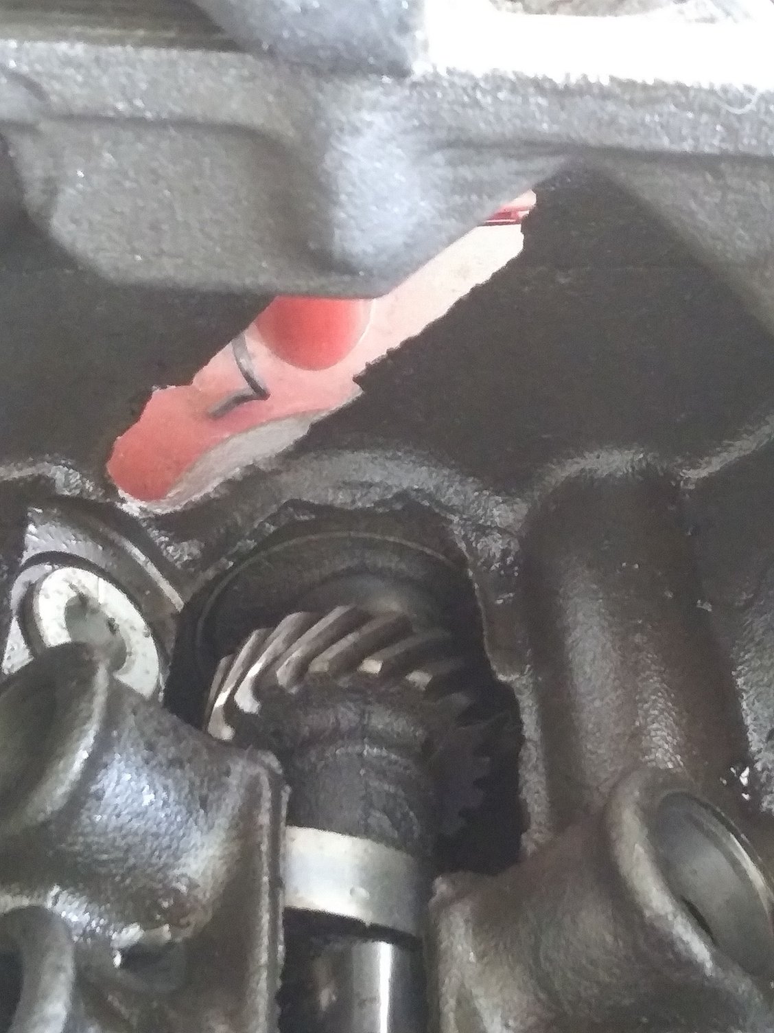

78 440 block. Came from a motor home for free. Tore it down to the block and I have it on the stand and see this. Is that evidence of chunks gone or bad machining?

Very common

This is normal, both in big and small block, I usually clean it up with a rotary carbide for oil flow.
