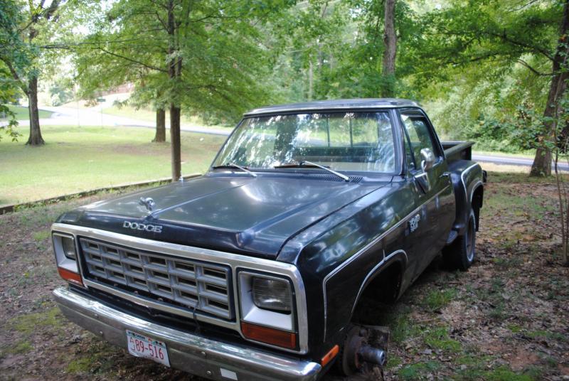

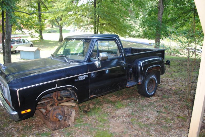

Hello folks,
My name is John Troyer; long time MOPAR lover, first time rebuilder. Currently live in Birmingham, AL, wife, kid(s) (one due shortly) so this project is looking at being long term. Not wanting to restore back to original, but to have an original, unique, truck when I am done.
I have an '82 Dodge Ram W150 4x4 that I am looking at rebuilding. My current plan consists of striping it all the way down to the frame and rebuilding from there. I want to put a 383 in it (still looking for one to rebuild); currently it has a 318 which is what I will rebuild if I can't find a 383. I know that with a 383 it will need a bit of rebuilding on the front suspension and a few modifcations to make it fit. Will also need to redo all the interior and to finish it off a new paint job. Thinking I am going to stick with black. I am also considering exhaust stacks like you would see on the little red express trucks.
With that said here are a few current pictures and I am welcoming any advice and/or suggestions.

Welcome aboard! Sounds like a nice project and you have a lot of your ducks in line already.
Only question is: what will be the general purpose of the truck? That will really determine if the 318 or 383 will be a better choice. (And of course, what it will take to make YOU happiest )

Welcome to the show, like the truck man.

Many Dodge trucks came with BB motos up til 78/79 so to get ont to fit into your truck will take no modifying with the frames were kept the same. All you need are a set of BB motor mounts, the proper size radiator, rear sump oil pan, BB transmission and t-case.
Trust me, that little 318 can produce a good amount of power when built right and can handle a lot of abuse.

Hey John.... Welcome to the forum.... Make sure you vote for the Mopar of the Month..... That is going to be one very nice truck.... Keep us posted on your progress.....

welcome, cool truck!
