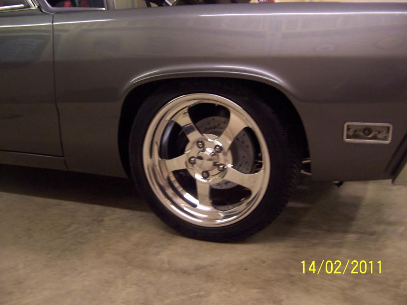

Nice ride!!!! If you don't mind me askin', what tire/rim size package do you have going on that baby? Is it stock fender and suspension fit? I'm looking to do something similar with my '66 Belvedere.

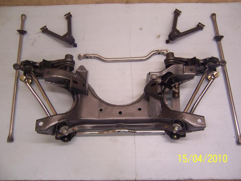

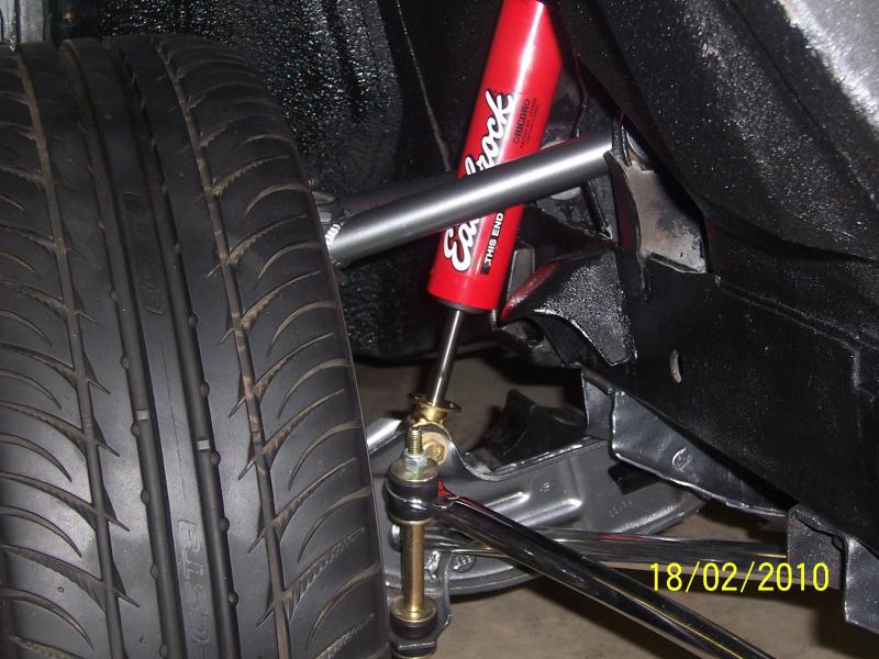

Rim size is [ rear 17x11 with 4 1/2 back space rear tire size 285-40-17 Front rim's 17x7 with 4 3/4 back tire 215-45-17 ] The rear end has been cut down to 46 inch front has 2 inch drop spindle's and tubular upper a-arm's.
