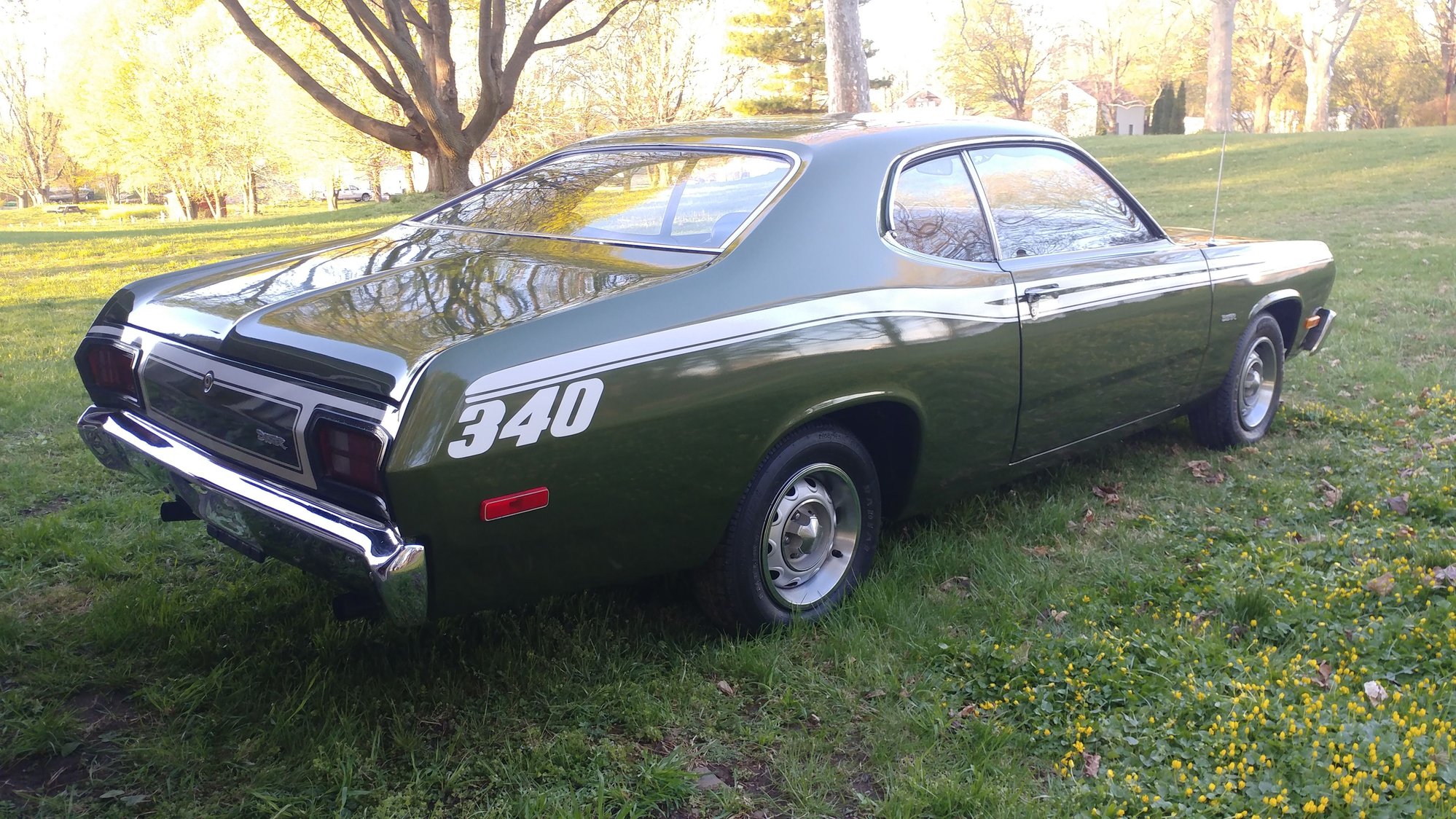

Hi All. My name is Paul Anthony and am a new member. I own a 1973 Plymouth Duster 340 4 speed all original and matching numbers. It is in excellent condition. The original Carter 4 Barrel Thermo Quad Carb requires rebuild. I am thinking of doing that or instead to retrofit a Holley or Edlebrock 600 CFM performance Carb. Any thoughts or suggestions are appreciated. Thanks!
