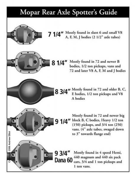

Don't know if this has been posted here or not...But it's a good chart anyway.

it looks like an 8 3/4. but the early units had a different style of axle flange, the pre-67 units had a nut on the end of the axle you tightened down , the 67- and up had a 5 lug flange that bolted onto the banjo tube. the nut type had a habit of snapping undr extreme pressure loads. but an 8 3/4 from a 67-70 b-body will work in your car, itll bolt right in.

Did you figure anything out with regards to the rear end ? If you can locate the casting numbers on the rear. If it is a "741" ( the small pinion 1 3/8" ) 8 3/4 the casting will have a large X cast in the left side.
If the rear is the "742" this is the large pinion rear ( 1 3/4" ) it may have a large 2 cast on the left side.
If the rear is the "489" this is the tapered pinion ( 1 7/8" ) it will have a large 9 stamped in it. Through 1965 the ratio was stamped in the id boss of the rear end followed by an S for sure grip. After 65 the ratio was stamped in a tag that was located under the carrier mounting nuts. Sometimes there was a Sure Grip lube tag applied or as crazy as this is the filler nut/plug was painted orange.

As far as the rear end goes, it is an 8 3/4, just depends now on which 8 3/4 it is. They are all strong and desirable.
