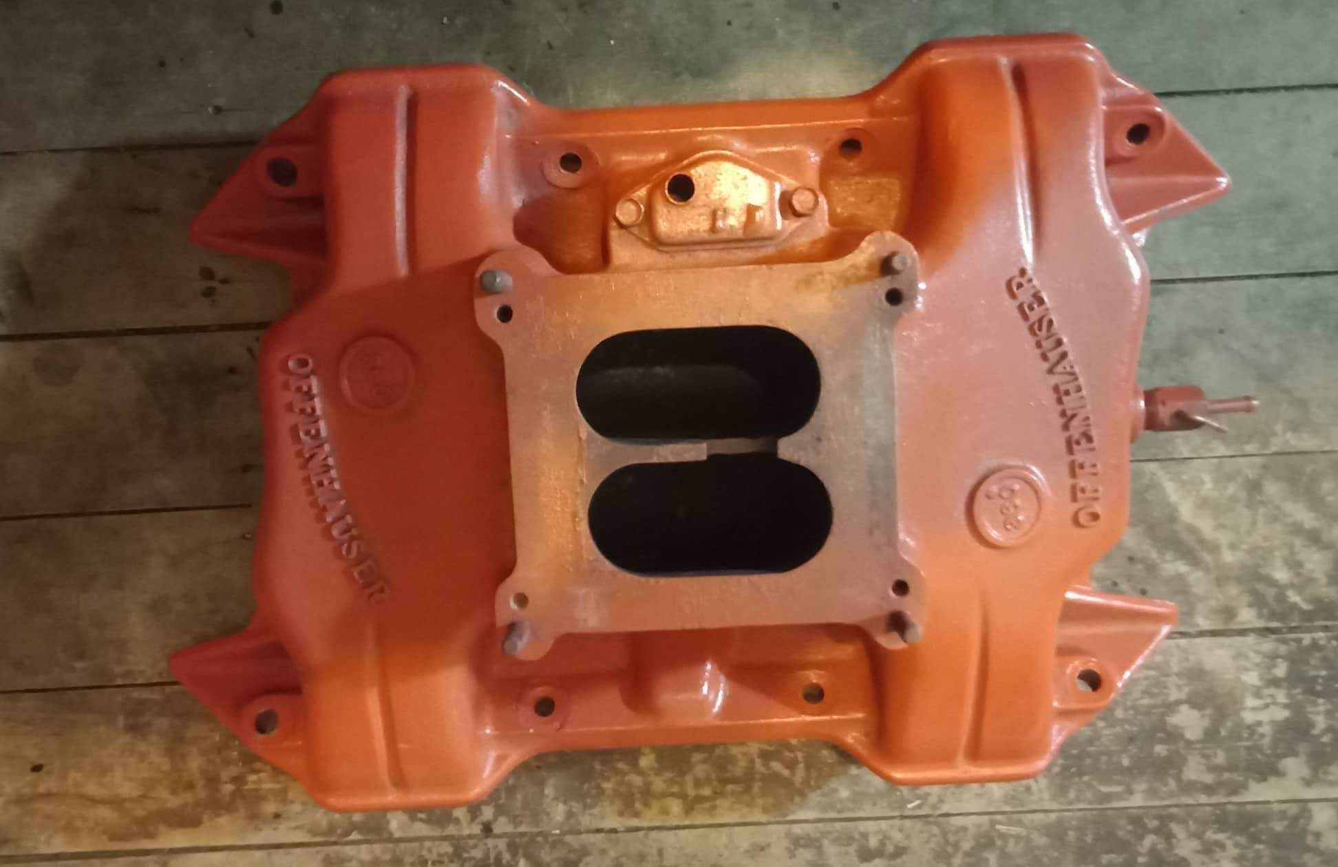

hi guys i have been trying to look for a alloy intake manifold for my engine and they are slim picking where i am but i have found an offy at a reasonable price, i have read some write ups about them but i couldn't find a lot of info on them..my question is, is
the one I'm looking at going to be any good and any real improvement over a stock cast manifold and what are the provisions it has on the offy manifold, any opinions would be much appreciated..i like the weiand action+ and the edel 7186 but they are so dam $$$$..what are your thought on this one in my pic.

gonna really depend if it's single or dual plane, i think...

that is the actual one i might buy in the picture it appears to be a dual plane
Old Jun 15, 2022 | 11:09 AM
i'd send it then.

The one you pictured, if indeed a dual plane, seems to have an non-standard runner pattern.
Pretty sure it will "work", but how well is going to depend on the application.
What's been done to the motor, what vehicle, and future plans?
If you just need a manifold to get the vehicle running, and that one intact and cheap, sure, go for it.

Looks to me like it could be one of the old Offenhauser Equa-Flow 360* High Rise Manifolds ????
Read up on the following link (Page 18) P#5764 and see if it will fit your build. Good Luck...
https://offenhauser.co/wp-content/up...talog-1987.pdf

hey there thanks for the link... good reading..and actually i found a few more articles in my searching as well and decided i will try get a newer model manifold as in my opinion they are a lot better and suits what i,m doing. yes it is an old model the one i have available here, it looks like a dual plane but it is a single plane suppose to be effective around from 1800rpm all the up to 6500rpm or even slightly more.thanks

hi, this one will be fine for me for the right price, it about $1000 for a new manifold to new Zeeland that's why trying to find out exactly what this one is, they are telling me this is a dual plane i told them it looks like a dual but its plenum design is of single plane design, they argued and said No its definitely a dual, I'm trying to get a serial number off them to confirm what it is as i can see one on the back there in the pic anyways thanks again

The first picture you posted, is a Dual Plan Manifold.
