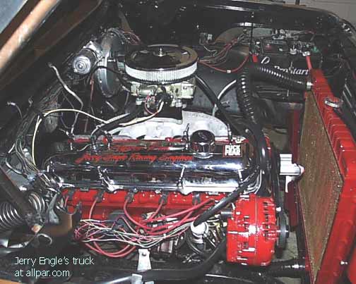

here's one being raced in an 80's pick up.
http://www.allpar.com/racing/engle-pix.html
