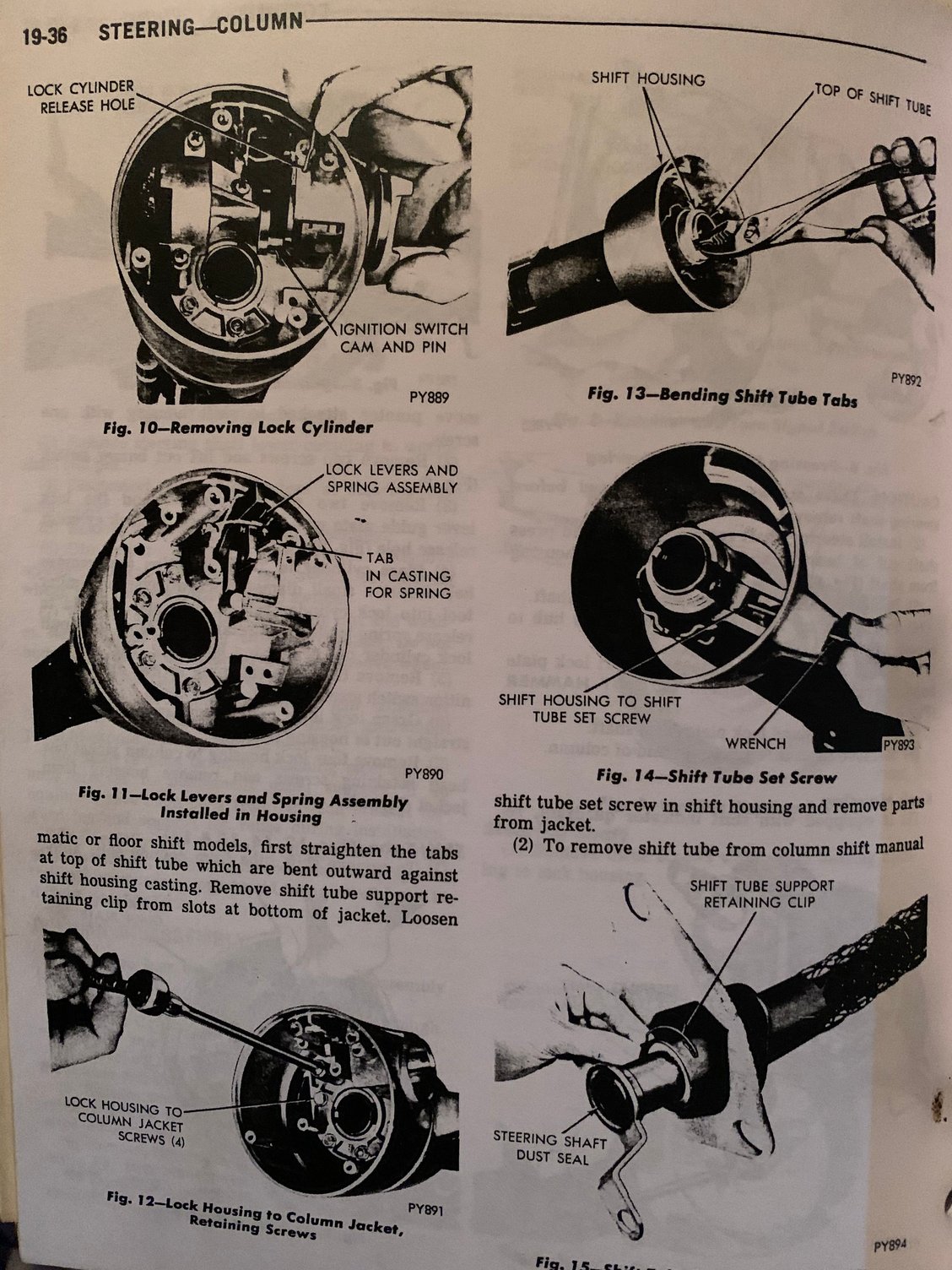

I’m taking off my signal switch and ignition switch out where do I start

Not to be a smart ***, but disconnect the battery first. You would be surprised at the number of people that forget that until the sparks fly. Can't give you step by step directions but have a good steering wheel puller and be sure to index where the wheel is mounted.
