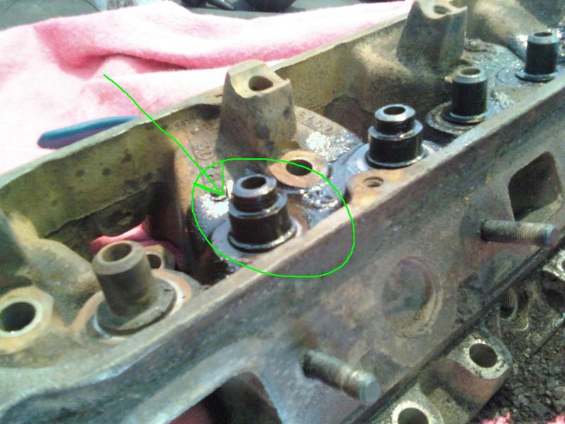

Question VALVES
I think this is the valve seal right? and how do you remove it it has been on there for 32 years.

Ok. I discovered those are part of the head. new question what if those are mangled a little? how come those are thicker than the others?
Old Mar 9, 2009 | 02:47 PM
  #74
those are the stems
they are part of the head
thicker than what?

From: ARIZONA
the ones next to them?

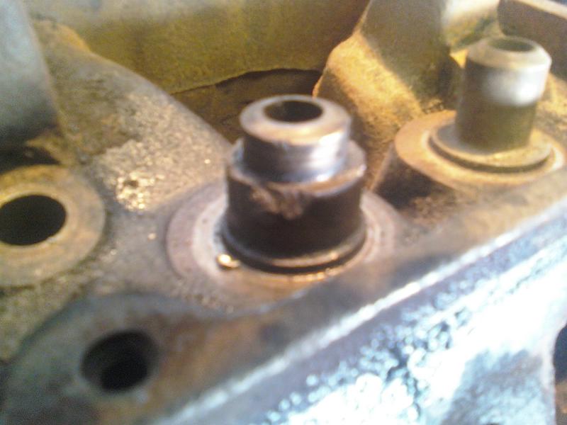

Dos and Don'ts to building and engine
Dos:
1 Know what you are doing!
2 If not get someone that does to help you!
Don'ts
1. Don't just jump into doing something that is going to cost you a lot of money to replace or fix!! For example exibit A: below
SO DID I BASICALLY JUNK THIS HEAD?

Are those stock heads, as you could probably get one for between $50-100.
Old Mar 9, 2009 | 07:58 PM
  #78
crmzendrgone's Avatar
Joined: Feb 2009
Posts: 311
From: ARIZONA
Yes they are my stock heads. Are you saying that i pretty much destroyed them?

From: ARIZONA
Question HARDENED VALVE SEATS?
I went by the machine shop just down the street from my shop and asked them about my head that i screwed up. and they said it was not that bad that they normally grid that down and put a "perfect circle seal" on instead of the umbrella seals that came off, They also recommended do to the year of the heads that i should put hardened seats in the exhaust. SO, my question is that a good idea or is that just another sum of money to spend?
