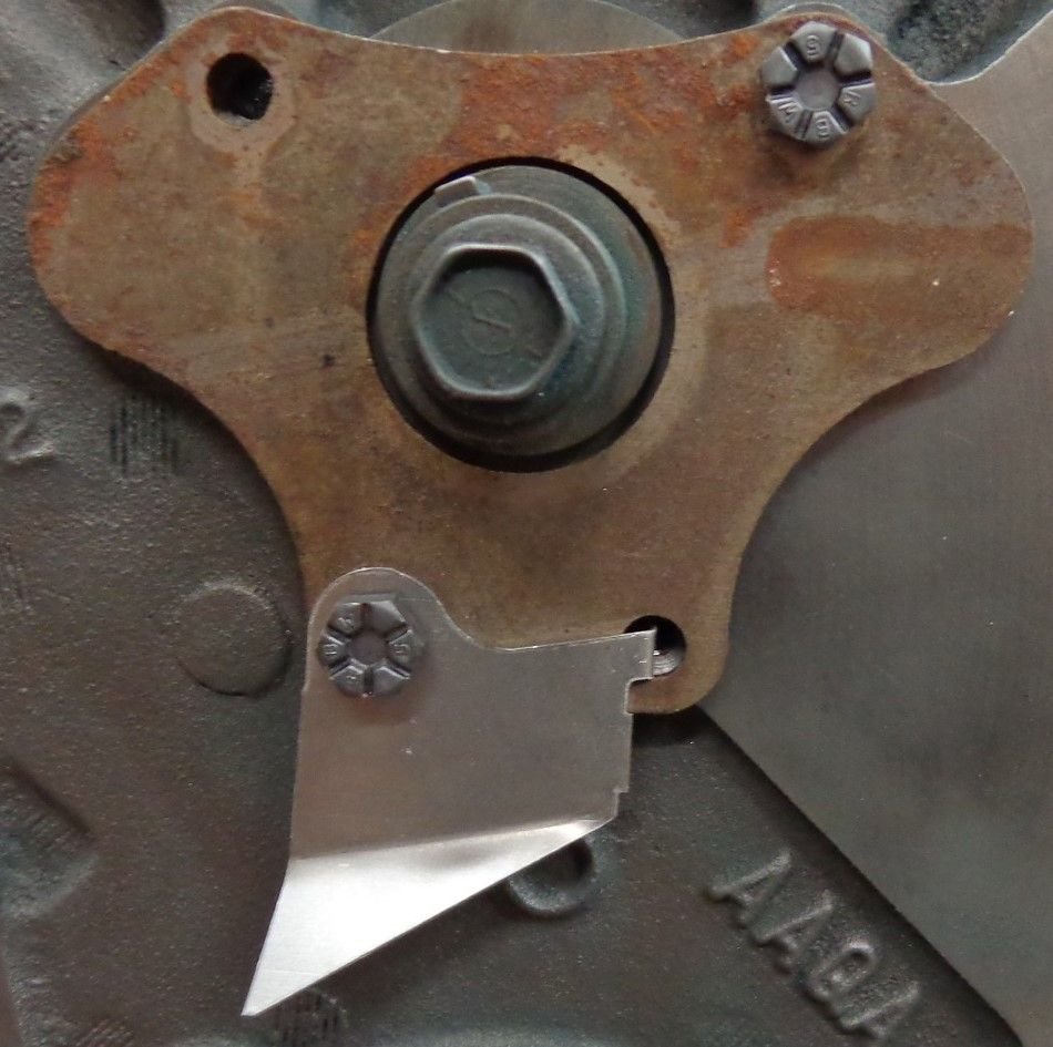

Quick question (ok two)..... I am replacing the timing gears and chain -and noticed there is no oil tab. Is that normal? Where can I get one?

Yep! (I am just reading all of this now) There should apparently be a groove on the back side of the thrust plate on some 360s to allow oil to get to the chain eventually -but others used a hollow bolt in the top passenger side hole which dripped down onto a metal tab -then onto the chain.
Others also used an oil slinger on the crank which also kept excess oil from the seal. Configurations changed over the years and I don't think any had ALL those features, but I don't think this one has ANY of those features -which is probably why everything was really dry and the recent chain was very stretched (that lower gear looks like it owed the mechanic money, too -along with some other issues -so I'm double-checking everything). Apparently, I can add the oil slinger, just remove the bolt which should be hollow (actually done from factory -or drill a hole in it) -and fabricate the oil tab. (see pic)

My 360 has the slot on the back of the Cam Retainer Plate... But Now I understand what you were referring to.
Old Oct 29, 2019 | 04:48 PM
Mine was a crank slinger if I remember correctly, it's only been 33 years.
Old Oct 30, 2019 | 06:36 AM
He said "Crank Slinger"....

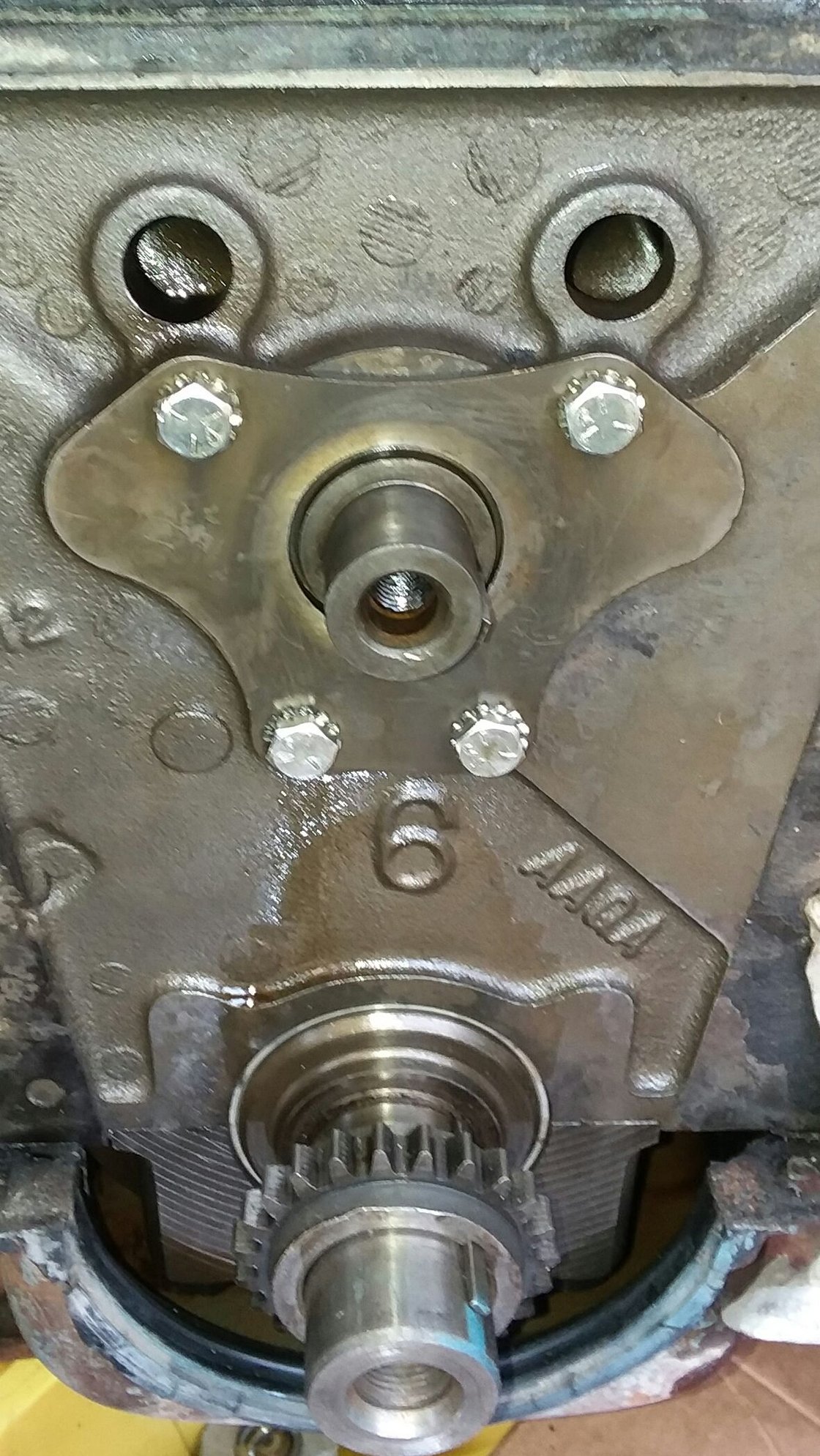

got one pic for now.... but also a question.... I bought an ac delco remanufactured steering box... and there is a bout 5 inches of play in the steering wheel. When I wiggle the steering shaft below the rag joint (replaced), I notice the worm gaer/shaft is the only thing moving -and it also moves up and down.
Would that be fixed by bearing preload adjustment at the top -or lash with the allen screw and locknut? Anyway -here is a pic so far (don't mind the bad paint on the brackets -gonna fix it)
