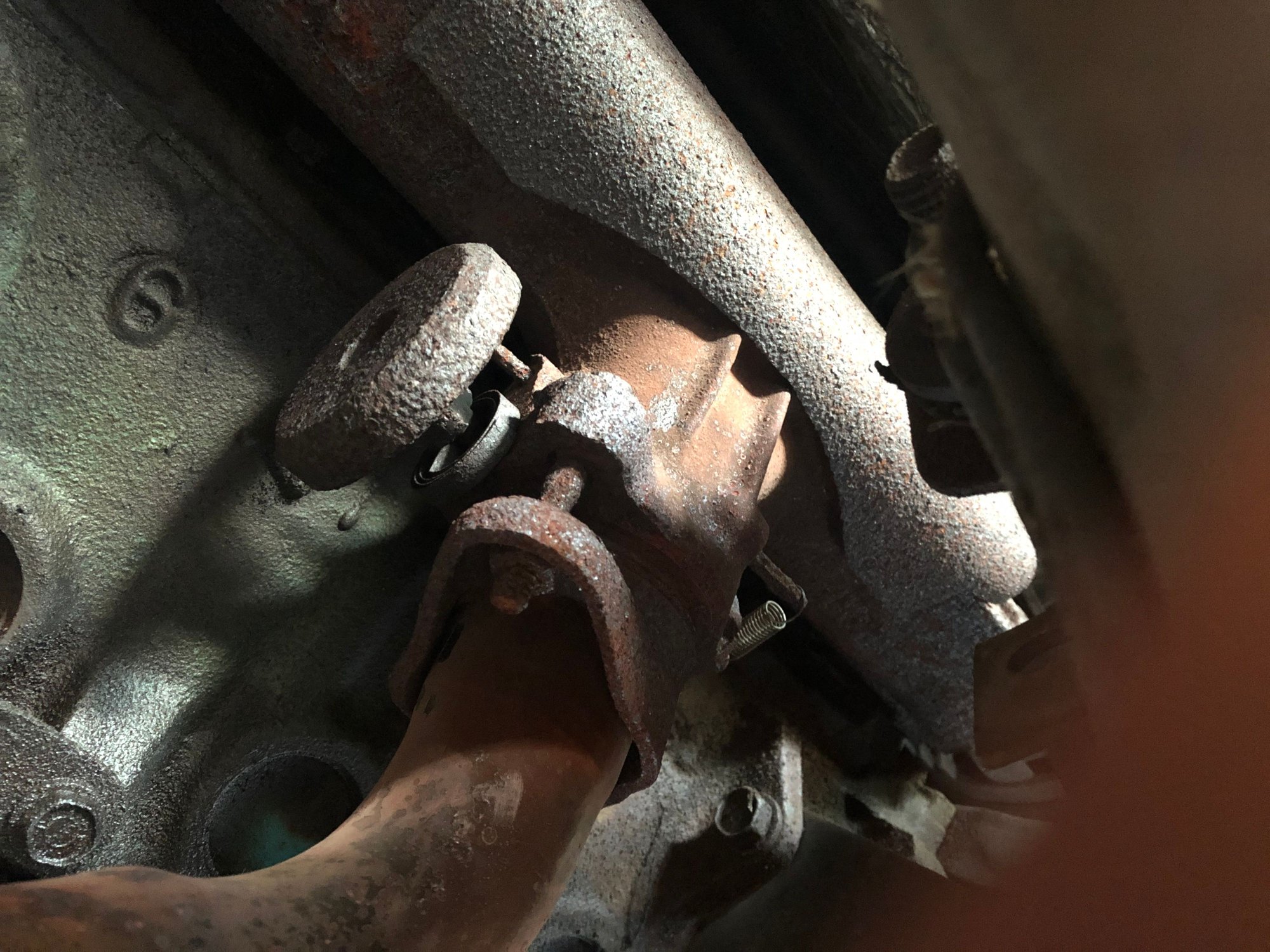

If the o2 sensor and catalytic converter have been removed as well as the vapor canister, is my engine alway going to miss when it warms up or could it be due to something else? I looked again and there is definitely nothing between the manifolds and the exhaust. Any idea where the wires would have ran too as maybe it is something I could add back. I don't see any wires hanging there, but if there was an o2 sensor it had to have run to something so maybe I could start from the other end. I guess I'm a little confused on what the 02 sensors purpose is on a carbureted engine.
Also have one more question, while examining the manifolds and exhaust I found this large know. Any idea what it's purpose is for?
