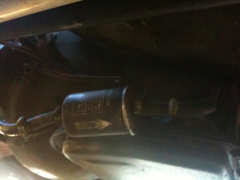

here's the pictures of the filter. It appears to run from the outlet line of the cooler to the tranny body. 67 Service Manual doesn't show the filter nor at the parts house. Any ideas?

Old Jan 12, 2010 | 04:58 PM
That is an inline fuel filter. If I were you, I'd remove it. If that clogs, it can cause some damage. Also, remove the pan and look at the filter and change it if you have not yet. Maybe even get a transmission flush done on it.

I've seen external tranny filters on trucks, buses, & even garden tractor riding mowers. They ALL have looked like an oil filter in shape / size & were ALL spin on type with a mounting base like an oil filter. I agree with whoever said fuel filter. That's what it looks like to me. You might be able to take the part # & mfg. to look it up to see what it is supposed to be.

I would get a longer piece of rubber hose ( be sure it is rated for ATF) and eliminate the filter. If it is indeed a fuel filter, it is not designed to handle ATF which is more visqous (thicker)
Rubber fuel line may disingrate when used with ATF. I would check all of the rubber line on the transmission cooler to be certain is is marked for ATF use.

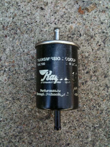

well it turns out that it was a in -line transmission cooler filter. I have no idea why someone would use it but hey i've done wierd stuff too. Pulled the filter, yanked the old line and replaced it with tranny hose. I did the "blow in the hole" technique and after getting red in the face a huge glob of grey muck blasted out of the filter. Gee, maybe that has to do with the hard shifting? Anyway, she runs oh so much better now.

I would at least drop the pan because who knows how much stuff you have in there too then.
Glad that the tranny is working better.
Old Jan 14, 2010 | 08:03 AM
recondotexas's Avatar
Joined: Dec 2009
Posts: 63
From: Sachse, Texas
I dropped the pan to check and change the filter adn only found very slight sludge in the bottom and maybe a dozen or so very small metal flakes. All in all better than I expected after 43 years.
