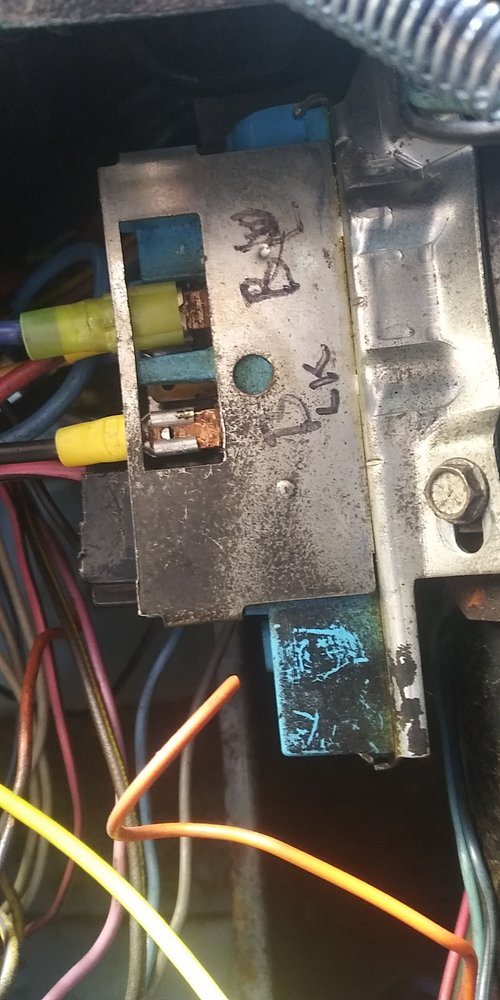

74 dodge d200 p/u. I have a short in the switch on the bottom of the steering column related to the ignition sw . Whats the name of that damn thing so i can buy another one. I watched a video where the guy was callin it an ignition sw but ignition sw to me is in the column. Mines blue. Its inline with the ignition sw connections but not the ignition sw itself. Thanks

Sounds like your talking about the connector?
Got a photo of it you can post?

Ing sw
I researched last night the column is out of 83 or so When i went to orielys website & put n a later mdl ignition sw it came up. This seems to b an addition to the column sw. Your thoughts cuz im not always right lol

That would be an Ignition Switch.... Has a rod that goes to it that pushed when you turn the key to the start position...

I got a ?. I keep buying a replacement ign starter sw that goes on the bottom of the column. It has a rod that comes down the column & snaps into the top of the switch . When you turn the key it slides the sw to the relevant posistion for starting. Every sw i buy from orielys is frozen seems like i snap the column lever into the switch but wont slide . am i missing something
Old Jan 6, 2022 | 08:53 AM
No.. Its a switch and spring loaded.... Only problem would be is if the rod is to long going down into the switch and bottoming out... Other than that... They are stiff...

I do understand what u r sayin & u r correct. The 1st thing after install on the 1st one. I was wondering why is the spring loaded mechanisim not sliding on it. I took it off & manually inserted a tool n the slot where the rod snaps in and it was frozen. I took it back & got another one. Before i even installed the 2nd one. I took a little screwdiver put it in the slot where the rod snaps into. and same thing. With all the force i could w/out breakin it. Same thing. Wont slide. Thats what the the hecks confusing me. One person outside the forum mentioned a some have a pin lock? I know it cant b this hard theres something im missing. Ive been all thru the truck n 11 yrs. 2 tranny swaps. 2000 $ worth of ball joints upper lxr control arm bushings idler arm center link. Ran all new wires thru the 5 pin in the ign system. Now i have this 19.99 cent starter sw confusin the hell outta me lol

Thats def. the right video & its exactly my application. I thank u and apprecite our conversation. I do believe now that u have mentioned it it is a gm column. Ive done exactly what the video shows. 3 times now. But..... My problem is still the same. Every sw ive bought so far which is a total of 3 times. Once the 1st time after installation i went to turn the key & it wouldnt turn as normal. Took the switch back off and put a screwdriver n the hole and manually tried to slide the switch on the bench. It wouldnt slide like its supposed to. It was frozen..Took it back got another one. The next switch i bought before i even installed it i took a screwdriver put it n the slot it wouldnt slide. Got a 3rd one. Same thing. Wouldnt slide. This is before installing it. I bench tested before trying to install it. The switches ive bought so far 3 of them. Its the exact same switch wont slide like they r suppose to as a normal function. I dont get it. Theres still something im missing.

As for you switch issue... Try an different brand, Maybe like a Napa or something...

Update. I should have known it was that simple. Most of those. Prt # us91 switches have a pin lock on them. Its the plastic button looking piece u pull it out so the switch can slide. I guess somekind of safety feature so to speak. Once again over thinking a simple problem. But, i did learn something & mayb if somebody dwn the line runs into the same problem hope this helps . Thanks for all those who responded to my dilema. All advise & videos everything did help me . Thank u. I wish i had a pic ill post when i can. Thank u!. And thank u Car Quest on Tulare Street Fresno.
