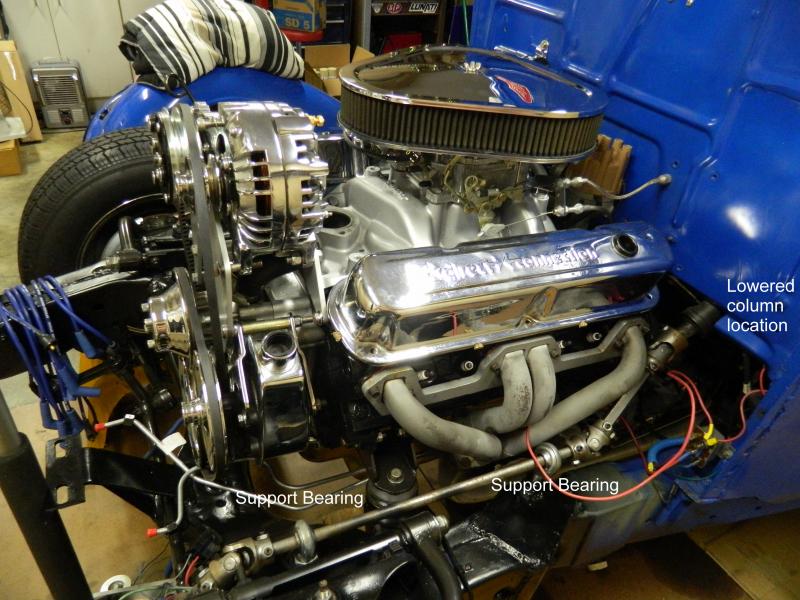

Dan I know exactly what you mean, I have 3 on mine. Mine doesn't bind up though, do you have bearings on yours? I have two on mine and it doesn't flex around any at all. Also does your column come out in the stock location? I did drop mine so that it comes out in the toe board instead of the firewall, it got in the way of the exhaust in the factory location, that may also have something to do with it. Give me some time and I'll dig up the folders with some pics in it.

Dan you can see the support bearings on my column and how I lowered the location where the column came through from the firewall to the floor.

Thanks to both of you. The steering is the biggest "bug" I have to work out before I move forward to completing this car. I think the column that they used in it now is from a Dodge Diplomat. I am thinking about getting one from IDIDIT that would allow me to lower the exit point as you did and include some support bearings too. I just got the car and promised the better half I would complete some other projects before starting this one.

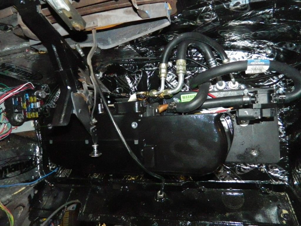

Vintage Air Compac II installed and plumbed. Itty bitty car...

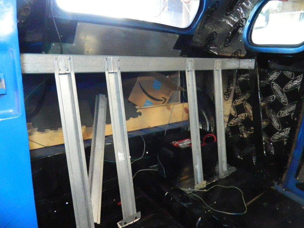

Framing for the rear shelf. It's amazing what you can do with building materials..
All done except for upholstery.

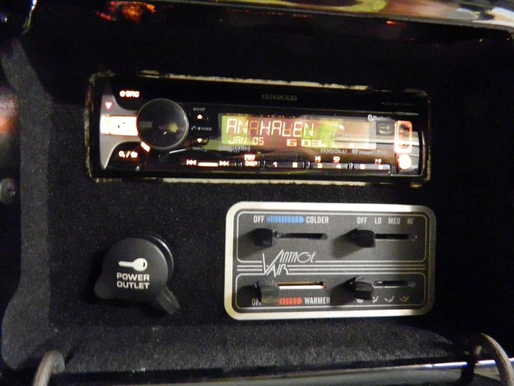

Had a friend in the hvac business make me the glovebox insert, then hid all of the accessories inside. All that's visible in the dash are the gauges and the headlight switch.

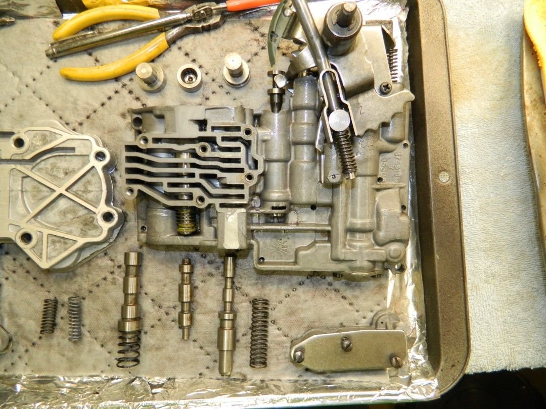

Neck deep in transmission mods. No matter how many pics you take you're always wishing you had taken one more..

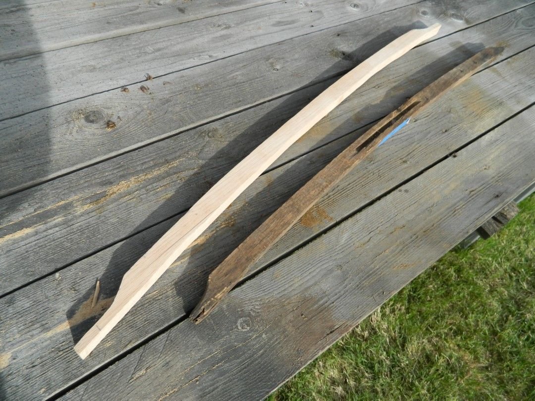

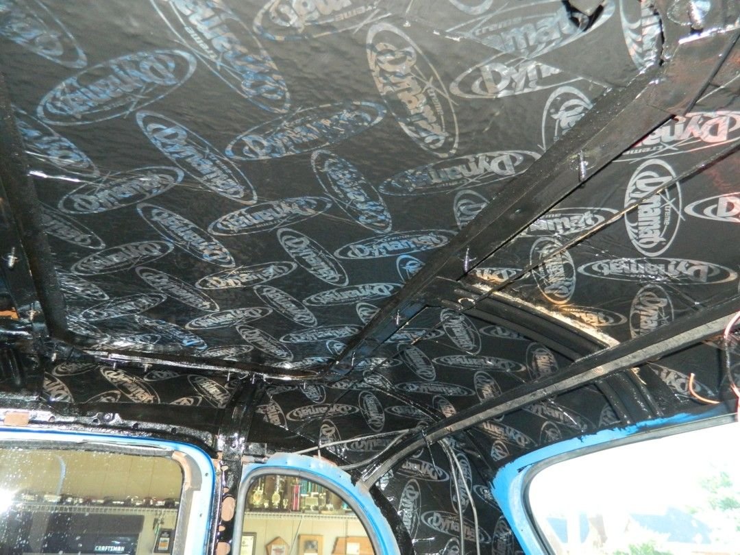

The original oak headliner bows were in pretty bad shape so I made new ones.

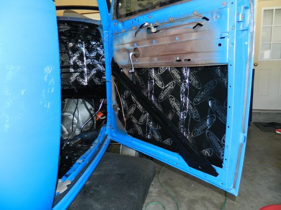

Dynamat
More Dynamat
