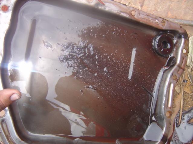

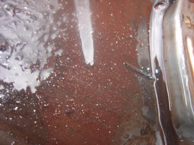

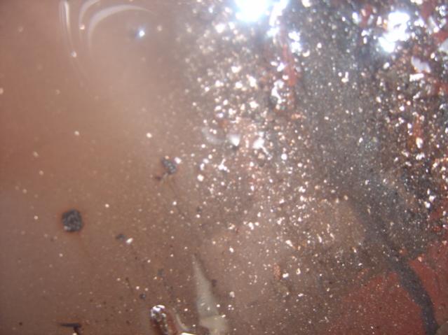

Hi i have a 73 dodge power wagon w200, it has a 360 v8 hooked to a A-727 trans but i dont know why the trans will act weird.the engine will rev up alittle and then the trans will kick in and it will keep doing that. it has fluid.And today i went out and moved it. reverse work perfect but when i put it in drive it didnt even move and it barly moved when i pressed the gas

drop the pan and if it has a thick mud-like substance, that is the material from the clutch frictions. The key here is that it goes into reverse but not into drive. reverse uses a different drum than forward.
ouch.. time to start looking for another transmission..

By the pics, I'd say that it would need a rebuild. You can try to clean out/replace the fliter and clean the pan, put it back together and see what happens.
