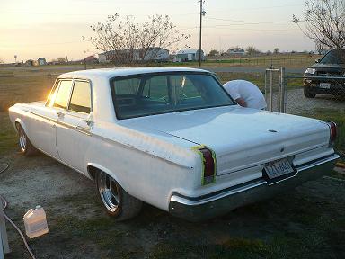

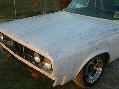

well i started the paint process today. Me and my brother got it all sanded down and layed down the first coat. Tomorrow we will be wet sanding then put on coat 2. This took all day today, its ALOT of work, especially removing all the chrome trim it has. Heres some pics of it now.

Old Mar 21, 2009 | 07:27 PM
johnthegoalie's Avatar
thinkin with me dipstick
Joined: Feb 2009
Posts: 930
From: sw desert
looking good - how are the arms feeling?

are you painting it with rustoleum? if so , that looks good...can't believe it actually.

yeah im using rustoleum gloss white. I sure hope this good weather holds up for atleast a week so i can finish. all the supplies actually did cost $98 like hotrod mag said. Does anyone know how to take off the middle chrome pieces on the doors of the car because i could figure out how to so i just taped them off but i would like to remove them for a better coverage.
