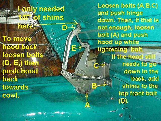

There is a big gap at the back of the hood on my1962 Dodge pickup, how do you fix this? I've tried new springs & adjusting all the bolts in every position possible & there is still a 1 inch gap.....Tried doing what it says in this link but it doesn't seem to help much: http://www.sweptlineparts.com/images...Adjustment.jpg

Can you elongate the holes in the brackets?

Ya, I think I'm going to have to make the holes a little longer with a grinder or something, because nothing else seems to work...
