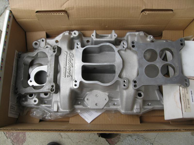

What spacer did you use?
The one to your right will have a leak at the seconders on the choke thermostat side or passenger side.

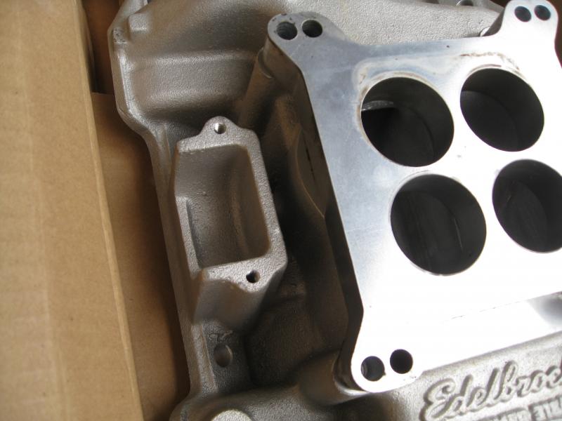

If you can see the black line between the spacer and the intake. That is where the leak will be...

Thats a spread bore intake....
Attachment 8993
Attachment 8997
I currently have a normal square bore spacer but an not see any gap at all. I will get an adapter and try that in the next few days

The one on the left is the spread bore (intake) to square (Carb) Flange adapter. It will fix most 4150 or 4160 carb fitting issues.
Good luck.. Keep us posted..
