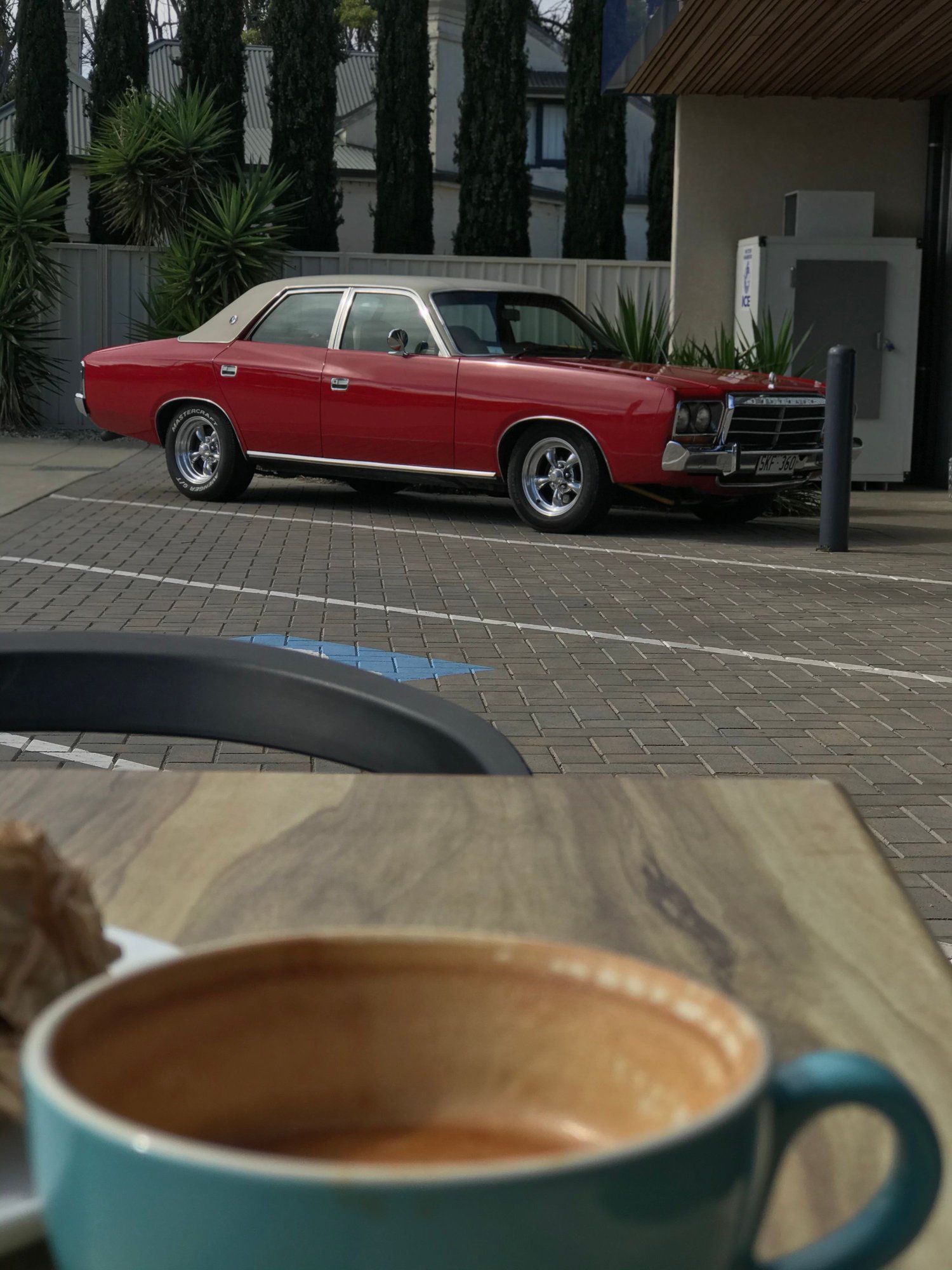

Old May 5, 2021 | 02:47 PM
Shano's Avatar
Joined: Dec 2020
Posts: 41
From: South of Adelaide
Originally Posted by Archer
Shano -
Just curious, what car?
They might be fine, just curious.
Archer
hello.
my car is a 1980 CM CHRYSLER VALIANT 318/727
Old May 6, 2021 | 06:08 AM
Archer's Avatar
Posts: 1,889
Likes: 170
From: Long Island, NY
Shano -
Nice ride!
Use the calculator and determine what rpm range you want to be in at what speed.
That will tell you the best gear ratio.
Assuming the motor is fairly stock, if the car sees a lot of highway driving with those tires, I'd be a little hard pressed to change anything.
2400 - 2600 @ 62 mph is a pretty good compromise.
Archer
