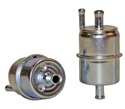

Use Wix 33040/ 33041 filters, they are 5/16--3/8" fuel fittings respectively, and have a 1/4" return orifice built in.
You can mount them vertically or horizontally, just as long as the 1/4 fitting is on the "top" side.
