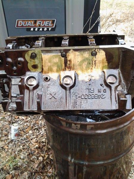

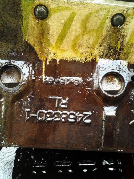

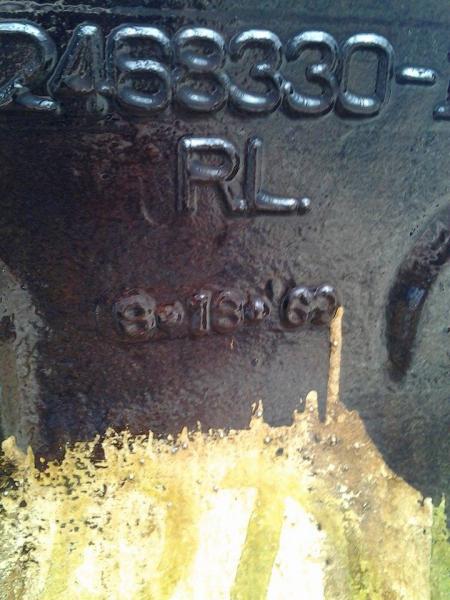

I have a 69 hemi I bought about 16 years ago. I am trying to figure more out about the motor there is more than one A stamp on it I will post the pick if anyone can tell me anything about it I would appreciate it.
Attached Thumbnails help pls1  69 hemi have questions about-hemi7.jpg   help pls1  69 hemi have questions about-hemi4.jpg   help pls1  69 hemi have questions about-hem1.jpg   help pls1  69 hemi have questions about-hemi6.jpg   help pls1  69 hemi have questions about-hemi5.jpg

my chrysler factory service manual 1967 coronet charger. shows that letter 'A' stamped on the 'TOP PAD - FRONT OF ENGINE' means .020 O/S cylinder bores. or it could mean something else. a diamond stamped on same pad means .008" O / S tappets. all so cyl bore std sizes "A" =4.24975",,,,"B" = 4.25025" ,,,,"C" =4.25075",,,,"D" =4.25125",,,,,"E"= 4.25175". this is for piston fit. NOTE: this is for very fine fitting the STDANDARD bore size. very few engines from ANY factory are fitted to such fine increments. the "A" and so on letters may be cast or stamped on the pistons. i have seen a 72 440 with .010 cyl from the factory. and can NOT be bought from chrysler. many of the early hemis i have taken apart had paint letter marking on the pan rail, but i think the fit was not as fine as the 426 hemi listed in 1967 factory manual i have. please note iam NOT a hemi expert.

moe 7404 its standard bore I checkd it bk in the day ,it also has W.T stamped under the A and diamond , so y do u think it was water tested ,those are the only numbers on the block ,its never been in a car
