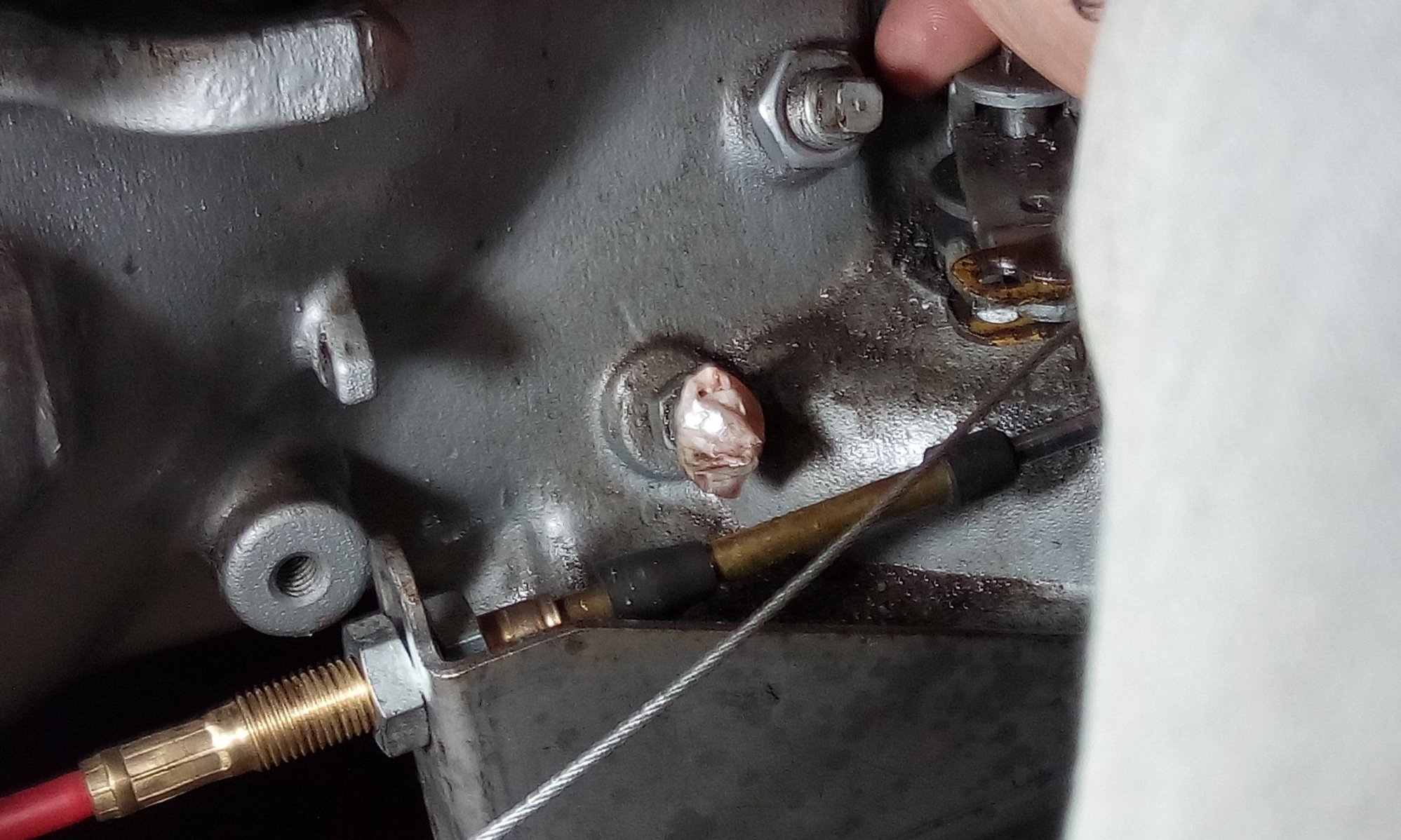

I live in the south of Brazil, I am the son of a mechanic and we are restoring a 1952 Dodge Wayfarer. We have difficulties with regard to the gearbox of this car(Torqueflite A-727), there are 2 oil outlets from the box that we do not know where they are connected, I am looking for material (manuals, datasheets, etc) but it is quite difficult. I believe there is an oil radiator from the box, and the connections are for this purpose. Can anybody help me? And sorry for my weak english.Thx
Here is a picture of the oil output clogget with paper piece.

Those are for adjustment of the bands...

http://www.mymopar.com/index.php?pid=525

Ohh thx, this video was very usefull to me. Thx
