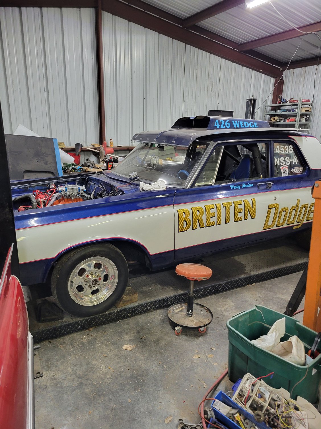

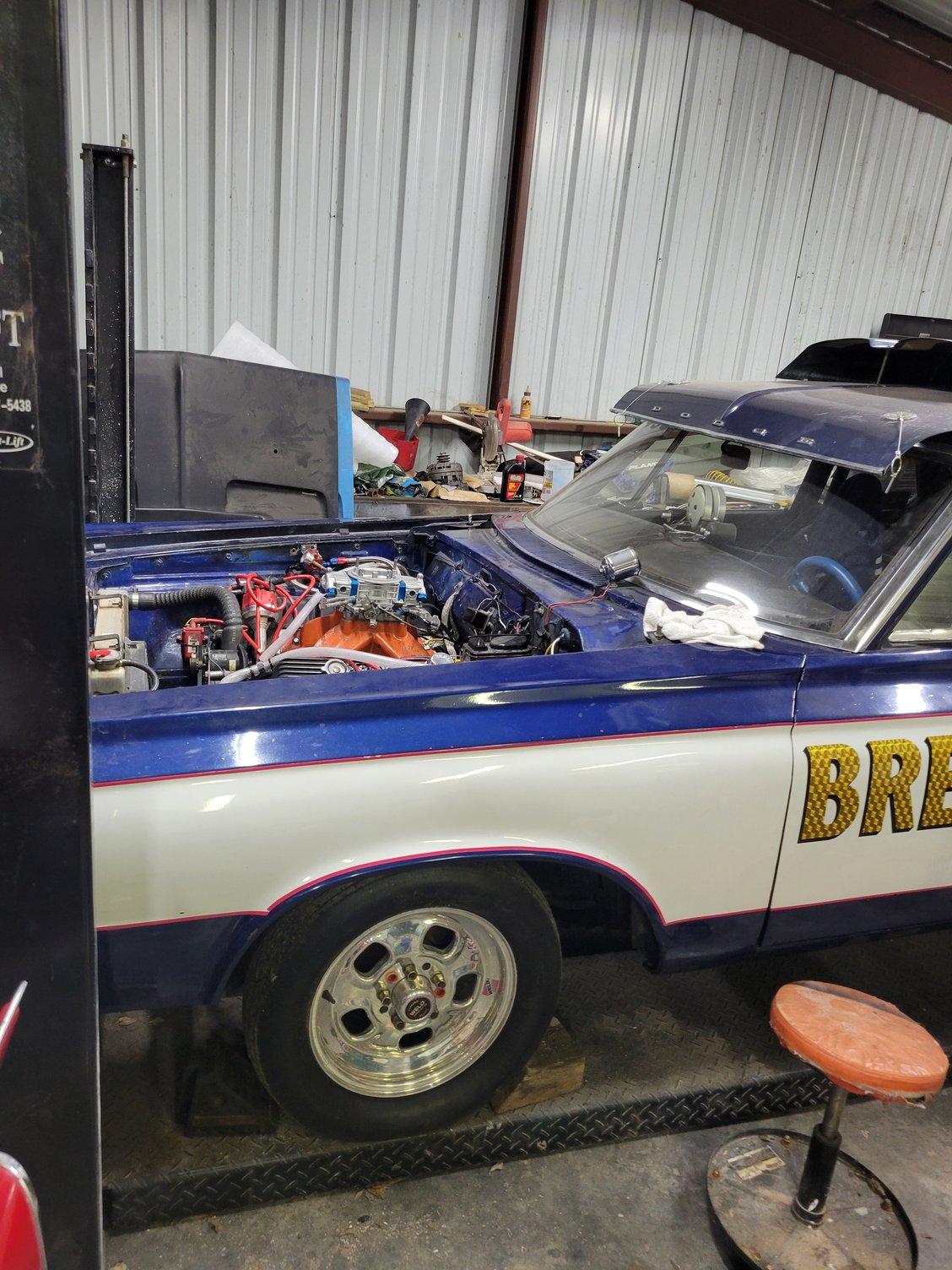

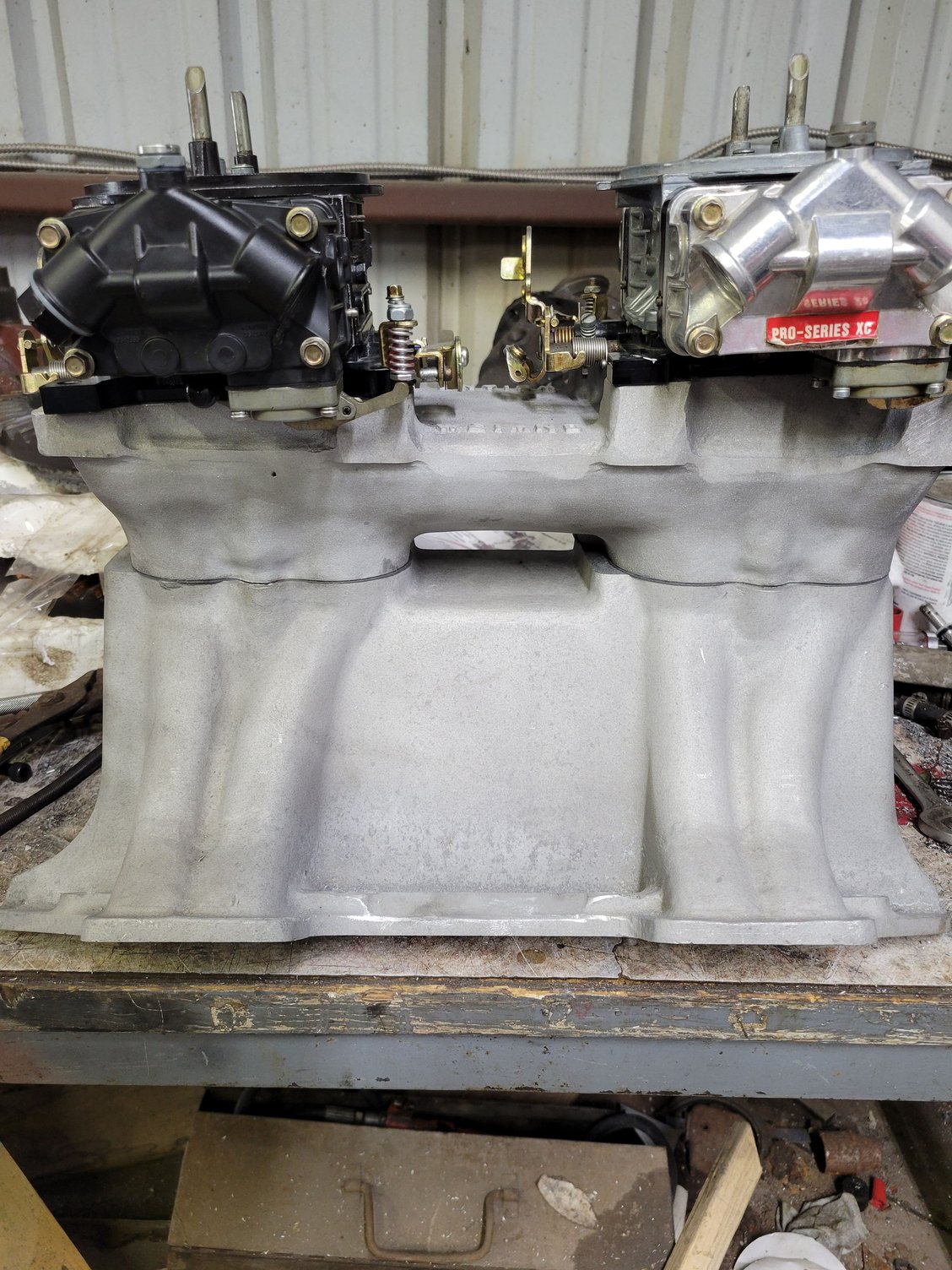

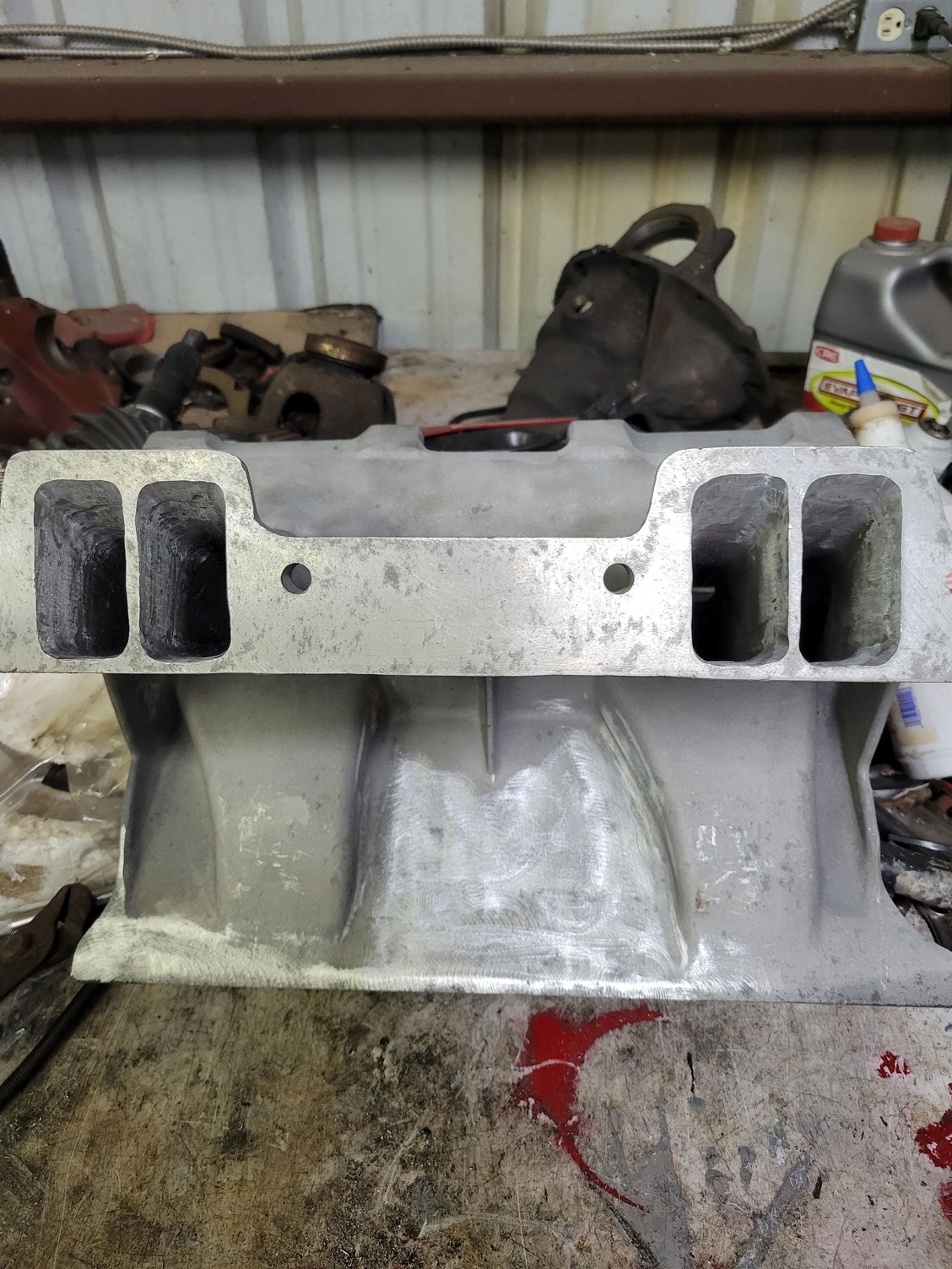

Do you have photos of your project?
Old May 31, 2025 | 01:59 PM
  #25
Wes Breiten's Avatar
Joined: Jan 2021
Posts: 18
Tunnel ram pics
Old May 31, 2025 | 02:05 PM
  #26
Joined: Jan 2021
Posts: 18
Tunnel ram

I agree but your point of wanting someone who actually has experience with your combination would probably be there.
I will say that the only thing I have experience with in your combination is the intake on a street 440 back in the 70s, it worked great and that’s my point. It was developed in the early 70s for pro stock cars that were little more than super stock cars with a tunnel ram and two carbs. I hope your port work helps hopefully you can work on the top of the runners also.
good luck with your project it looks great
