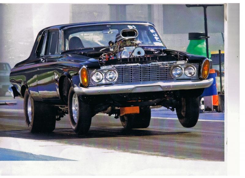

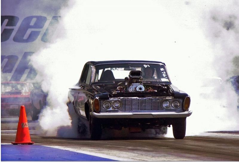

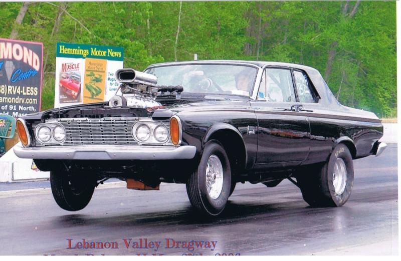

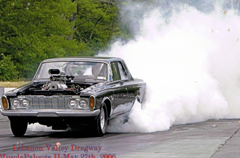

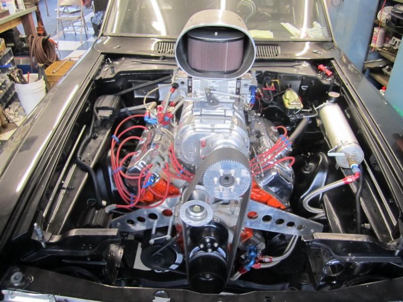

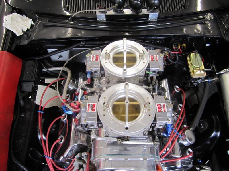

1963 Plymouth Belvedere with blowm HEMI
My junk weighs 3750 with my big butt in the seat.Powered by a 545ci 2nd gen HEMI.MOPAR meablock,Manley rods,Callies crank,diamond pistons.Milodon duel line prostock oil system provides the lube.The solid lifters are pushed by a comp cam under .700 lift with nextek springs.The '68 iron heads are barley bowled and not port matched to the BDS intake that supports a BDS 1071 stage 3 supercharger.Running underdriven with 5 lbs of boost on pump junk the car goes 9.9's in the 1/4.Fuel is fed through a pair of Pro Systems SV1 1180 cfm carbs topped with a BDS polished scoop.
Torsion bars up front with Caltrac springs & bars.Ignition is fired from a Holley Pro Strip annialator.You all know I have been street driving this thing for over 25 years wher it has morphed into what it is,,,,,whatever that may be
