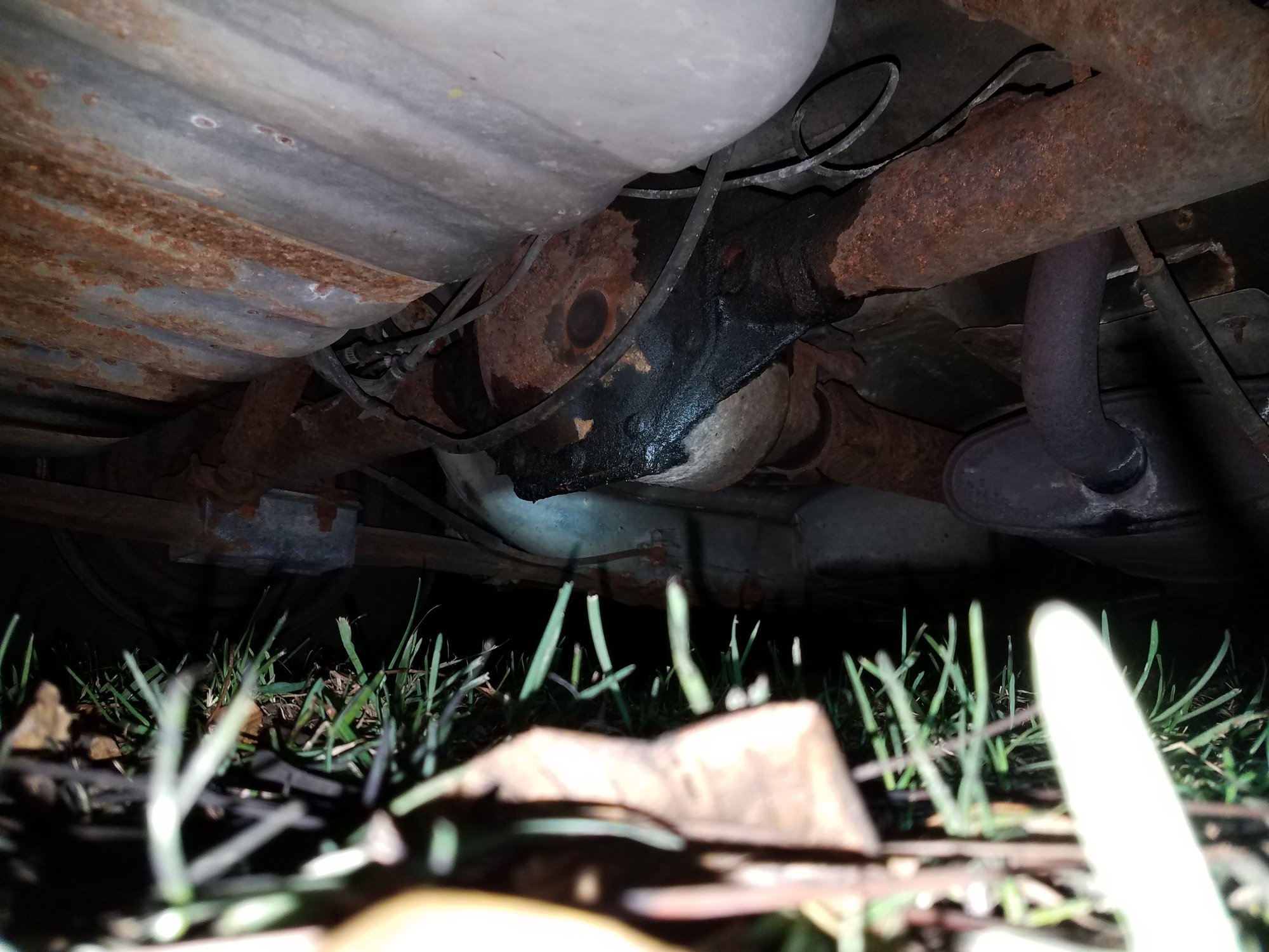

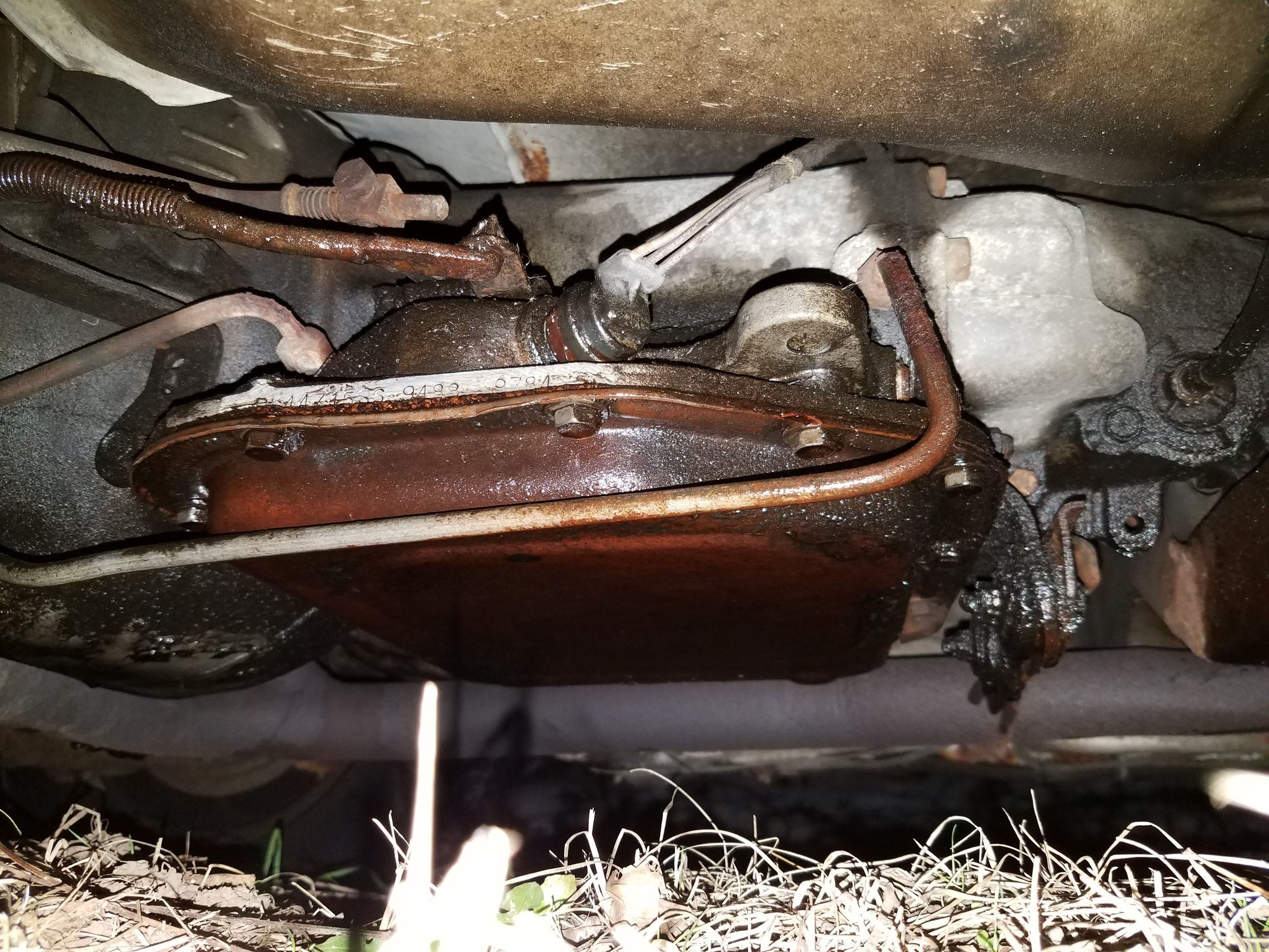

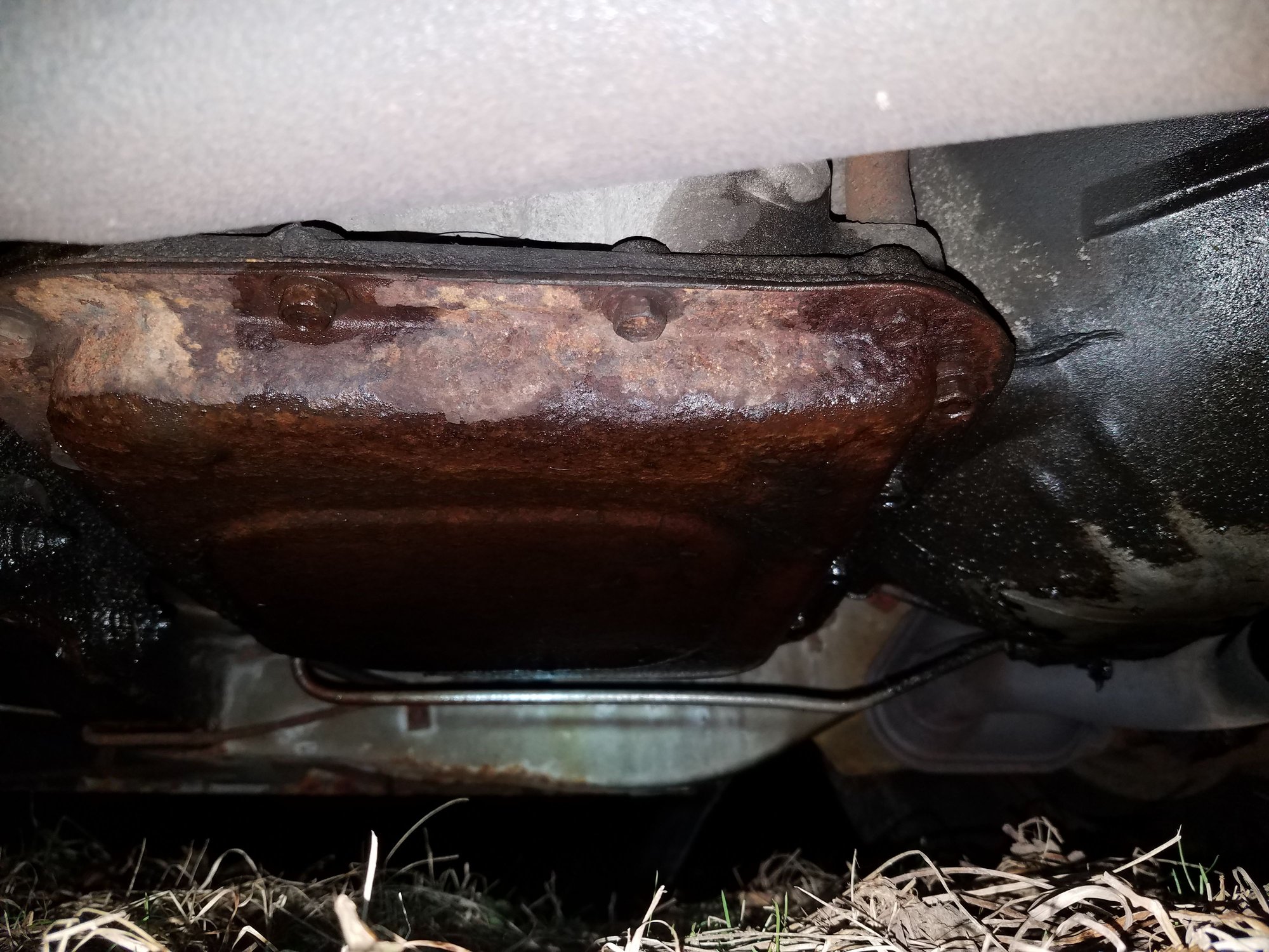

Just some dirty crap. Can anyone tell what trans this is? And iem guessing this is a 7.25" diff
Old Nov 19, 2018 | 07:13 PM
Your correct on the rear axle and you need to check the fluid level in it and if memory serves me it holds less than a quart of gear lube. So fill it up.
noted; will be doing so shortly when i replace gasket. Hope it hasnt been cooked. Would be cool to open it up and find sure grip hahah
