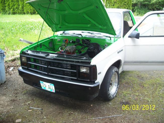

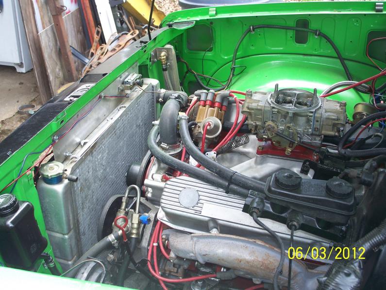

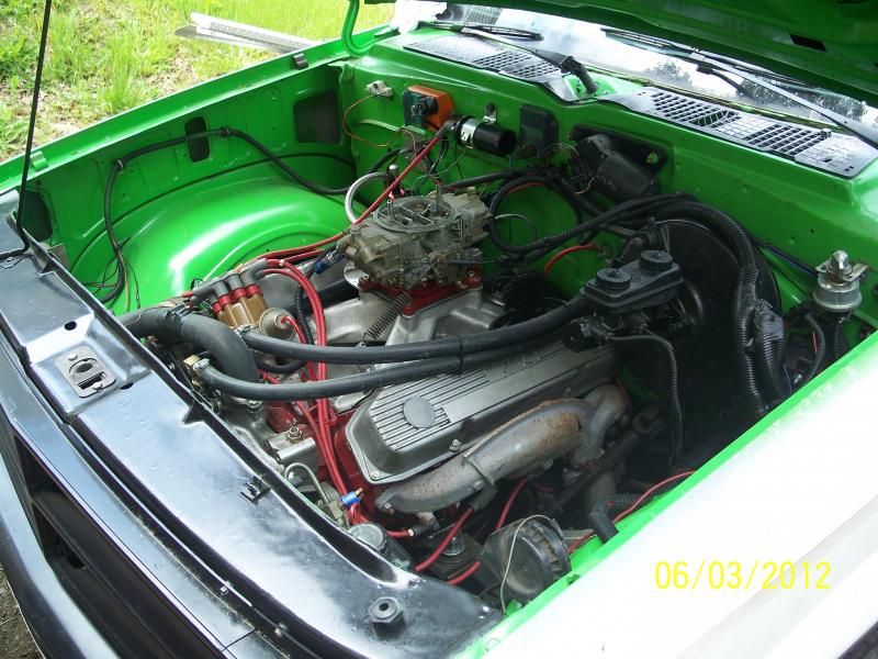

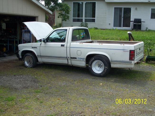

1987 big block dakota
383 t-flight 2800 stall 3.75 with 3.91 back halfed 4 link coils. Still a work in process[

What did you do for suspension mods to the front? Are you using coils, coil overs or air bags in the rear? Straight w/panhard bar, single or double triangle 4 link? How tight is it to get a BB motor in there?

1000 pound springs up front 4 bar in the back with 150 pound springs on the coils wih a panhard bar to keep it all in place. Used a truck rear sump oil pan on the eng. and made a 2 inch cut out on the k frame that i boxed in.
