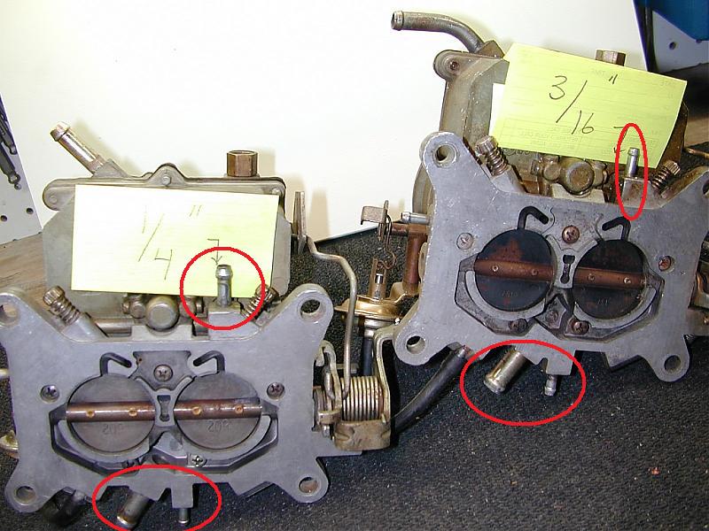

Its a 2v but the port locations are pretty much the same, hope this helps

thanks guys BIG help i found the ports the large port in the back is going to my master cylinder the pcv also goes to the master [is that correct ?] the small port is capped off i dont know why or where it should go oh it is a edelbrock intake not sure which kind

The two "T" 'ed together is ok, myself I like to keep them seperate - your intake should have a capped off hole in one of the runners, I like to run the booster from here and the capped off small port is ok and normal, the old old motors only hade 2 vacuum lines on them, 1 to the advance & one for the windsheild wipers - try that system going up hill in a rain storm lol the good ol'days - the extra vac. ports are just to make the carb fit many diffrent engines with diffrent vac. needs
