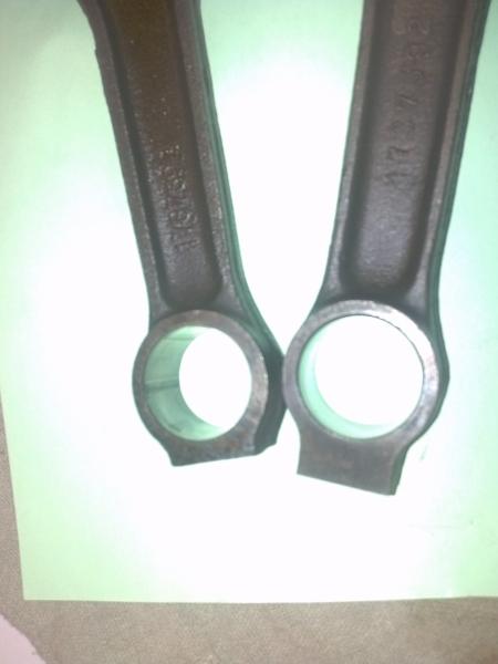

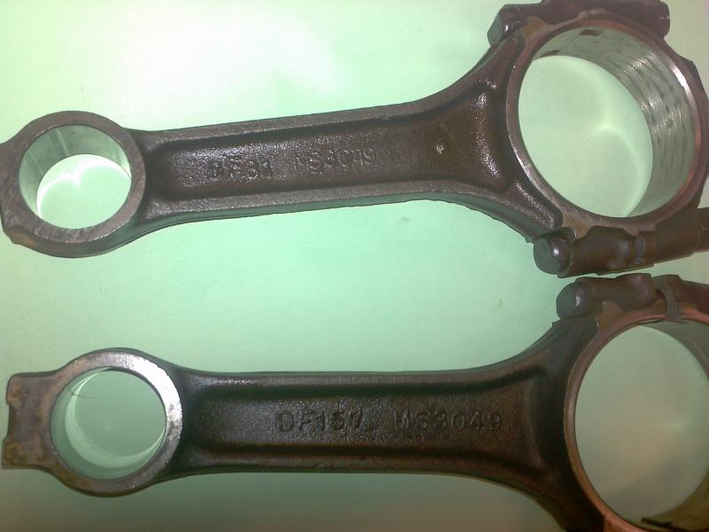

I have to get new rods. Have 1737692's but 2 of them have DF81 on them and the rest have DF157 and have more metal. I looked them up but the DF numbers did not come up at all . any info would be great. And if anyone knows of a place to buy some rods that are not $400 that would be great.

wouldn't the 440 rods be longer . I found a set on eBay for $47 that fit a 440 if thous would work I'd get them . their new with ARP bots. thanks for the offer thought.

New rods with arp bolts for $47 ? I wouldn't trust that. If your wanting to replace rods for a B engine then I would get b engine rods. you could possibly use RB rods if you can find a piston that will work for stock stroke although I'm thinking the connecting rod journals on a RB are larger than on a B engine.

Yes i was reading that you can use 440 rods with a smaller compression hight 383 pistion and 383 crank. I think it was $47 each.
