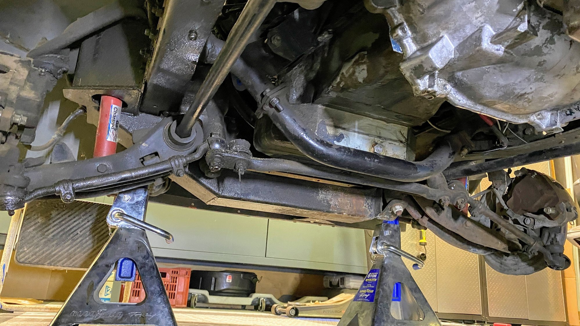

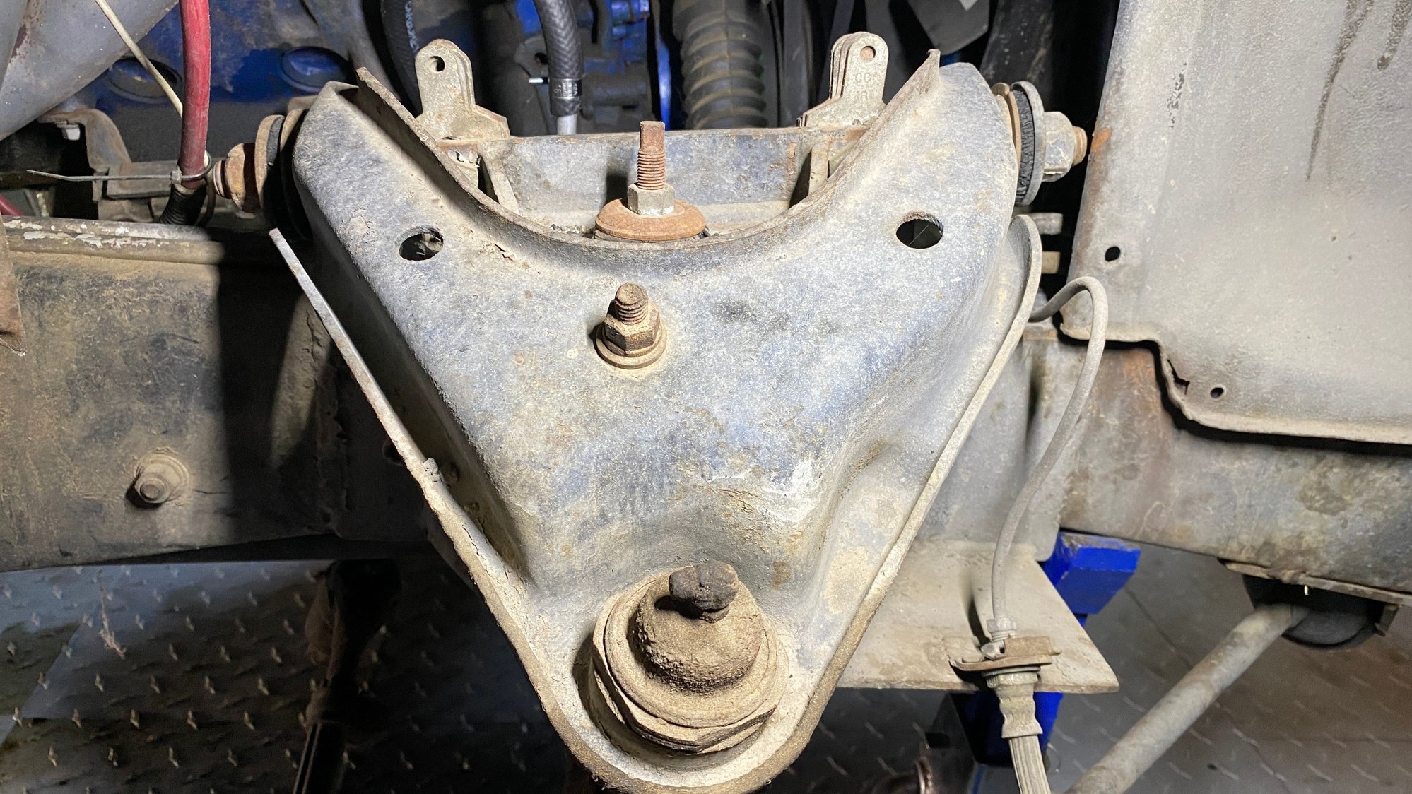

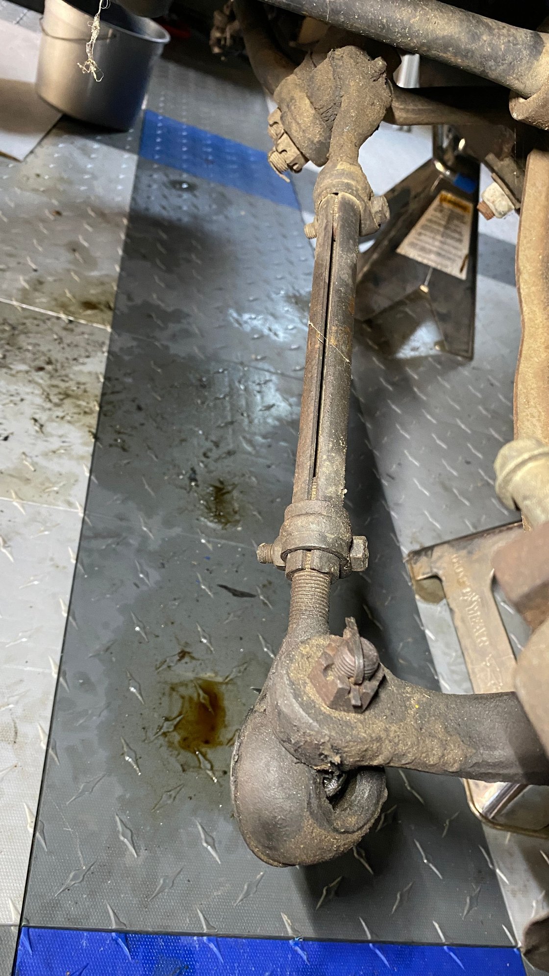

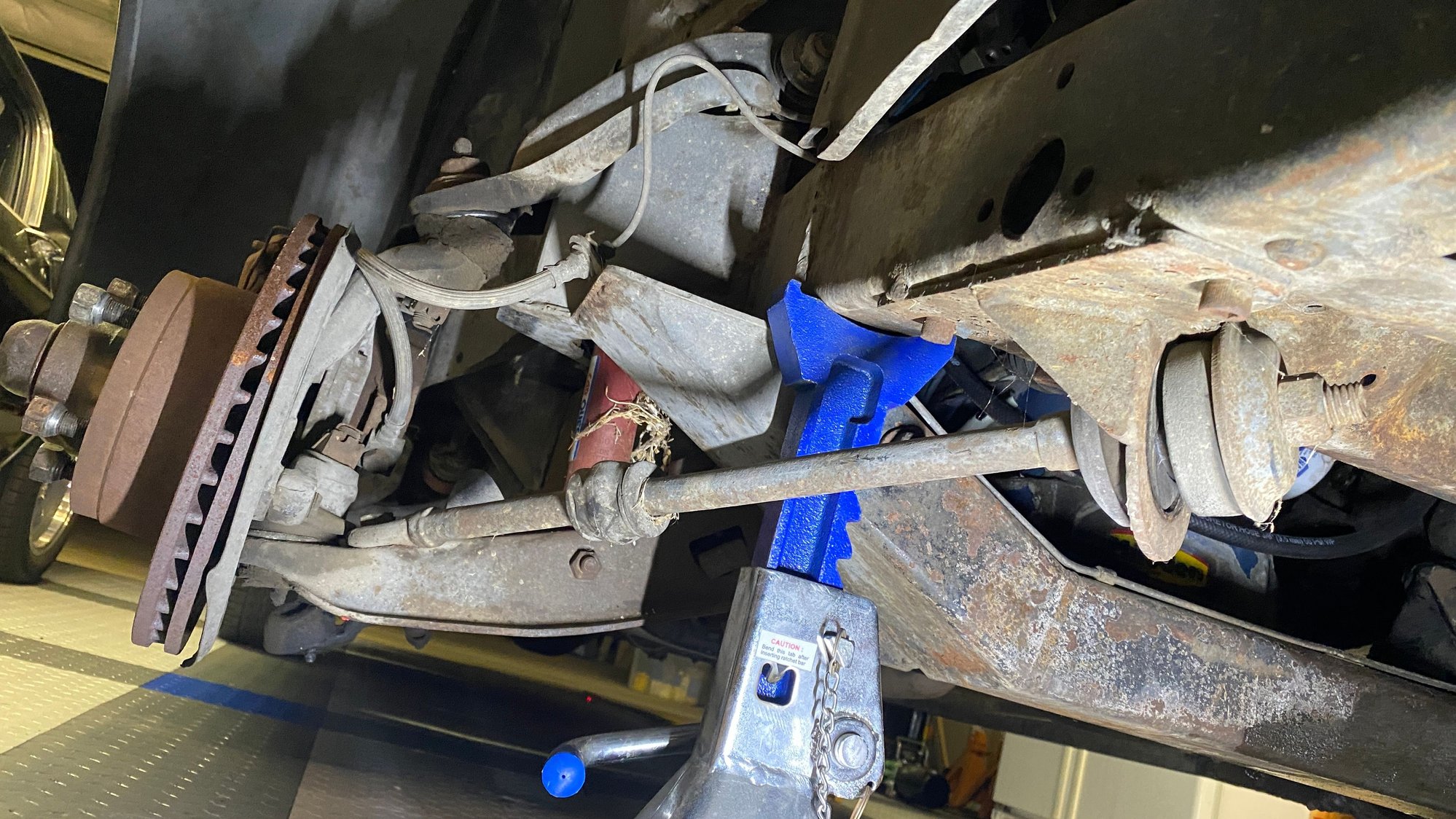

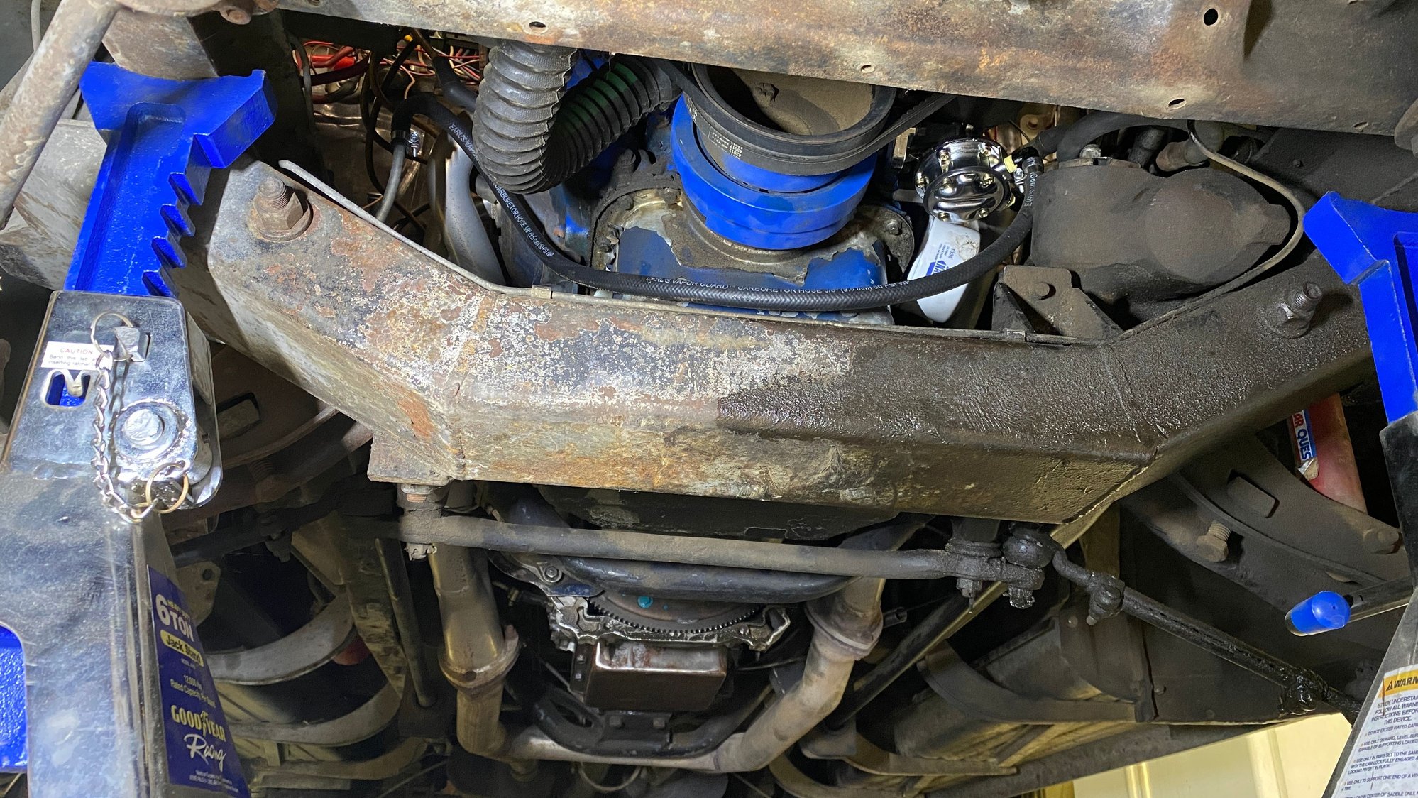

Hello,
I hope it's OK that I am a Ford owner on a Mopar forum but I am in need of some assistance as I try to rebuild the Mopar steering/suspension IFS swap in my 1950 Ford F1. I don't know what the donor car was and am having a hard time determining how to source replacement components. I have googled and looked for pictures that match what I have but figured if I came to the experts I might have better luck. A friend of mine said I have a Frankenstein set up because the the subframe/K-frame looks custom but he said the rest of the set up definitely is Mopar. I have longitudinal torsion bars, the strut bars attach to the top of the lower control arms and the tie rod adjusting sleeves I believe are 11/16" if it helps. Pics attached as well.
Thanks in advance, Greg
engine crossmember
strut rod
view from rear
upper control arm

Shot in the dark.... But it looks like 1967 Dodge Coronet 500 front suspension parts to me....

Note: look at this build... Scroll down to the suspension and you can see it looks close to your parts.... May have to take some measurements and photos with you when looking for parts...
1967 Coronet 500 "YANKEE EXPRESS"
