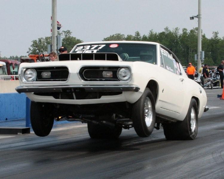

Let start by saying all my comments are related to race only motors.. Gas mileage is something we don't talk about. At app 3 gal to the mile and $10.00 per gallon you see why......
I have owned and raced both.. Let's start with the 340 sb.... Started with a R-3 race block and put a 3.75 stroker crank in it... GRP alum rods and Bill Miller pistons... W-2 steel heads and a Comp roller cam. Offenhouser intake and 1050 dominator carb... This was in a 70 Duster that weighed in at 2500 lbs... Had a 904 tranny and a dana 60 rear with 456 gears. Best time was 9.85 @ 138 miles per hour......
The 400 is in a 68 Barracuda. Its a stock 400 block with a 440 crank in it.. This gives me 451 ".... Cheap inches!!! I run eagle rods and pistons by JE... Isky roller cam and Indy Alum 440-1 heads and intake. Quickfuel 1050 carb... The barracuda weights in a 3500 lbs and best time to date is 9.95 @ 139 miles per hour.....
So both can be built for power as both engines have app 700 hp. So, either one will work.
The tranny question is easy to answer..... The 904 tranny will not fit a BB. The 727 comes in two cases... One for BB and the other for SB. You asked about the length and I do know the 727 comes in a couple of different lengths.. I think the longer ones were out of trucks.... Once you decide on which engine the tranny is easy... My opinion is you can't beat a 727.......
Attached Thumbnails Stroke it or go big?-car-right-front.jpg   Stroke it or go big?-copy-motor-right-2.jpg   Stroke it or go big?-sgmp062009email-1-.jpg   Stroke it or go big?-motor-5.jpg
