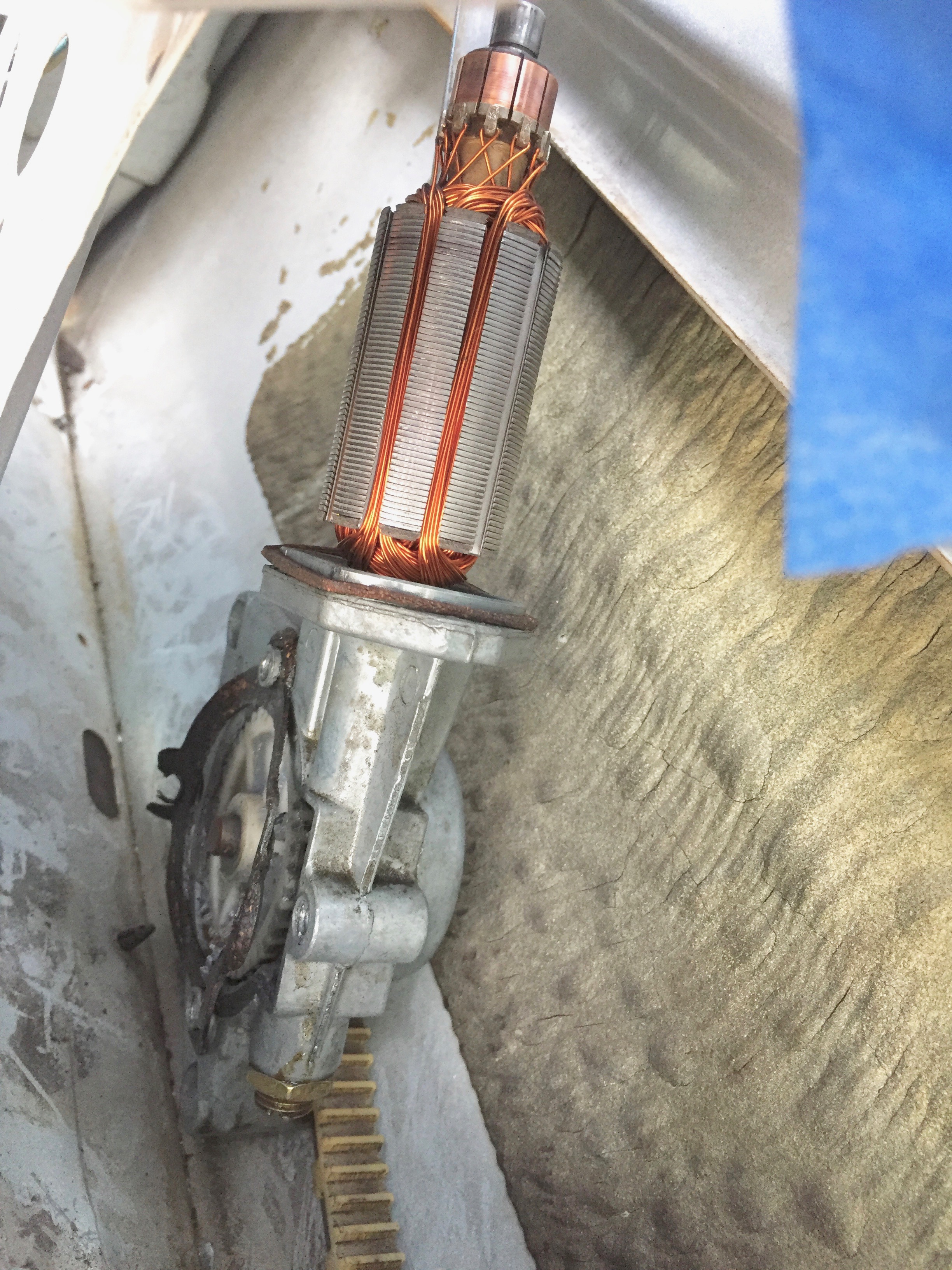

After wrestling with the window lift motor/regulator assembly for an hour, I
decided to dissect the motor while it is still in the door and still attached to the regulator.
Window was taped to closed position to prevent it from dropping down on my hands.
Bad idea to dissect the motor:
I backed off the cover to the electric motor (2 screws) and found to my dismay that it contained the spring loaded armature contact brushes. Both rushes and springs popped out.
That is a separate issue to address.
Still trying to remove the lift motor/regulator assembly, yet something is securing it inside the door panel so that I cannot rotate the lift motor/regulator assembly outward.

Success after loosening the window glass 3 attachment bolts , size 10 mm .
Removed the 2 bolts that were most forward on door.
This provided slight wiggle room.
Why?
Also, removed the single 10mm bolt that secures the white plastic flex track that resembles railroad tracks. This was probably the key step.
This bolt was located at top of middle of the door and was visible when you peer through a hole in that area. I could not fathom how this was critical as visibility of the area was limited. But, it seemed to work.
Success in rebuilding the electric motor brushes and springs and washer that popped out of the motor housing .
This required using two pairs of tweezers to clamp the brushes and springs to the side of the housing as I carefully slid the rotating armature between/ through the brushes.
First, the springs were compressed with the aid of a toothpick to force compress each spring.
Then, another toothpick and tweezers nudged the carbon brushes into their square compartments where they reside. Delicate hands.
Then, a tweezer acted as a clamp to hold the compressed springs/brushes in place.
Very lucky.
Motor showed continuity and freely spun when 12v applied.
Held my breath on that one.
