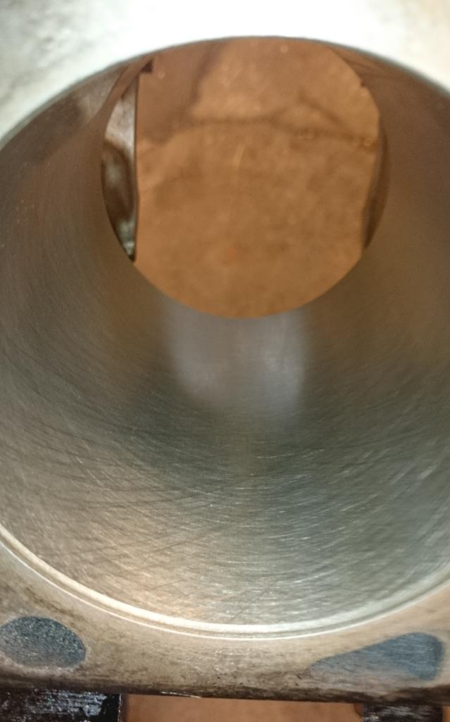

Alright, I now have most of the parts for the engine build.
I deglazed the cylinder walls using a flex hone.
The cylinders seems to be in pretty good condition, but I have some concerncs regarding them being tighter in diameter in the middle of the stroke. The biggest difference seen from middle to top of the bore is .0015". I do have a portable rigid hone, so I might try to straighten them out.
The crankshaft has been sent off for rebalancing, and the cylinder heads has been sent off to get improved valve seat angles.
