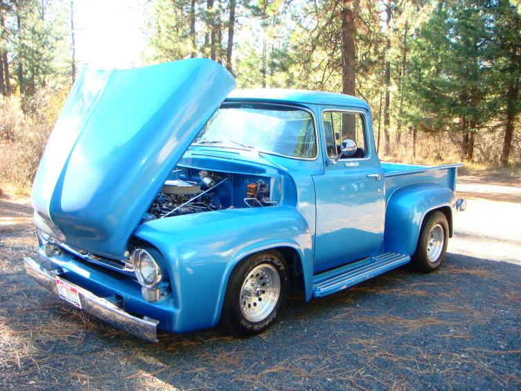

Scroll down on that Edelbrock link and you will see the intake manifold That I have #7577.I put in a brass Tee and called it good. Now I'm dealing with a broken oil dip stick tube. Broke off in the block.My first attempt to remove it will be using and easy out.I would welcome any feed back on dealing with that. This is my Fodge.

After removing the alt and fuel pump I was able to extract the broke off dipstick tube with a #4 easy out. Came out real easy. Next project will be kick down linkage.
Old Nov 17, 2014 | 07:59 AM
Good work.
