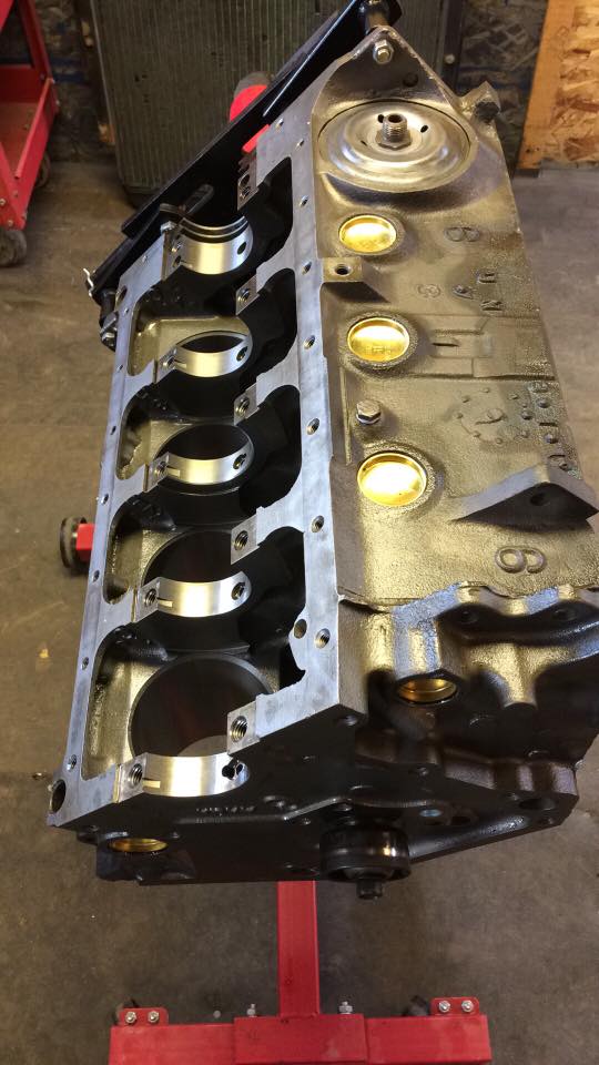

Putting my 74 360 together got all my freeze plugs in and oil galley plugs except the one under the rear main cap as my kit did't come with it (not happy)
So the oil galley plugs are
2 in front behind cam plate
1 under oil filter plate
1 inside near dist bushing
3 in rear
1 under #5 main cap
Also does anyone know the factory specs for oil clearance for Mains & Rods?
Getting plastigage tomorrow to check.

I don't understand what hole you are talking about Any pictures ? The dist drive gear goes thru a hole ?? in the rear main

This one!
The oil filter bypass plug. Directs the oil to the filter.
That's the one even tho i can't seem to see any hole in the under side of where the plug go's my 87 block has it but this is a 74 block
Run a wire down oil pressure sender hole. If it stops, the plug is in. Very few shops knock it out.
I've must of been tired last night I looked again and in fact it is still in there like you said I used a zip tie in the oil psi hole and measured at 7 1/2" so it's in.
On another note my cam retainer plate never had 1 of the bolts drilled for oil to leak from the lifter valley to the timing chain. I got a spare bolt I should be able to just drill say a 3/32 hole and be good?
Somewhere along the line, Chrysler stopped drilling the bolt. I have always drilled/made one. Be careful tightening it and use some thread locker.
