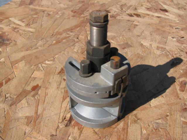

Jake, one thing I found from the book I would not recommend- they mention about using a Ridge Rimmer for the pistons. The Box Wrench and now my builder said not to do that. IF you do it you may have to bore the cylinder bigger than without- means more money to spend. I did that and now wish I would not have- I will let you know how big they have to the bore the psitons. Thought I would let you know, good luck.

The ridge reamer should have no affect on wether the bore needs to be cut. All it does is clean the ridge to what the bore already is. There is no better way to remove the pistons than to remove the ridge first. The rings will not pass a ridge and can break the rings witch in turn can scratch the cylinder. Used properly the ridge reamer just makes the job easier. The cost of cutting the cylinder is just part of a proper build. If you measure your block and the taper is within spec then you don't need to cut it. The taper is the main reason that and out of round. A low mileage block, like one from a motor home might very well be in spec. However it is not common in motors this old. Most will need at least a clean-up of .010. this can be handled with rings but not recomended. The usual cuts are .030, .040, or .060. You really need to measure your block and then you will know just what needs doing. You should be telling your builder what you need not the other way around. I know the books explain how to measure the bores as well as the crank journels.

Fourth, Did your reamer look like the one in the first picture? It should have.
The second picture, is a hone and not used for ridge remoal. The one pictured is for wheel cylinders but one for a motor cylinder looks the same just bigger and has three honing stones.
Last but not the least, the pistons do not get bored they get replaced, the cylinder gets bored. Terminoligy matters if you want to convey the fact that you know what is going on. People have to be on the same page, or problems pop up quick.
