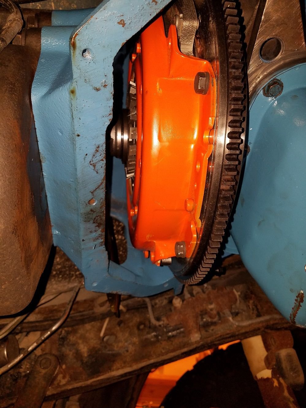

alright heard back from my machinist and he did some poking around and put me on the right track.
sounds like the centerforce clutch is the cause of the shakes, found some similar issues online then called CF they initally claimed the clutch is balanced and that wouldnt happen, then copped to them not being balanced precisely and the weights tend to move and will move to the heavy side if there is one and exacerbate any vibrations already there.
got underneath and pulled the cover... lo and behold the weights were cocked all to one side, poked them around to what was as centered as i could see and fired it up and it spun smoother than ever, a couple revs however shifted them again and the resonance returned.

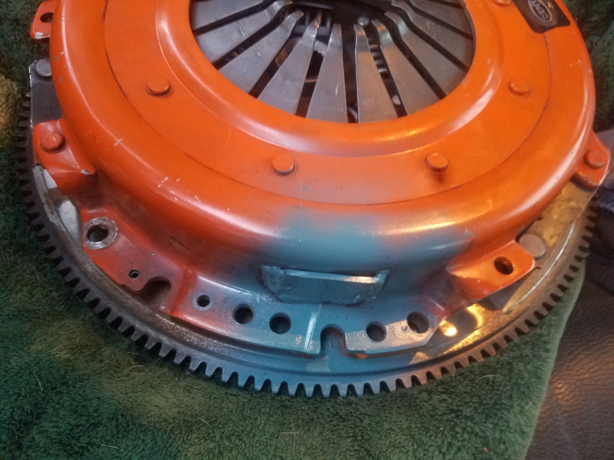

conclusion.
pulled the clutch and flywheel out and cut the weights off. took it to the machine shop and turns out it was pretty far out but due to the pressure plate bolt holes being over bored it let the plate mount non concentrically and created a dynamic 20gram imbalance that moved around each time the plate was reattached
they ended up having to drill and pin the plate with indexing dowels to keep it centered and allow it to be balanced properly. so a lot of frustration on the machine shops part i got the mess back and got it all back in the truck.
got it fired up and the off power resonance is a lot weaker but still present but now there is no vibration at any speed under any amount of power.
so it was definitely a large factor but not the sole cause of the issue. ill snag some new transmission mounts next and beyond that im not sure if i care enough to worry about it since its not rattling everything so bad anymore.
as you can see in the pics the spring wire holding the weights in place is far from a perfect circle so that would be issue #1 for them getting out of center
and then the glob of steel to balance it out after staking it with the pins as close to balanced as it could get.
